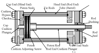

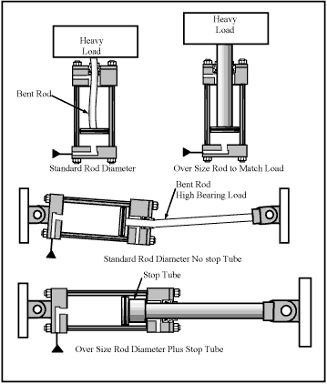

What keeps the lift cylinders from busting the front off? I have never seen a lift arm stop. The last three FEL's that I have owned did not have a bucket stop. The cylinder is weakest as far as bending the rod, when fully extended, maybe the stop allows them to use a cheaper cylinder, with a smaller rod diameter.
A cylinder can have an internal stop collar to make it stronger fully extended, but that shortens the stroke.

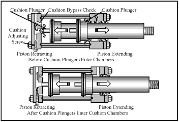

It can also have a internal cushion system.

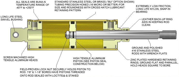

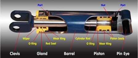

For those wondering why a stop is used remember that the piston of a Hyd. cyl is only held in with a snap ring.
All of the ones I have worked on have a nut on the end of the rod. Like these:
   / Building an FEL quick attach for an L3400 Kubota #36
The 4 that i rebuilt were Kubota and they were snap ring style.
