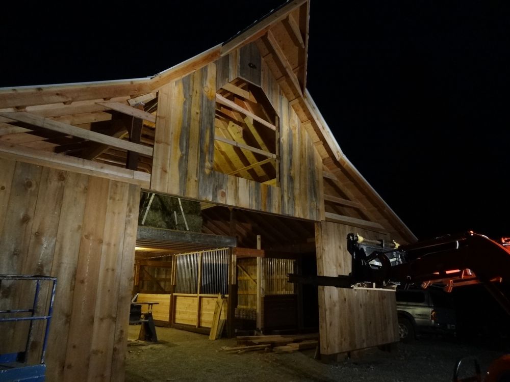

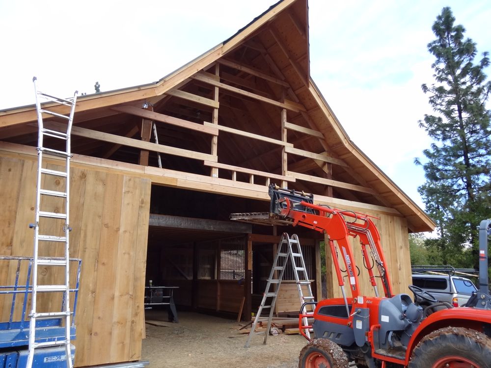

Well, we came back from vacation 1 1/2 weeks ago. It's not quite as fun hobbling around on crutches through Europe. The foot isn't quite healed -- some ligament and tendon injuries which are sore but the bones are healing. At least I'm not using crutches as of a few days ago. We have a barn party/harvest party coming up a week from today so I gotta get this thing done, or at least presentable. (Any of you in our area are welcome to come!) It's going to be an open house for friends from work, Rotary club, church friends, neighbors, etc. Hay rides, bonfire, pumpkin carving, live music, etc. Over the past week, I've been able to get outside a little. Here are some pics:
Stuck a pallet on the forklift and used it as scaffolding. Still had to climb up on the framing to get to the top parts. :O
I'm thinking of building a fold-down door in the center and using it as a platform for a future zip-line!

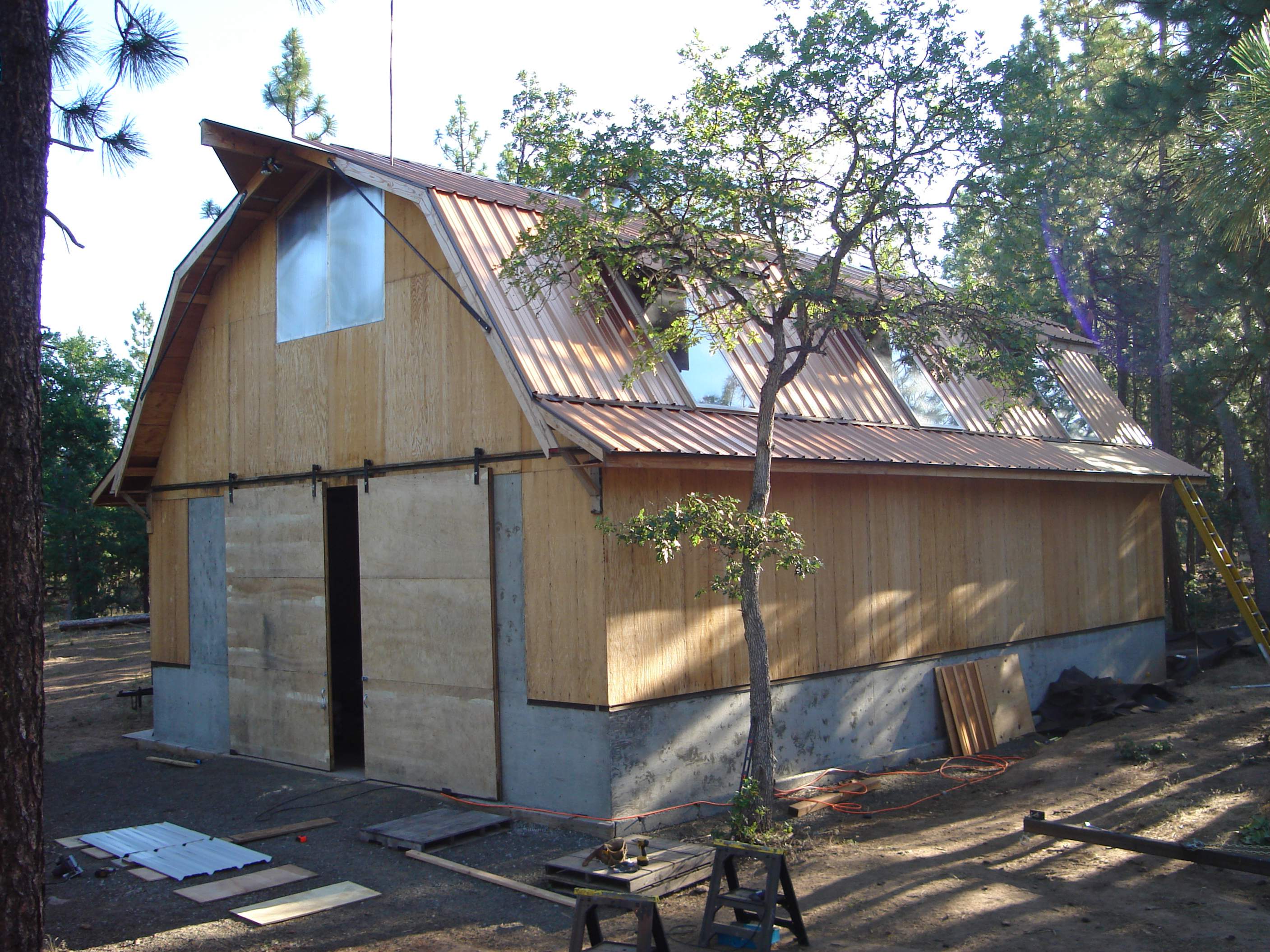

Kudos for sticking to your guns aesteticly. I couldnt imagine putting your heart and soul into a project, and only having a generic metal box to show for it. When I finaly got to build my own barn, I had been dreaming of the old North Dakota barns I explored as a kid. They heavily influenced my aesthetic, even though I had to make many concesions for modern materials and my limited experience.
By the way, this is how I handled the prow. But I had a ridge beam.

Nice looking barn Marcus, For a future project how about a pond at the end of the zip line

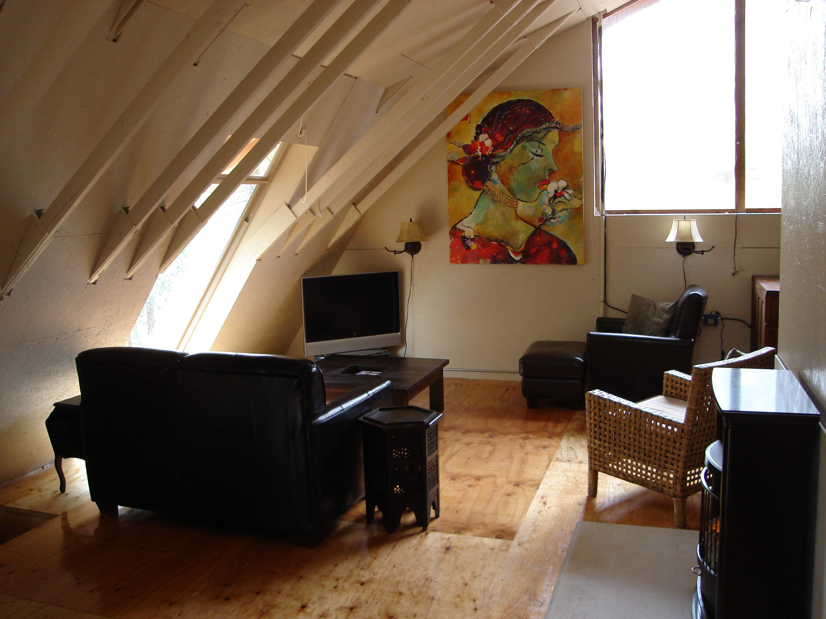

59 Sons Do you have living space in you loft, how about more pics
   / Building an "old fashioned appearance" new barn #129
I have a temporary studio that will be my wifes craft studio and office after we build a cottage. No utilities, just roughing it for now, but its warm and dry so it takes the pressure to build off. I gave up credit, so I have to wait for each paycheck to do a little more. 3-19-12 003.jpg Most of the loft is carpentry shop.

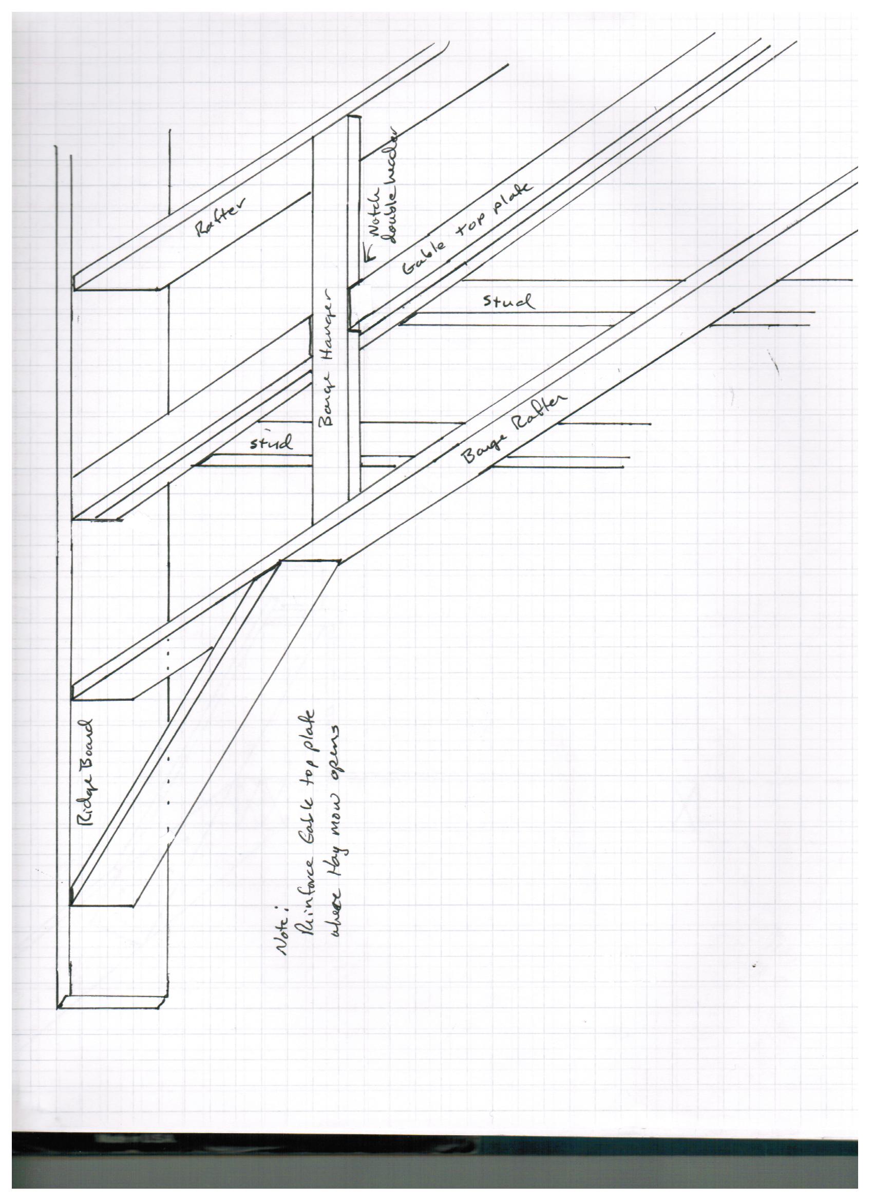

59sons, thanks for posting and thanks for the pics. Did you make your own trusses? Do you have center supporting wall? Does the ridge beam go the entire length or just a few rafters in to help support the widows-peak? Great job on your barn! Couldn't agree with you more regarding the generic metal box comment.
