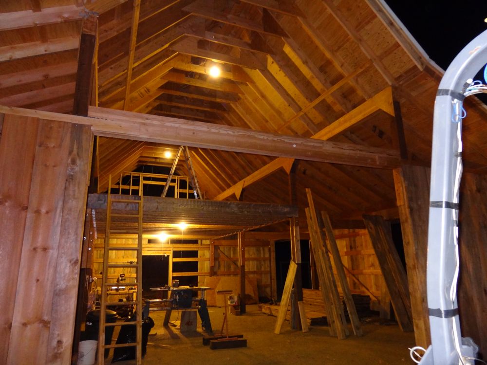

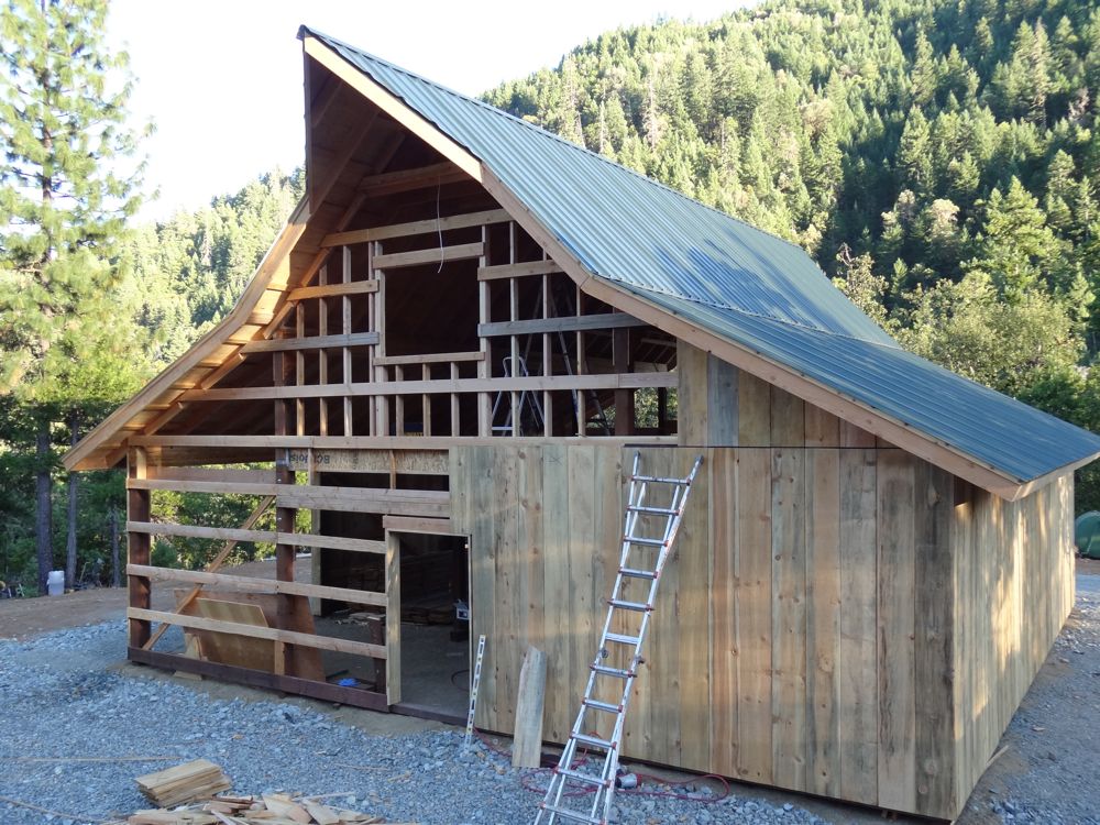

Well, I had the last 2 days off work and didn't get nearly enough done on the barn, mainly because this afternoon I fell off the ladder. Sounds worse than it is, but I did sprain my ankle. Actually, I was jumping off backward from about 5 ft up because I was starting to lose my balance while coming down with some tools. My left foot hit the last rung of the ladder and it got twisted. Now I'm hobbling around. Hope it gets better in the next few days. My sister coming up to visit from Southern Calif. and I don't want to be an invalid.
So here's what I did complete in the past 2 days:
Framing for the wall/window in the loft (there's going to be a 12 x 16 room up there for hobby stuff -- about 1/2 of the loft space).
Blocking and girts completed on north wall.
Some electrical -- notice how I have 4 lights installed -- temporarily wired into the breaker panel.
About 1/3 of siding on north wall -- did some after dark so not included on the pics.
Marcus

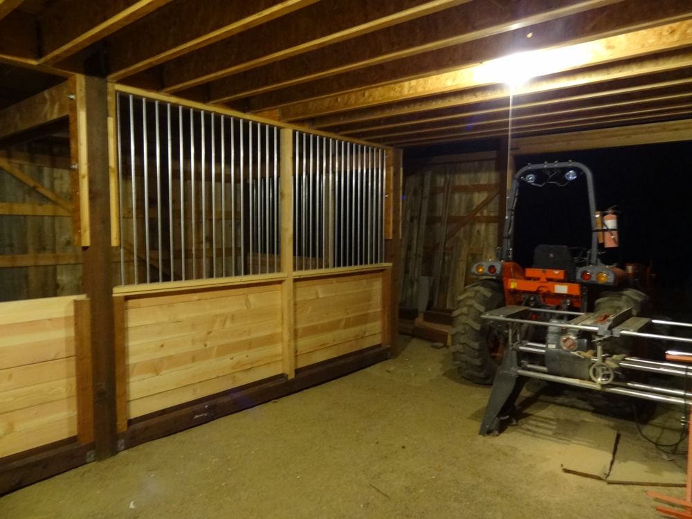

Next update: With my sprained ankle, I can't get up on ladders for a little while. That put upper level siding on hold. So yesterday I started building stalls and worked on electrical again.

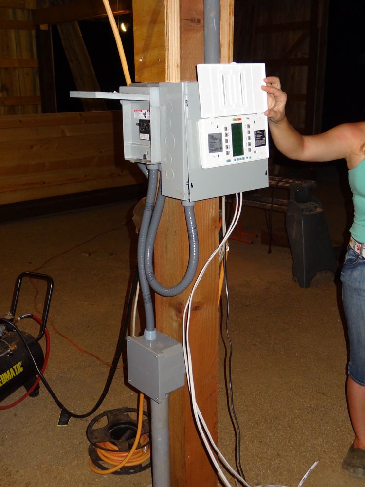

I completely redid the breaker box and brought it a little higher, all the wiring is in conduit to 8' high to pass code, and the whole barn is on the Verve wireless electrical system like the house. Yes, I know it's a waste of money for in the barn, but I have an extra 10 channel controller and some wireless switches left over from building the house and it's too late to send them back to the company now. Besides, if I have any future failures of any of the house components, I can just cannibalize from the barn and put normal switches in the barn.

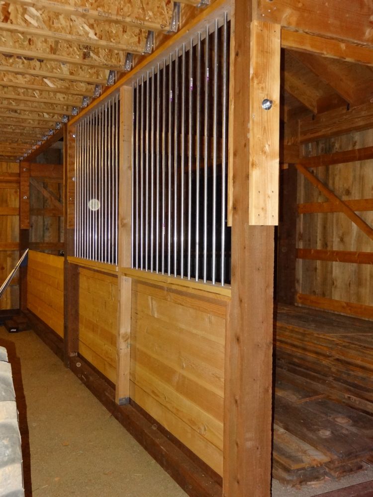

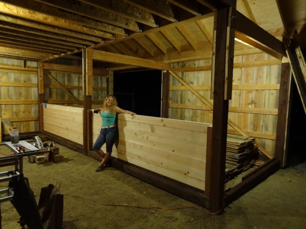

For the stalls, I wanted the interior walls flush so the goats can't climb them, and they can't chew on the wood. I just started with 4x6 PT (treated) cross members at the floor level, 1.5" in from flush with the post. Then, there are 4x4 PT posts attached to the main barn posts with timberlok screws. Then, I just nailed on horizontal 2x6's to form a wall 4' high. It will be capped with a flat 2x6. Above that, I'll use EMT conduit for bars every 4". Since 12' is a long span for those horizonal boards (the wall bends easily), there will be a 4x4 post extending to the ceiling at the 6' center mark.

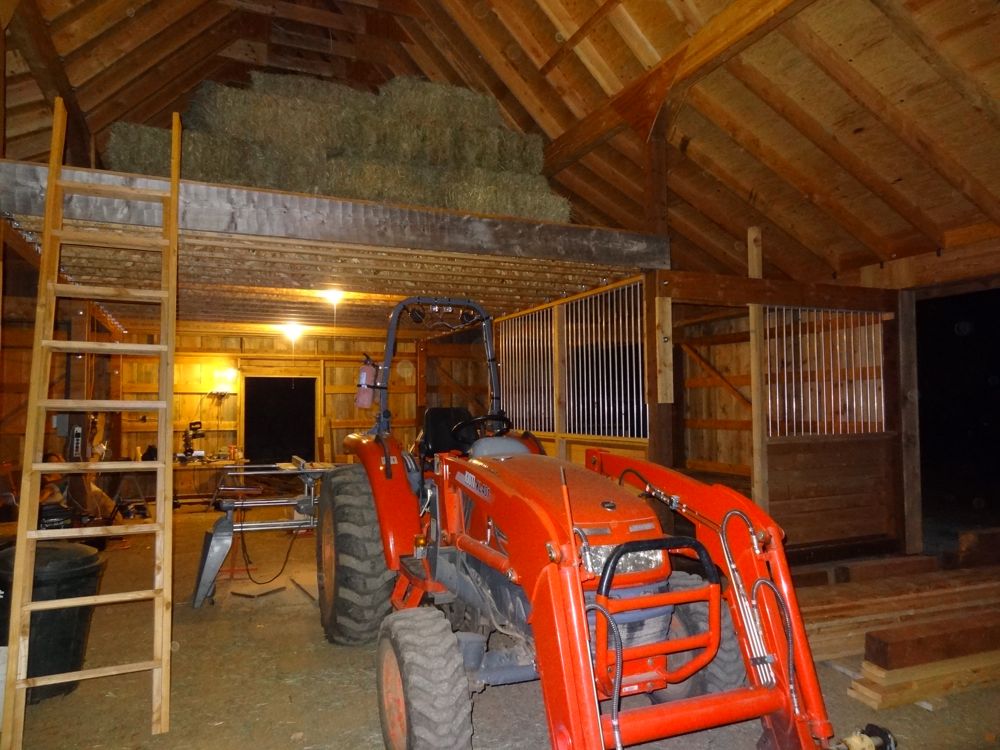

Thanks, toddol1971 and others who commented. A friend came out and delivered 48 bales of hay on Friday. As he and his farmhand were stacking hay in the loft they commented on how they thought it was overbuilt, too. Better to be overbuilt than to come crashing down on someone!
Update: Today I got some x-rays taken of my foot and what I thought was just a bad sprain was actually a couple fractures in my ankle. Of course, I've been walking on it for 2 weeks, and still working on the barn.
Here are few pictures from last night. Notice my Kioti DK45 fits pretty good, even with the Shopsmith table saw in the way. Has anyone else here ever used EMT conduit for stall bars before?
   / Building an "old fashioned appearance" new barn #119
Has anyone else here ever used EMT conduit for stall bars before?]
Yep!
Built a horse barn 20 years and purchased sliding door hardware kits. They had EMT bars for the door top so I purchased more EMT to use on the side walls above the T&G 2 x 8's. Starts about 5 ft. off the floor. Cut the 10' EMT in 3rd's. Cut some ruff oak and bored spaced holes for top and bottom to hold the EMT. It has held up very well.
