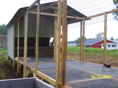

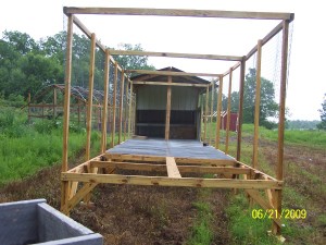

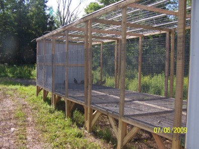

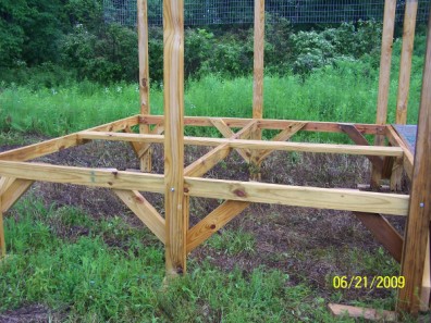

Well here are a few pics of my new chukar and quail pen. It is based on 8ft 2 X4.
1) Design something easy to build.
Materials used all wood PT For 8 x8 section pens
6@ 20 ス inch 2 X 4
12@ 24 inche 45 % ends
10@ 8 X 2 X 4
1@ 8 X 2 X 6
aaaframea.jpg is a picture of the frame.
The floor of the pen is 2 feet off the ground. It is 8 foot high, 8 foot wide, 8 foot long. We built the pens modular style, by my barn to make it easy for electric and air compressor.
2) how do I move it once it is built?
I bought scheduled 80 pipe 6 inches to go over my tractor folks to move everything with. I have included the measurements. Once we had design it took two hours to build each section. We have built 5 sections. We wired the bottom of the pens with 1 ス wire as chukars and quail have small feet and it helps keeping anything from getting the pen.

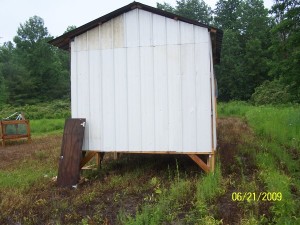

I order 2 inch netting for the top and will use some metal pipe I have maybe to keep netting tight I have made up my mind yet about that. We have tinned two parts to give the birds cover and a catch area.
One part is completed isolated so I can have two different age groups of birds. In the big pen. I will tin the very end to provide a wind break. To help the wind from hitting the birds so hard, also we may tin part way up. But I will decide that later. But here is what we have done so far.
6) how to tie everything together

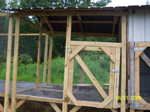

Once pens were built we moved them but placed wire on bottom first to keep from racking too much. The next step was to level pens, and lagged together. As you can see from photos we started to wire pen in but ran out one long piece. Will get more detailed photos of supports once it drys out and also after we install dead men on the walk way.
Door does not appear to straight as we still have finished racking everything and also we
Plan tinning this part. But this is what we have done so far. Will post more when wire is in.

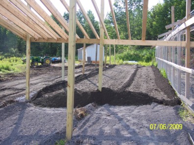

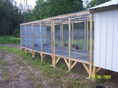

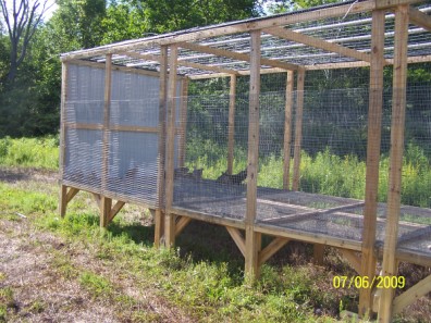

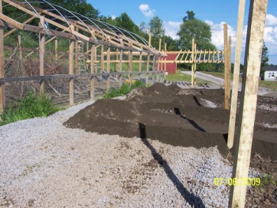

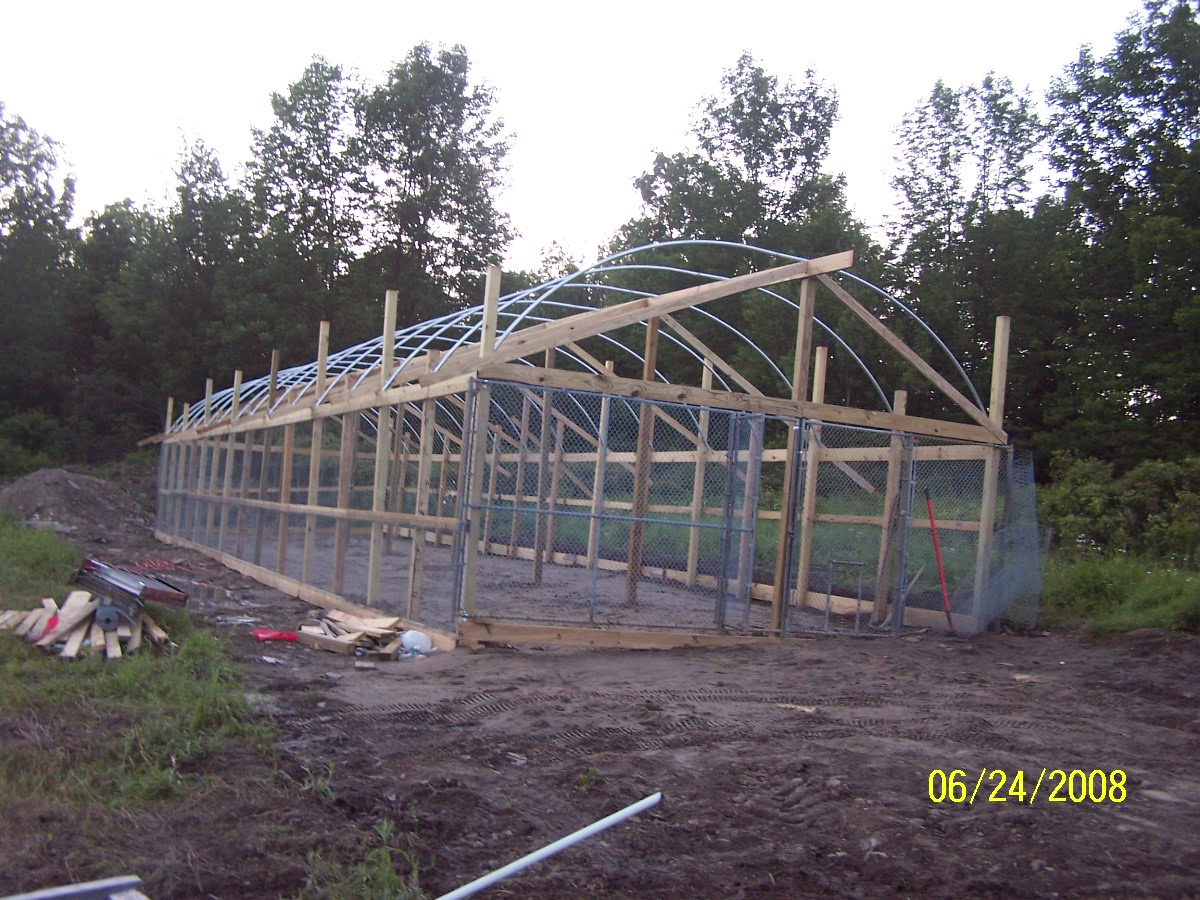

Hi guys,
The first three are the newly finshed pen with BIRDS.
Here are some finished pictures of my last pen it has pheasants, chukars,
and some of road island red chickens everybody running around together.
The next 6 pic are new pen and partly built

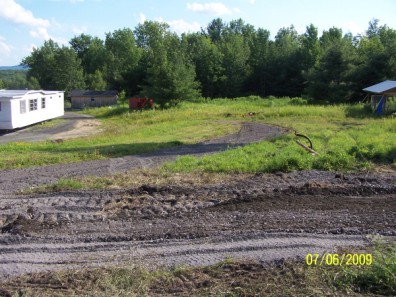

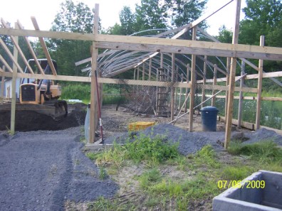

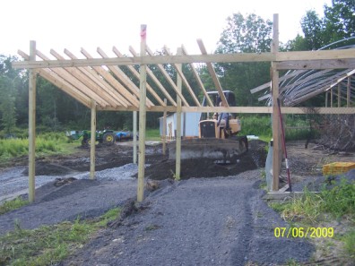

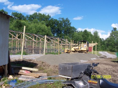

The next couple of pictures is the newest pen and modifiying the one I built last year. I found out I need to cover their food and also have a better catch area when hunters comes and I am tired of being in the mud. So This time I laid down about 18 ton of number 2 followed by stone dust. the next 6 pictures is us spreading the stone dust.
The next two pictures

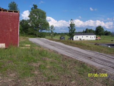

Just to get to the birds pens we had to dump about 36 tons of crusher run which nevers goes very far. But it did not completely finish my road back to my bird pens. But almost.

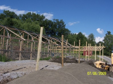

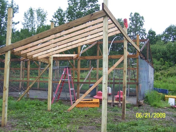

The next picture was the pen whcihc I completed last year and the new one is right beside it. And the next pictures is what we are adding one. I plan on having a tin shed there for catch area and to protect food it will be 8 X 16 for each pen so it will be 8 X 32 total.
As we finish framing I will add more pictures. When I am done I will have a chukar pen 8 by 40 feet long. and two pheasant pens 70 feet long by 16 feet wide and sheds attached to the pen 8 by 32 feet. Also some one gave me a shed which is 10 X 10 and I will use that to store my food. Last year I had a pond dug up pheasant pen and I just bought two 250 gallon water tanks I will use my trash pump to pump water in the holding tank and nipple waters for all the three pens water. NO MORE WATERS YES
