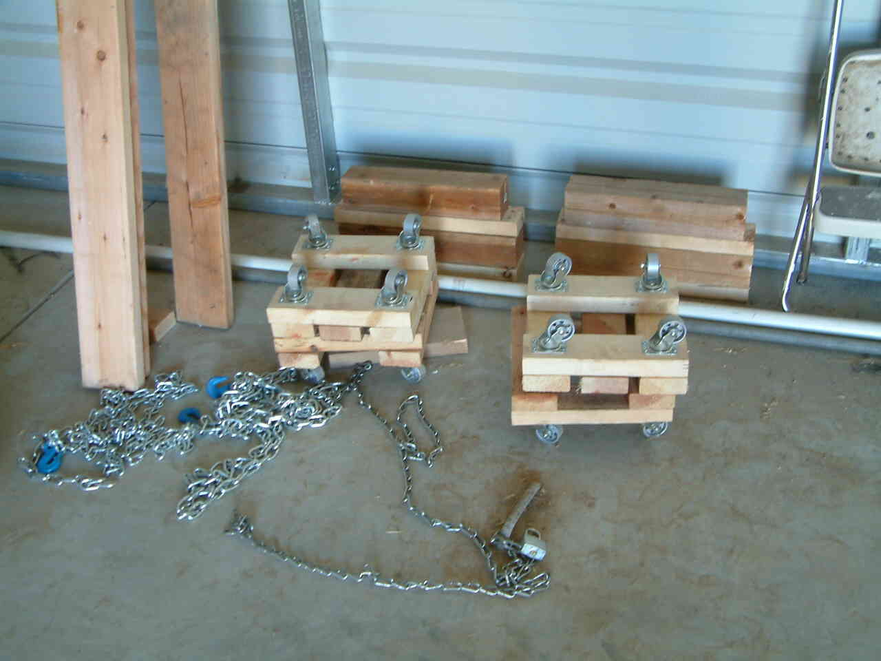

Here are the dollies I use for my KK 4-ft box blade that weighs about 250 lb.
The metal swivel casters are from HD ($4 each).

Here's the dolly for the front end of my KK 4-ft rotary mower.

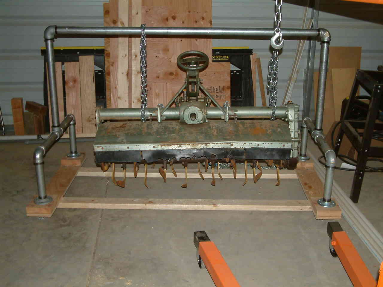

And here's the gantry-type dolly I use for one of my more awkward implements, the pre-owned Yanmar RS1200 rototiller (48" wide). There's about $120 worth of pipe fittings in this one making it by far my most expensive dolly.

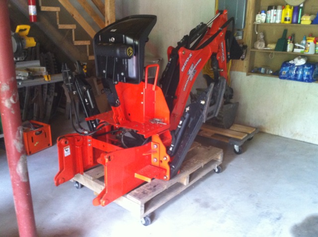

Here's how my pallet dollies work.
