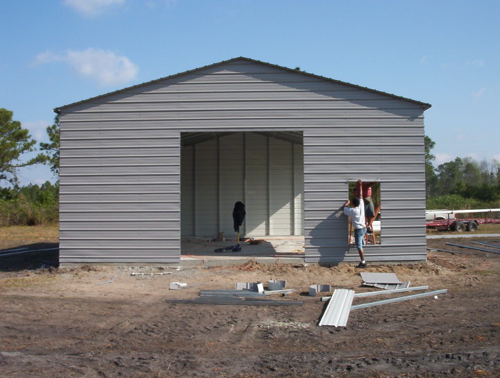

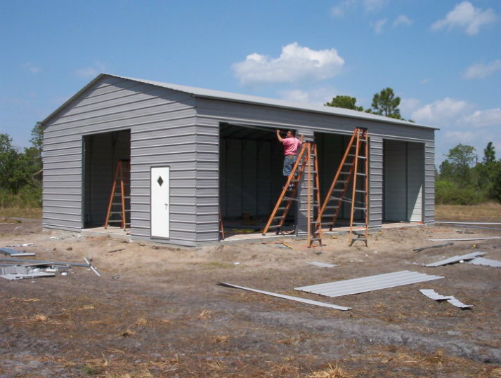

Day 2 begins on south wall, cut out the walk through door......

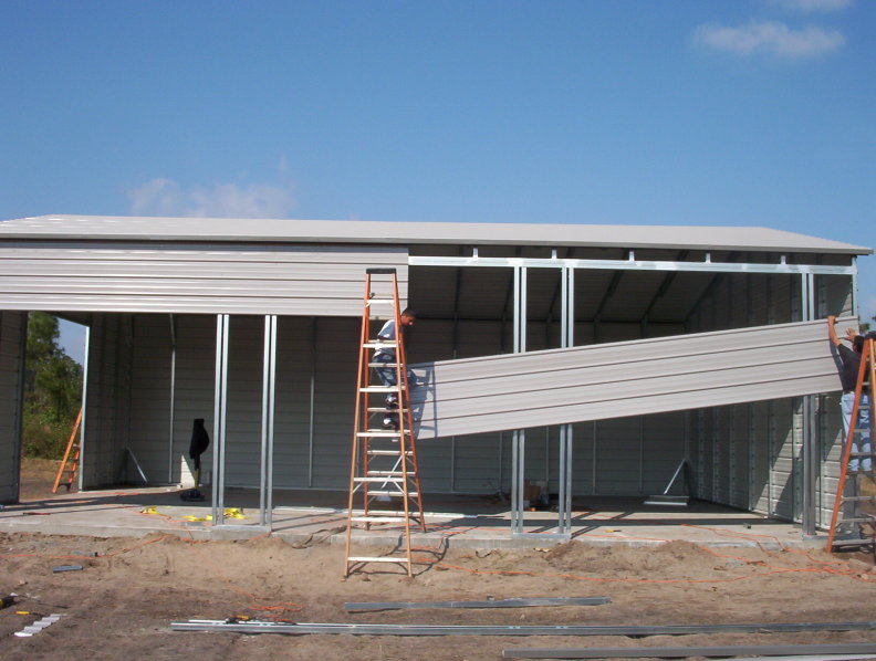

Place medal siding above garage door side.........

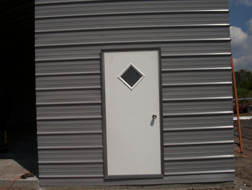

Place trim around garage door sides and top........

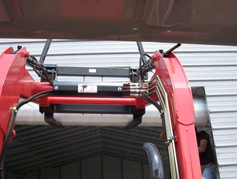

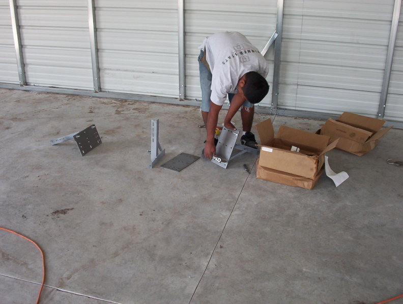

Next put together backets that hold roll up doors in place on building........

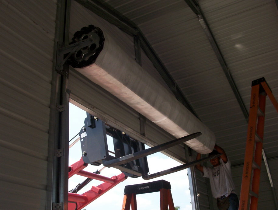

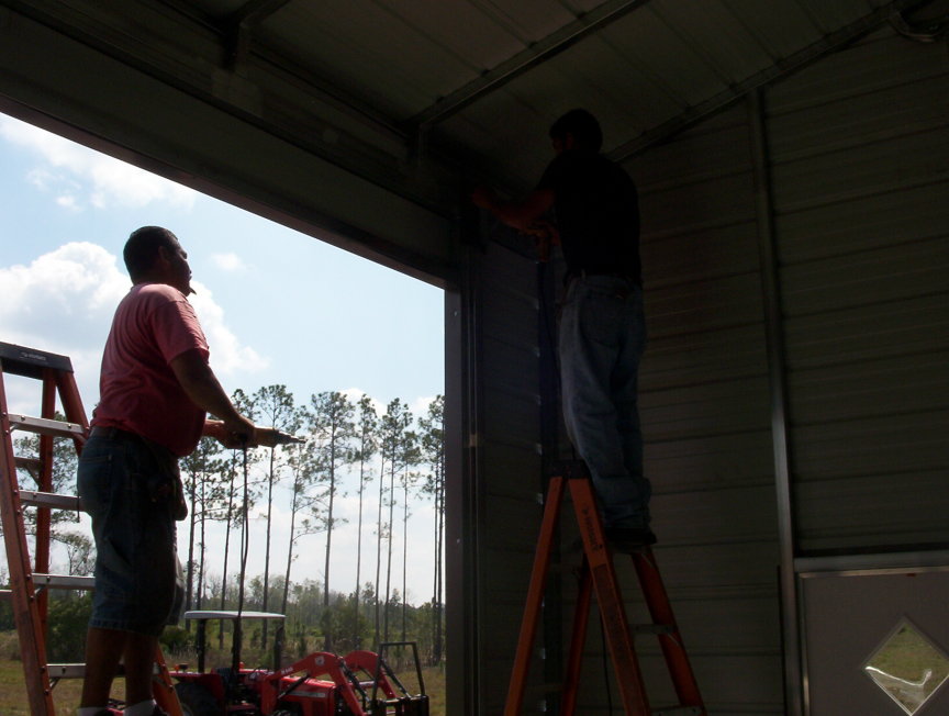

Use tractor forks to lift roll up door in place for mounting......picture from out side

Another picture of door being put in place from the inside.........

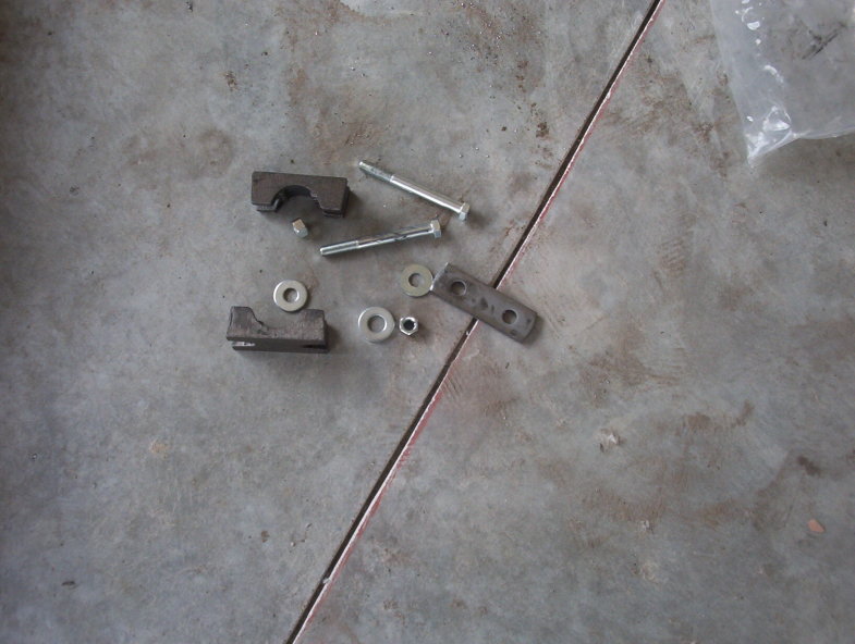

Picture of the door bolts & backet that holds the door to the mounting bracket on the building........
