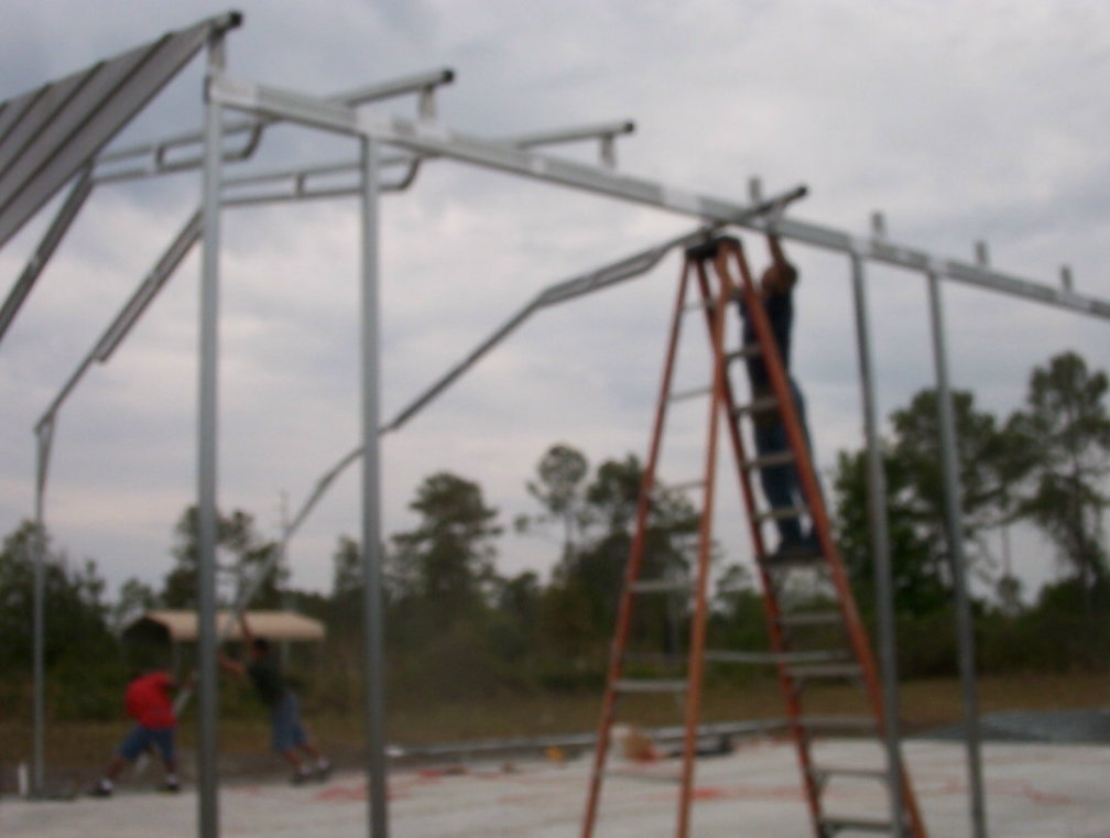

Then we placed all the remaining trusses in place one after the other, first placing the high boot on the garage door side and then the opposite lower side boot.

Now bolt all trusses and their boots togther for solid hold....

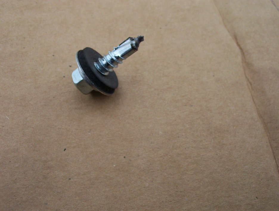

This is a picture of the bolt we used to bolt all the medal together.......

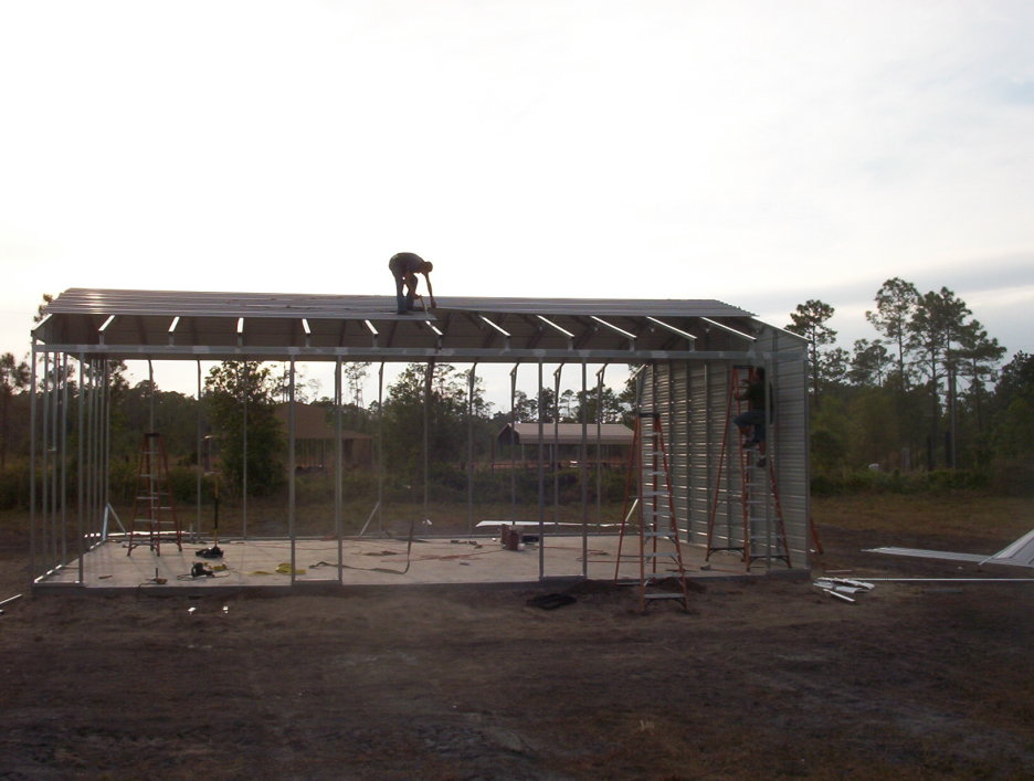

With all bolts in the trusses and in base rails we start putting up the medal siding on ends and roof..........

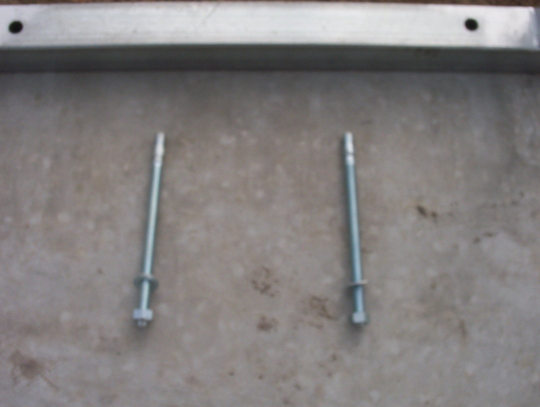

Oh, heres a picture of the concrete anchor bolts that hold the base rails in place..........

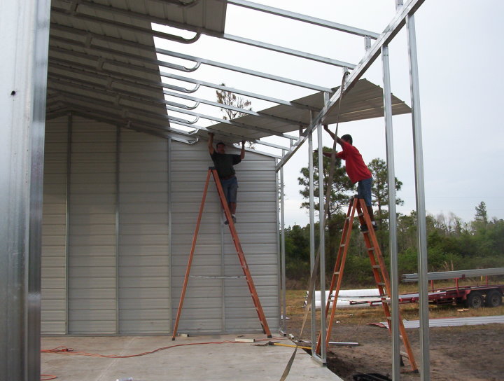

Another shot of medal roof being installed........

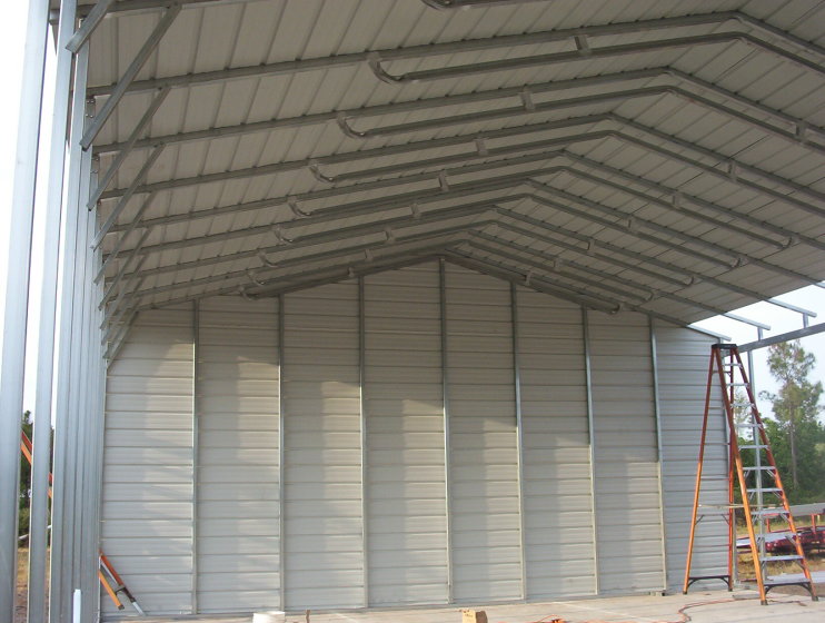

Re: Building Garage 30\'x40\'x15\'
Inside picture of north wall and ceiling........

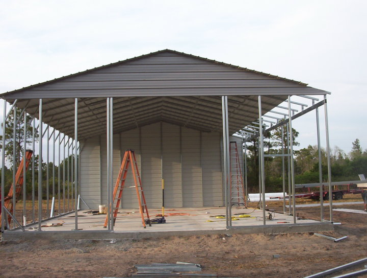

Now picture of south wall where 10x10 roll up garage door and 3' walk through door will be going.....

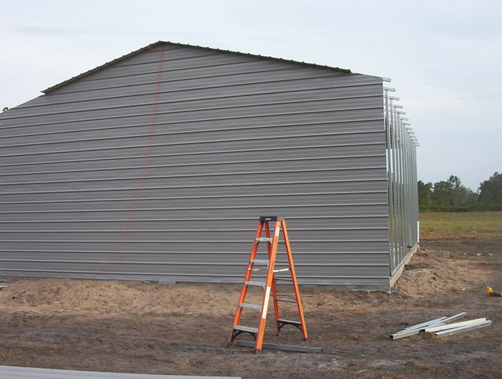

#50
Medal siding goes up on west side solid wall........ Also this is where we stop work on day one.........
