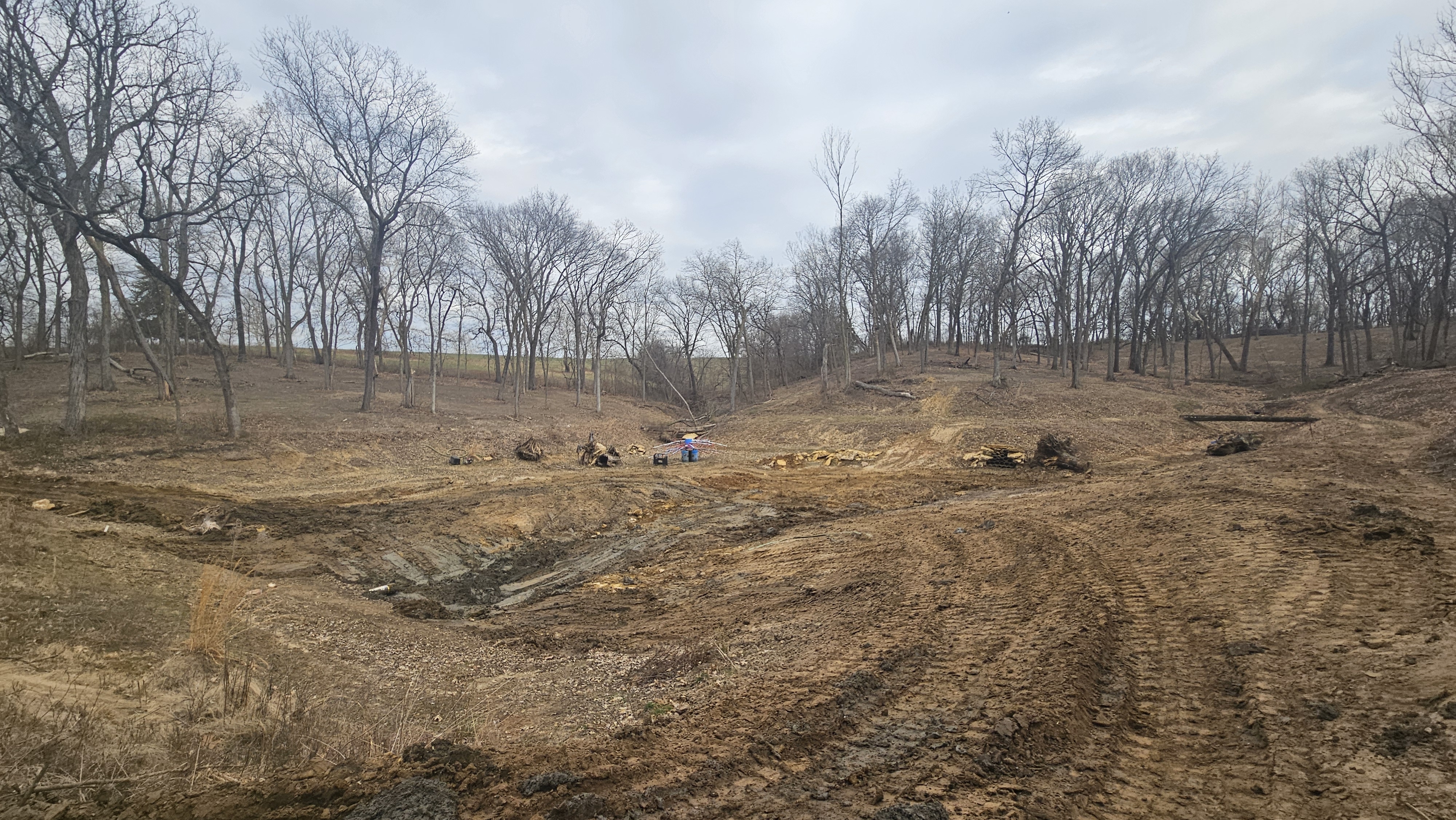

Started mucking out the pond today before the rain started this afternoon. I may have found my problem, or at least one of them. While mucking I hit rock in the shallower flat area away from the dam so started digging a bit and found a pretty good size area of rock and sandy soil just under the clay. Its roughly a 25x40 area and there is very little clay cover. This could be the reason it's only filling so full. I think it's possible increased pressure as the pond fills may be accelerating the loss. I've going to have to dig as much of this area out as I can, will then probably cover in bentonite, then repack with good clay before doing another bentonite treatment along with the rest of the pond. This area would have been the bottom of the ravine before I started work.

Glad you found that gremlin. Can't believe you didn't find it when digging the basin.
I started to see a few signs of rock and stopped digging. Didnt realize how widespread it was and how close to the surface until today mucking it out.
   / Building Lake Corona #1,196
I'd dig it all out or seal it good with 6-12 inches of red clay.

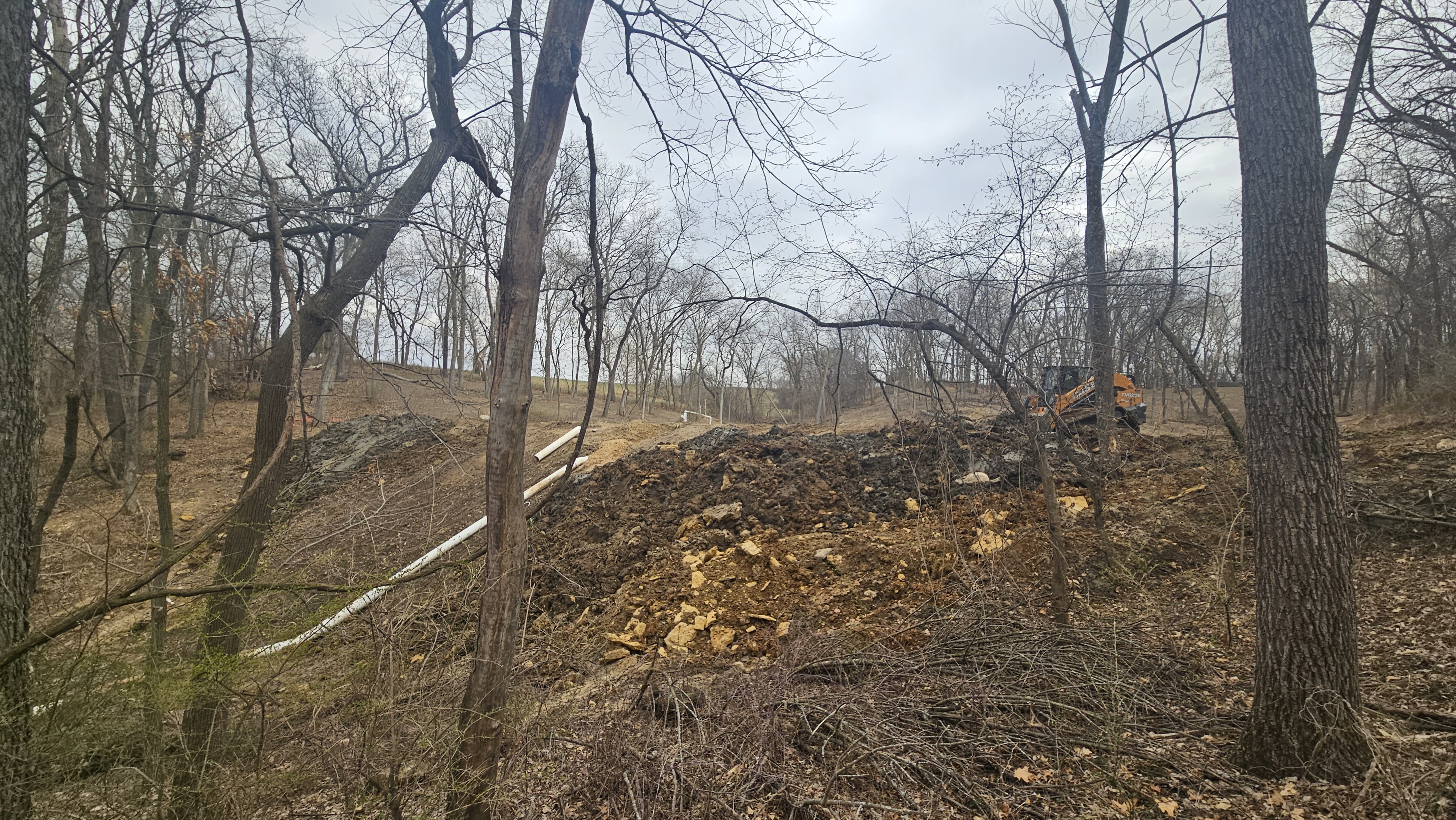

Started round 2. Winter is finally behind us here I think and ground is drying out fairly fast now. Spent some time yesterday morning and then a lot of today and got the soil mucked out. I've dug down to solid ledge and removed a ton of sandy soil and rock. All of the spoils have been taken to the back side of the dam. I'll grade it out after it dries.

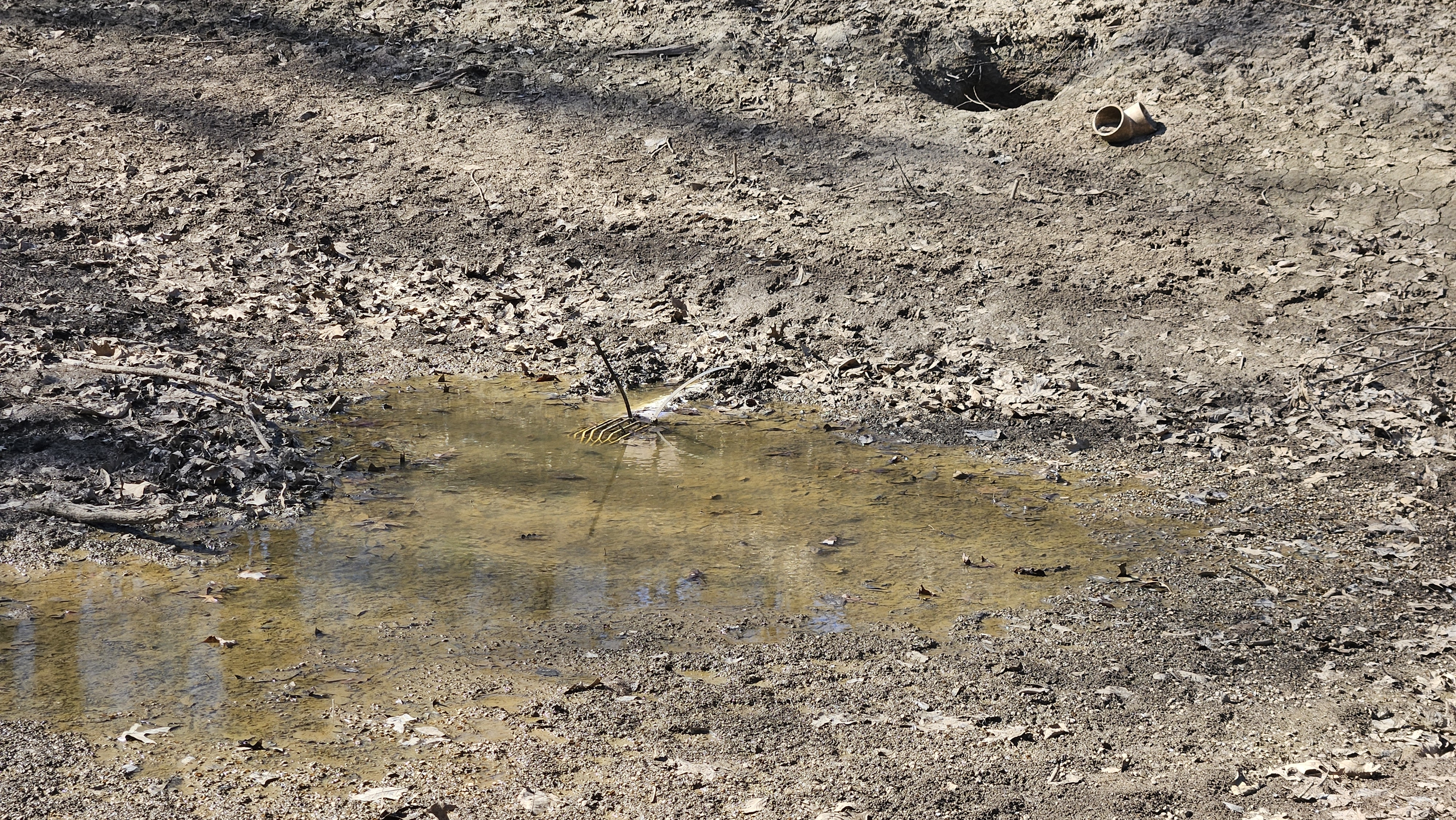

Last fall when I siphoned the water out water was pulling from a hole in the dam. I assumed the end of the tube was under silt. Today in mucking out the pond I found the end of the drain lower and almost silted over which means I have a break in the pipe that will need fixed. Probably same problem I had on the backside in not keeping pressure long enough while the glue set.

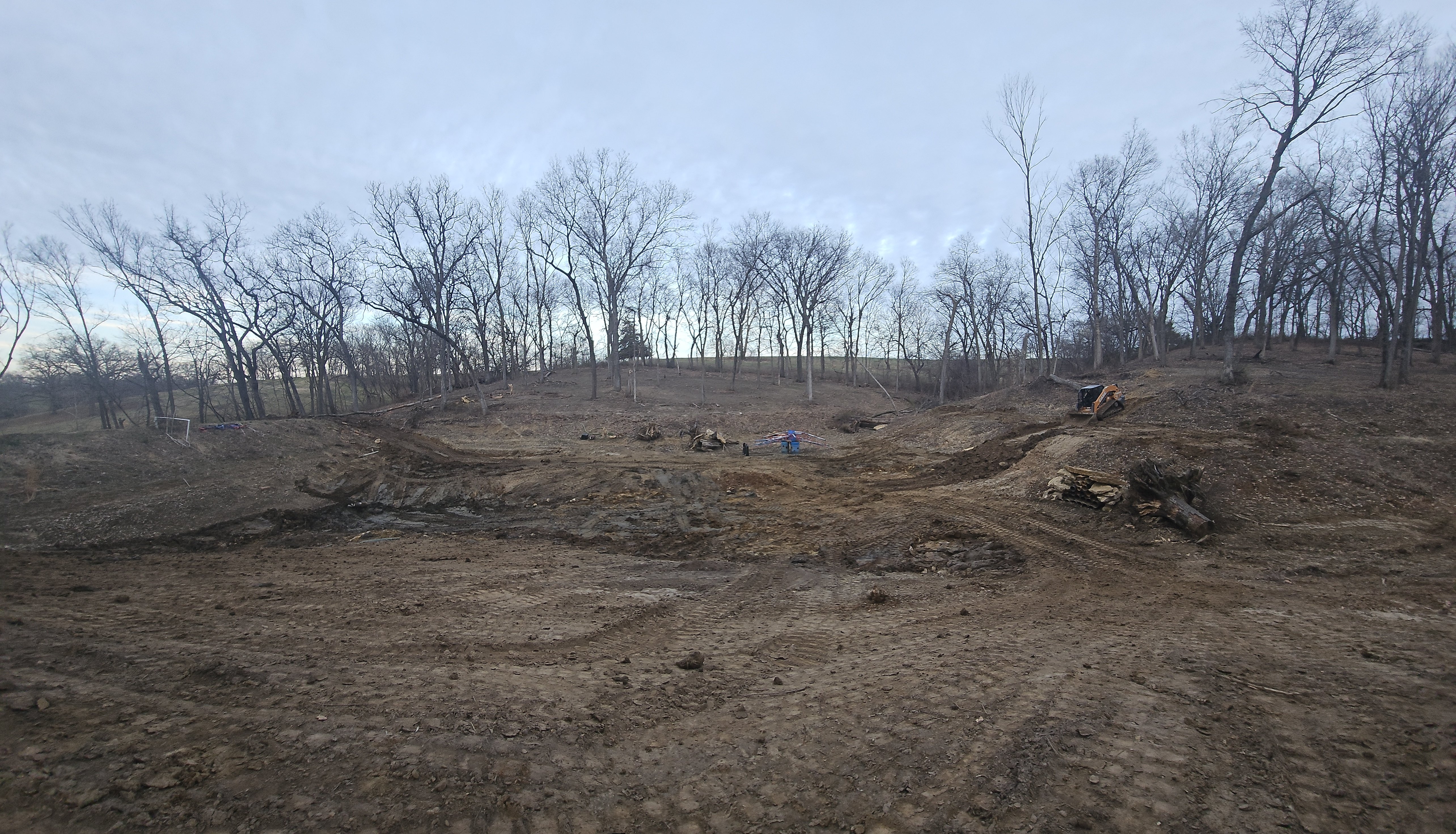

After most of the muck out. The entire center area of the pond is solid limestone now. Will start next covering everything in about 12" of clay.
I'm planning to bring the clay from the hillside where my loader is sitting in this pic. Most of the topsoil is already stripped so just a matter of pushing downhill, spreading, and compacting. Will cover first, compact, spread and till in bentonite, then compact one final time. Hoping to spend a couple of hours tomorrow pushing dirt. I traded in my Case TV450B last month for the bigger TV620B and this machine can move a lot of dirt for a CTL. I should be able to make pretty quick work of getting the clay moved.
