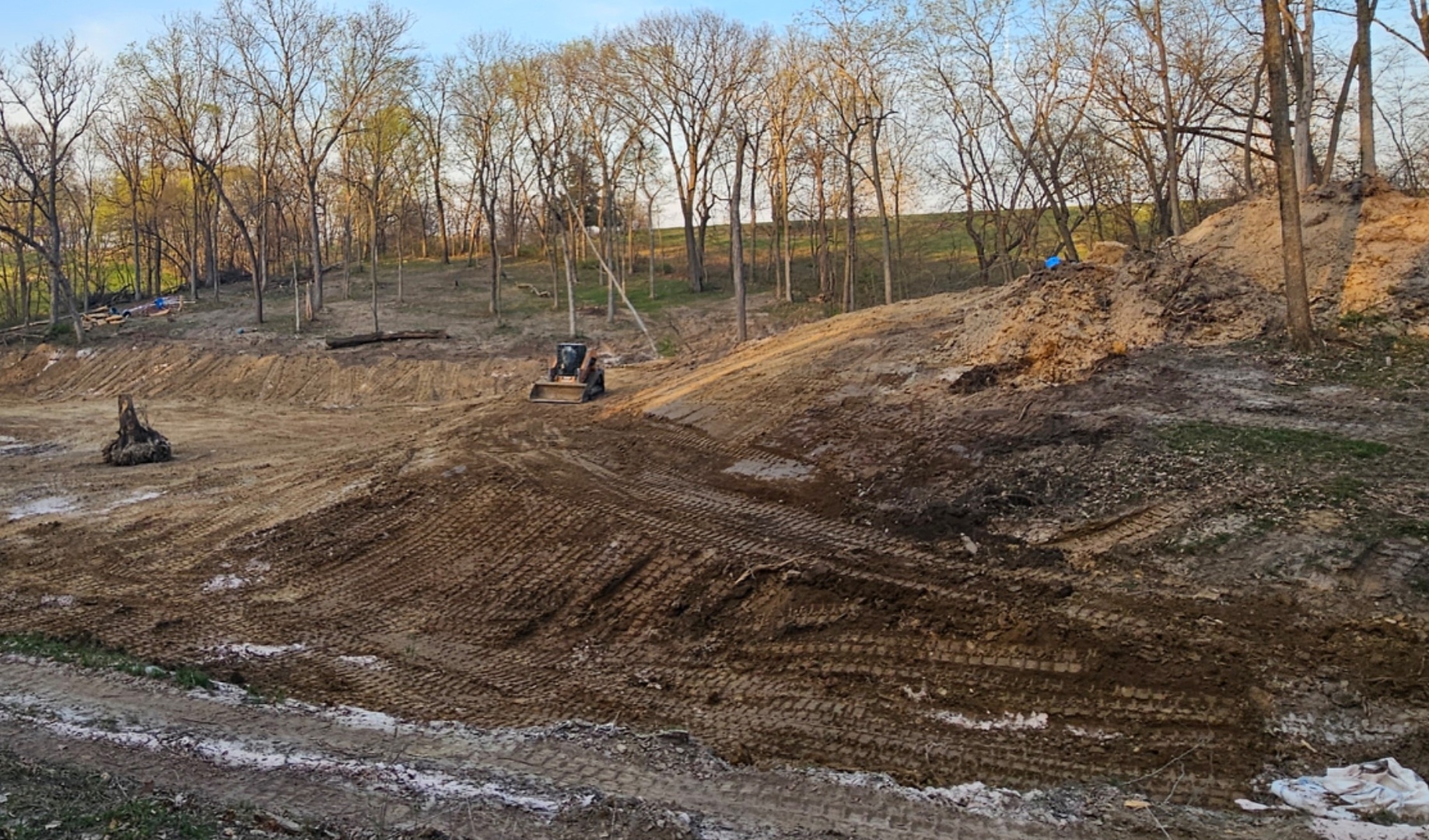

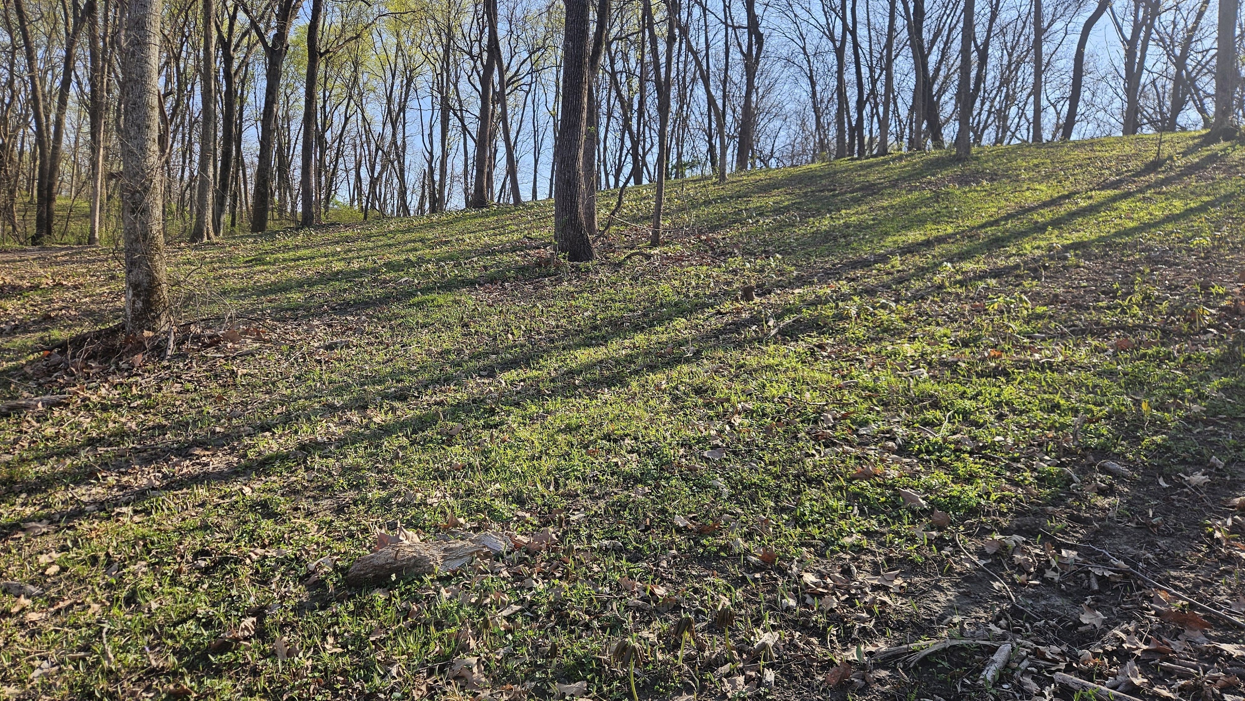

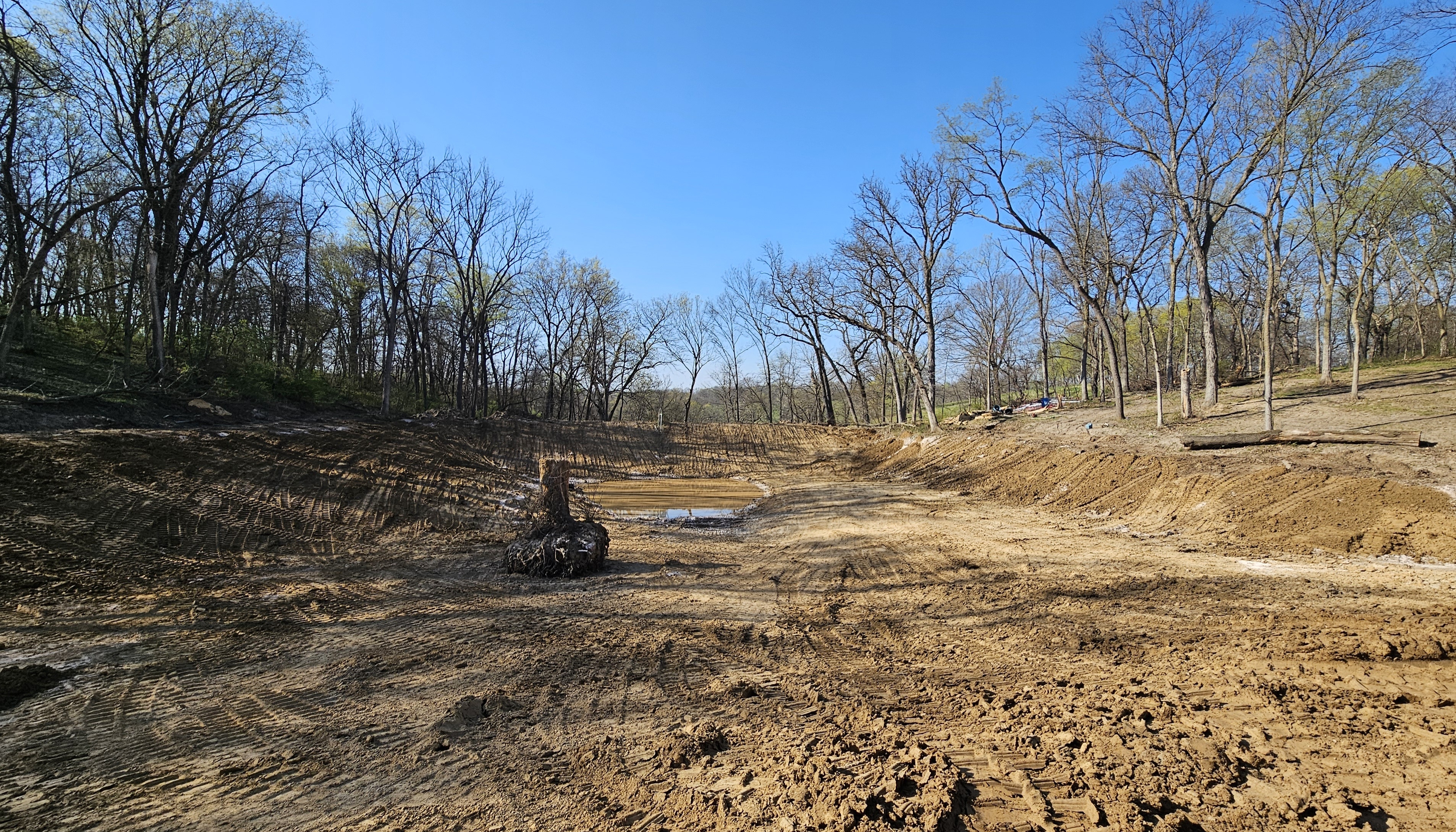

Wrapped up moving dirt today. Just need to compact and move some of the fish structure back in. The timber around the pond I cleared last fall is getting some good growth and greening up now that sunlight is hitting the ground so I'm not too concerned with erosion. I'll post some final pics next week, get a yard stick in to measure water loss, and hope for rain.

Just finished reworking it so dry at the moment. I understand the concern. I don't think there is anywhere that your going to be stuck should you fall in. May be on hands and knees in one spot but not going to be stuck with no way to exit.

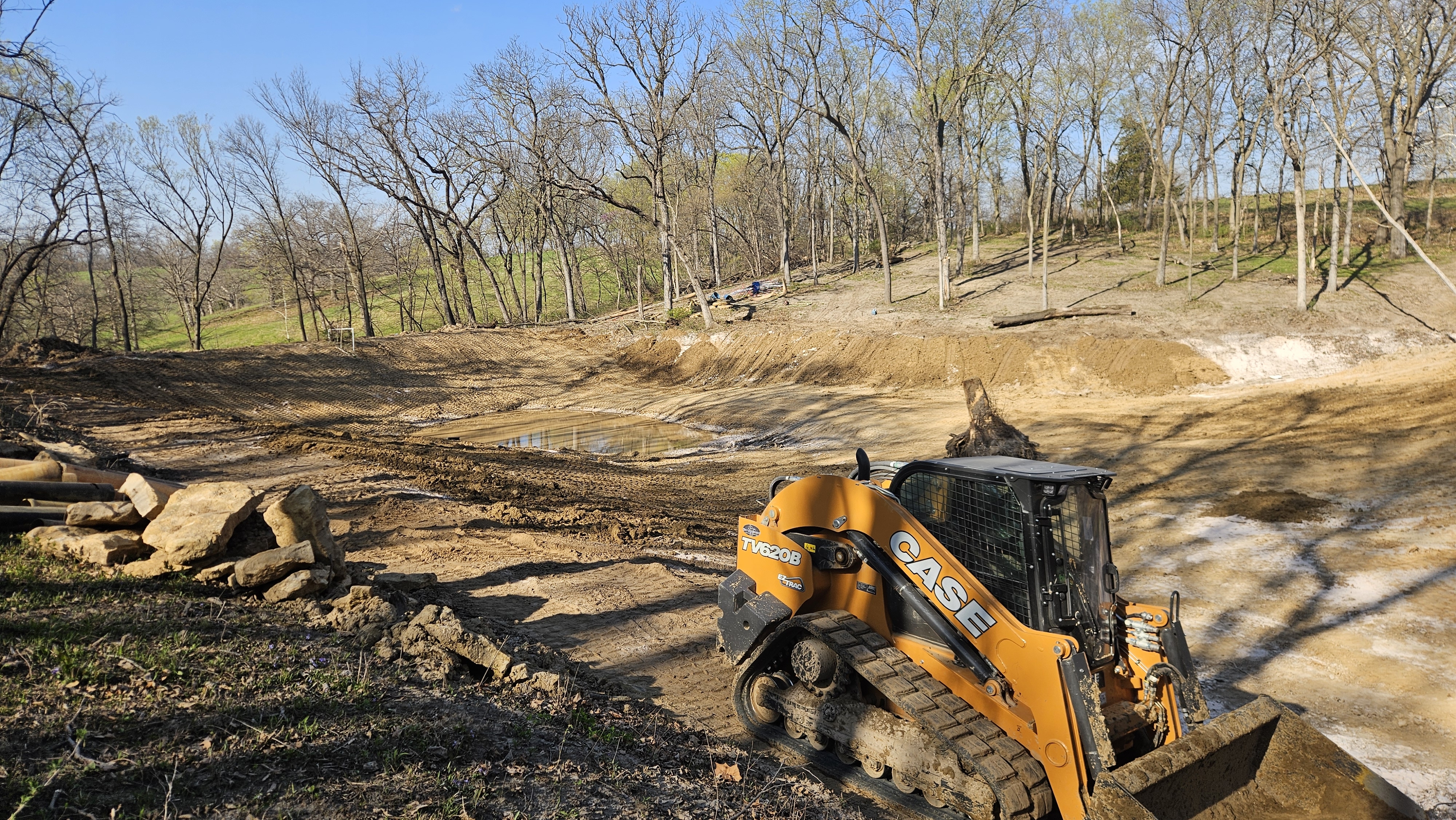

#1,278
The hillside where my loader is sitting is where I've pulled the clay from. I need to use my top soil piled up top to cover this hill and the walk path I cut in so I can get some grass to grow and control erosion. Any suggestions on how much to add. 6", 12"? Should the clay be scarified before adding topsoil to help keep it from sliding? It is pretty smooth at the moment from cutting with the bucket.
