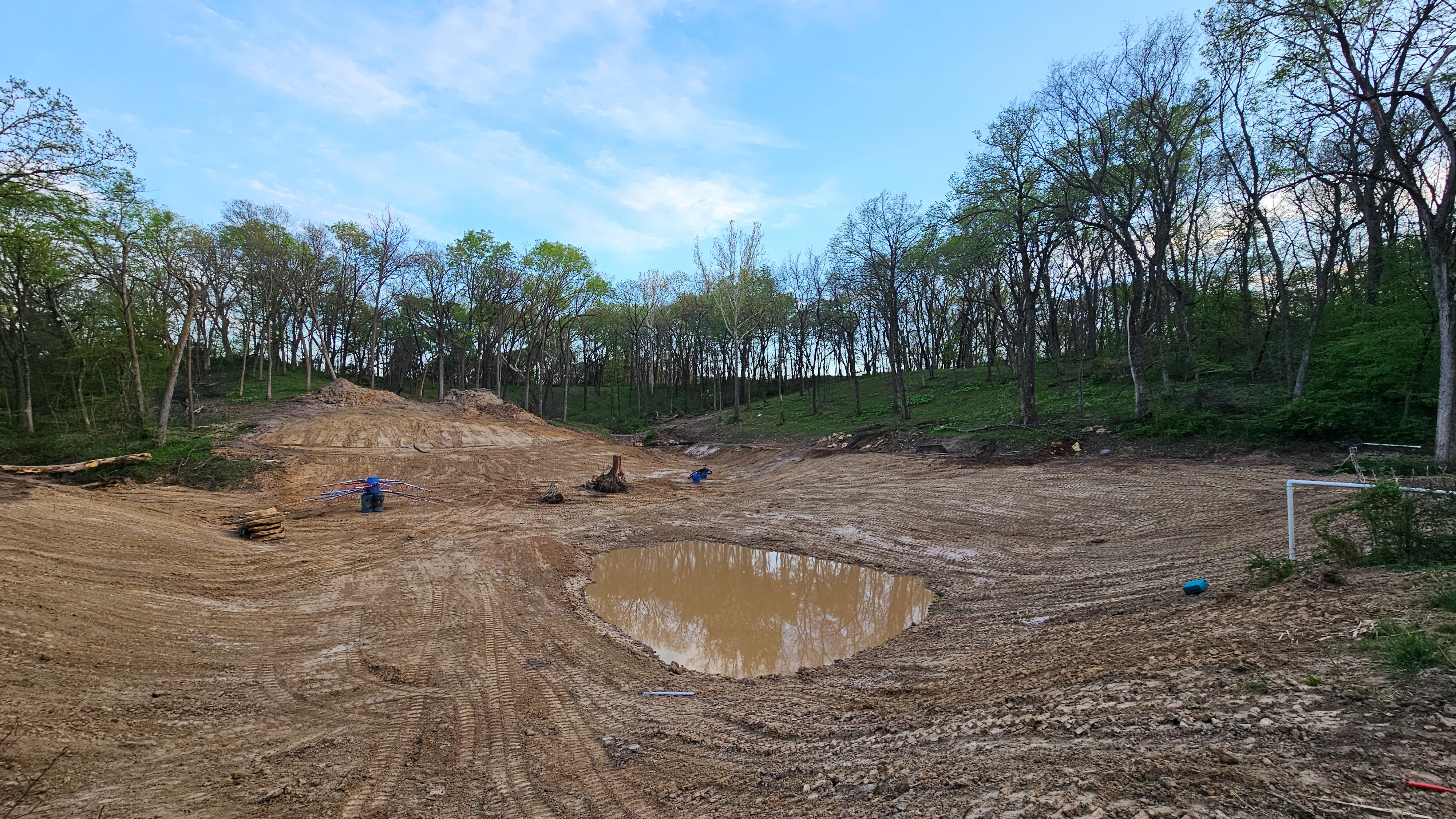

Are we retaining water???
(Which is one of the few situations where it's desirable!)
So far yes but not gaining any. First rain today since that small amount April 2nd. We missed any heavy rain. Maybe 1/4". I need to get a yard stick in to start watching it. Going to move some structure in for fish this week before the bottom gets covered.

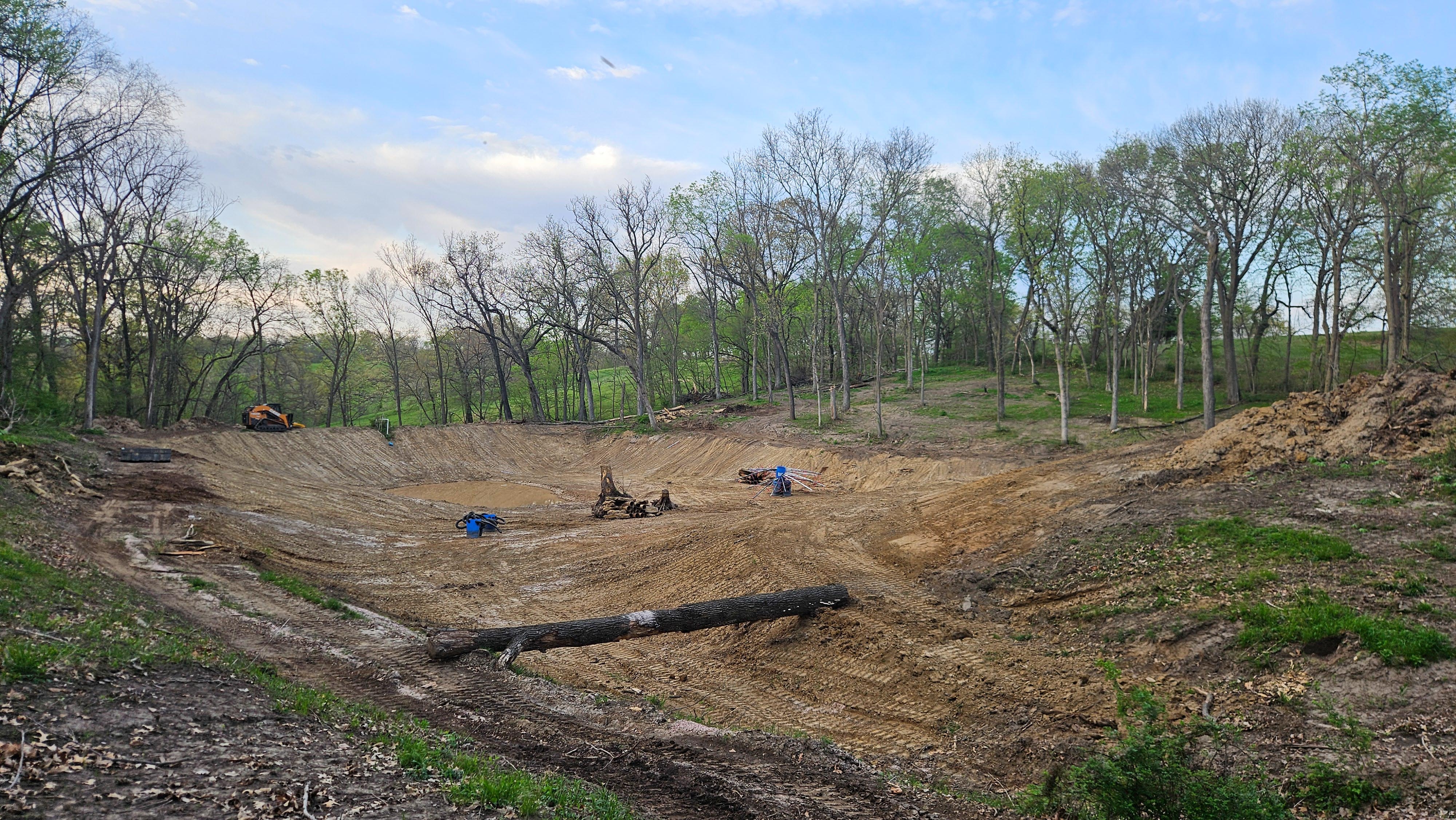

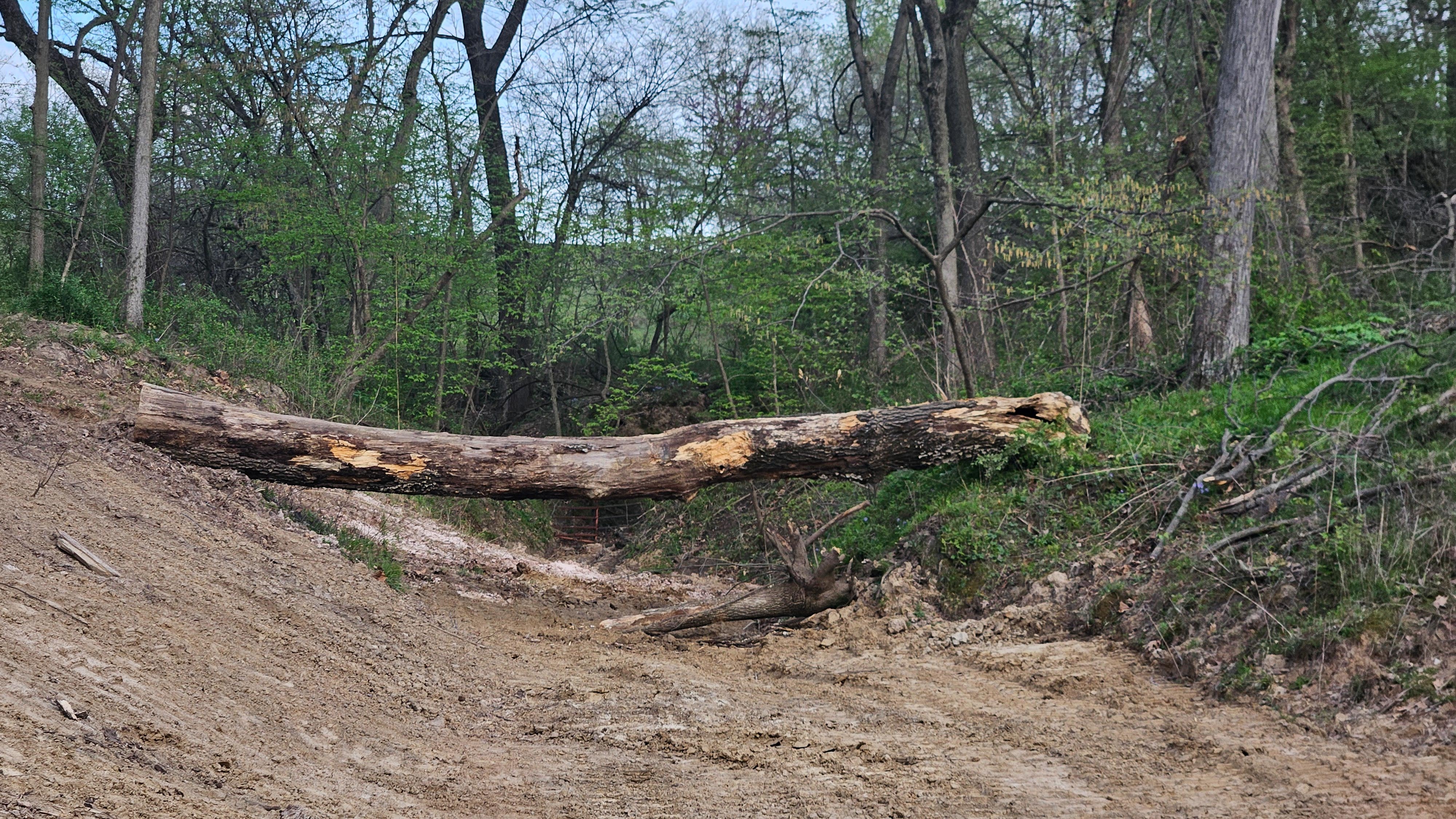

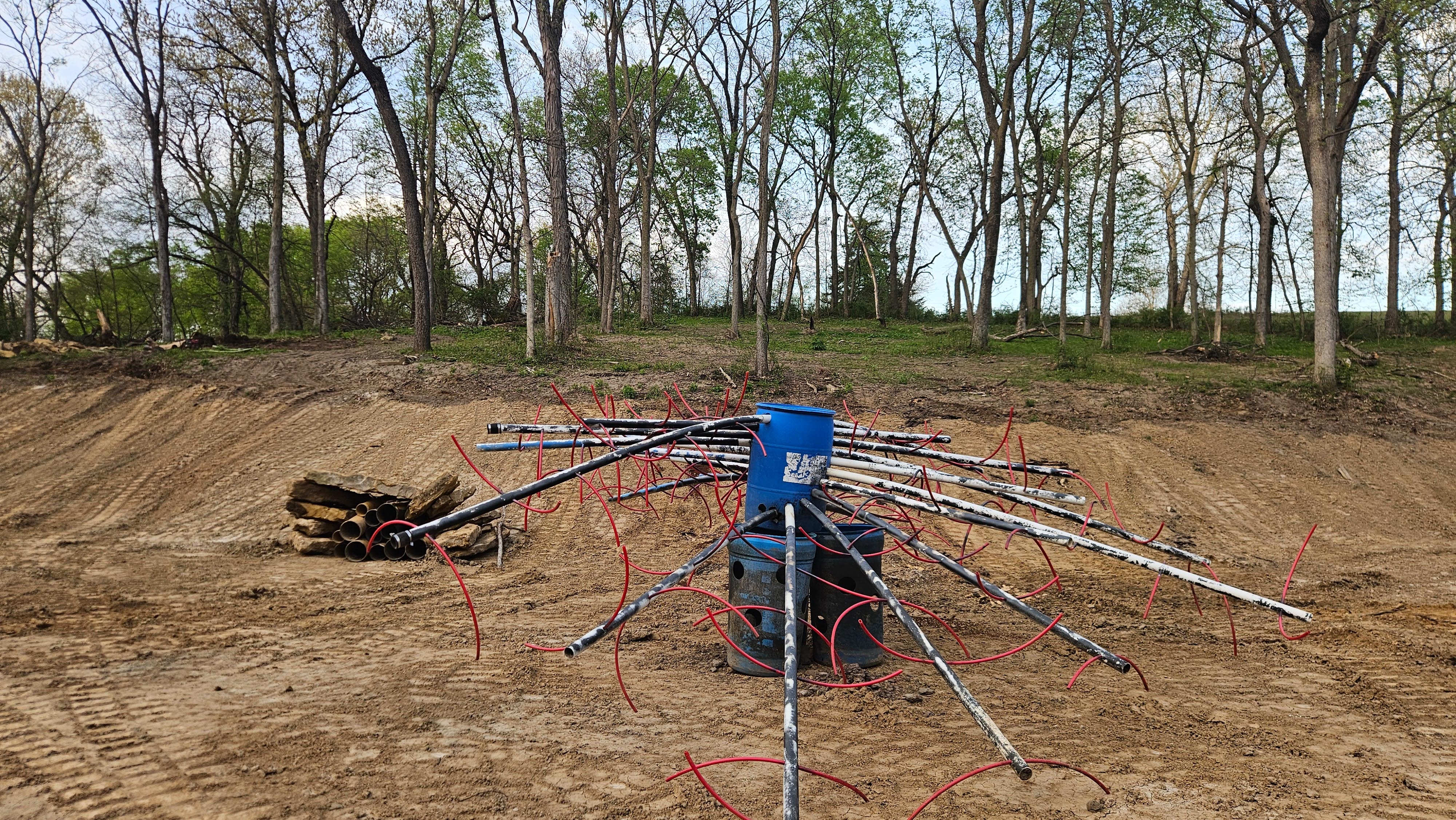

#1,290
Took a little time today to add some fish structure back in and a couple log crossings. Also took the rotary lazer out just before dark to shoot the waterline, check the level of the last walk path I cut in, and check pond depth. Had never checked depth, just guessed. 13ft at the damn. Half the flat 9 to 10 feet, rest of rhe flat about 7 until you hit the slopes or the two fingers of the main bowel where is shallows out. Final pics. Nothing left to do but wait.
