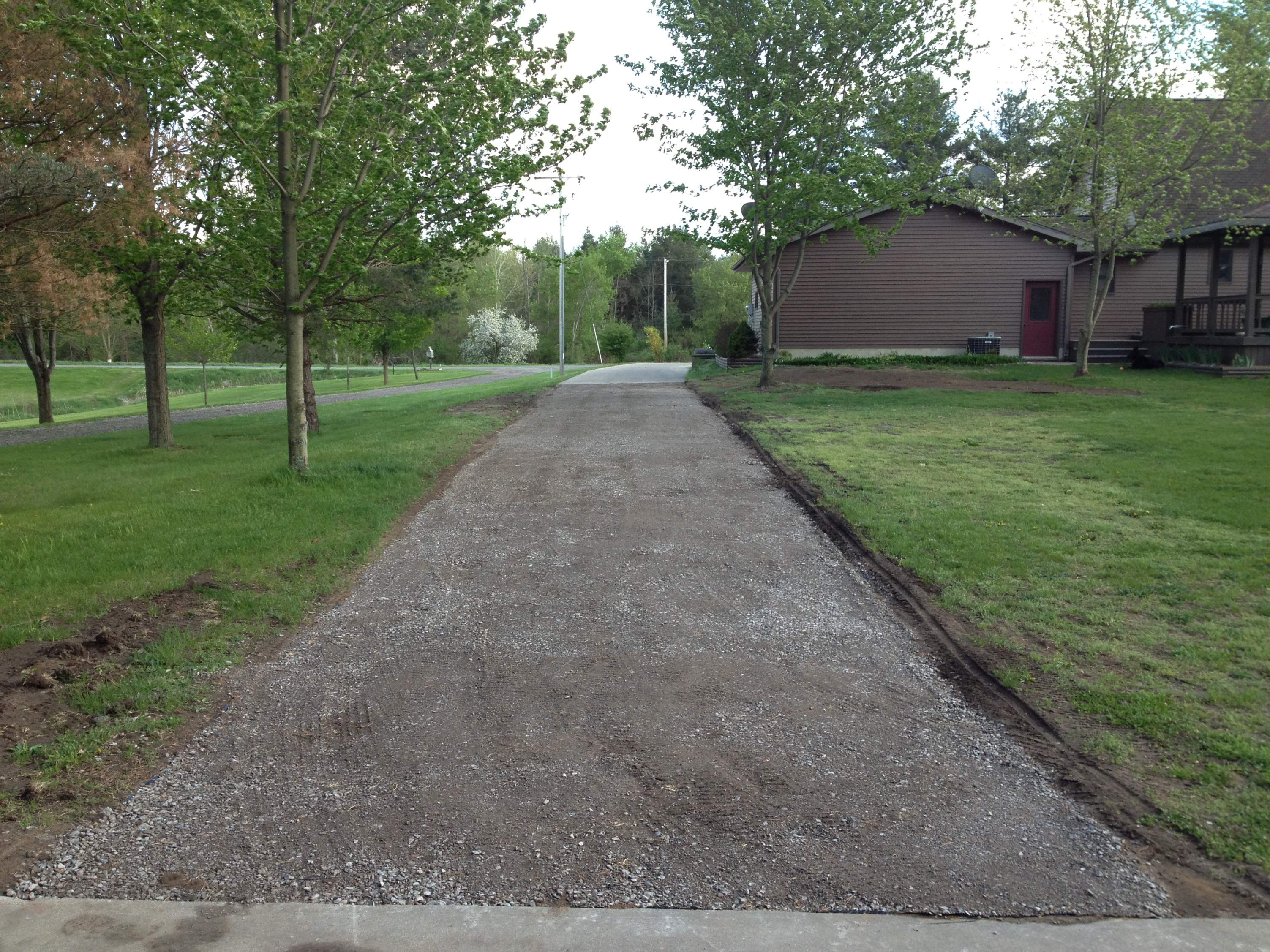

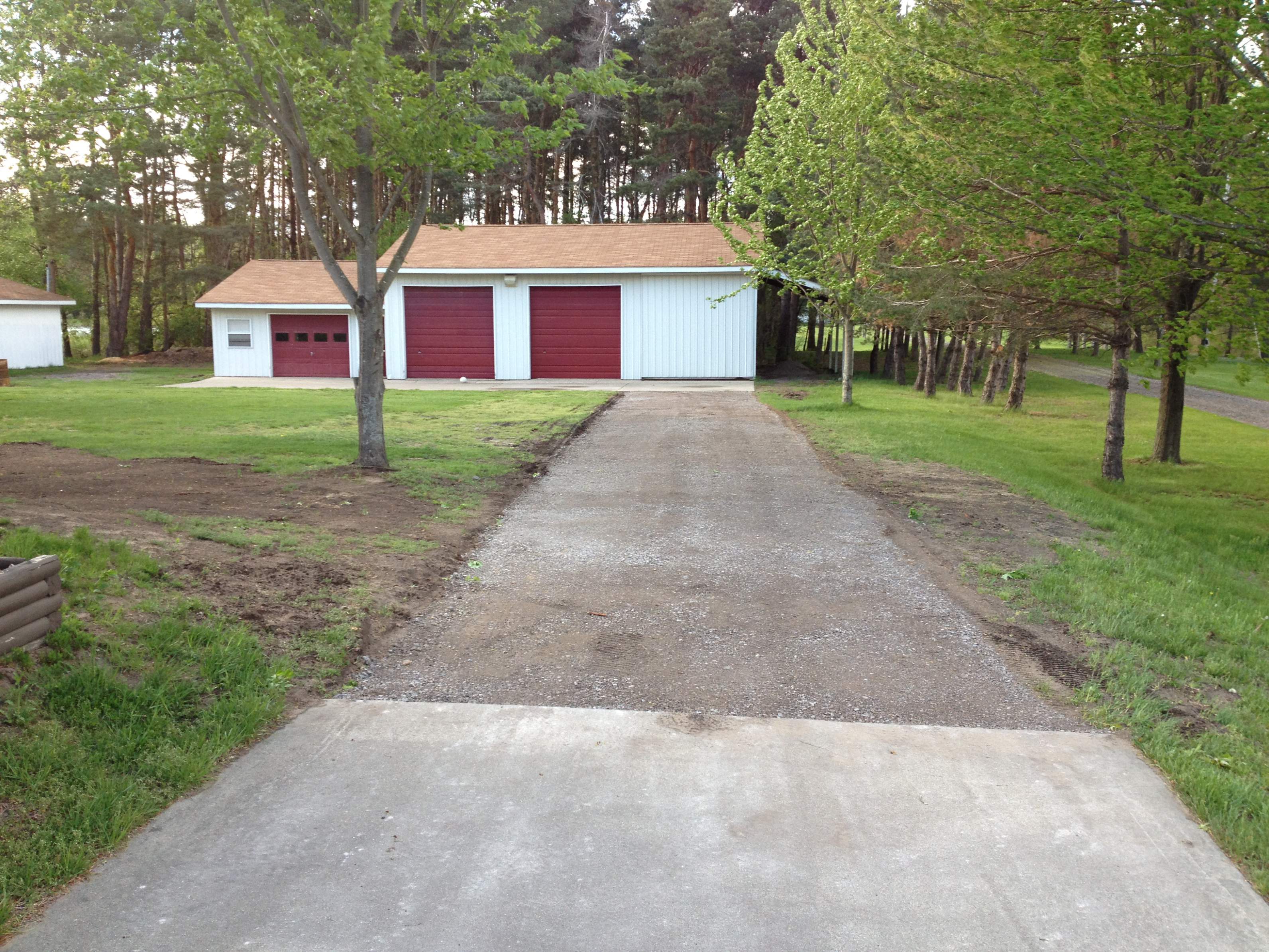

I just added a 100' x 12' gravel extension from the driveway down to my pole barn. I took off about 4" of topsoil (very sandy), smoothed, rolled, and covered the roadbed with a woven geotextile. I was concerned about loosing the stone down into the sandy soil.
I put the crushed driveway gravel over the top of that in two layers, smoothing, watering, and rolling after each. I used 18 tons of stone, I probably could have used more.
It slopes down a bit from the concrete driveway to the pole barn apron. I didn't put much of a crown on it, it is actually slanted to allow water from the yard to run over it to a drainage ditch.
I started on a Friday after work, and finished that Sunday afternoon. I did the work with a Massey Ferguson GC2600, FEL, 5' backblade, and 920 lb roller.
So far so good, it won't get a lot of heavy traffic so I don't expect too much trouble. Total investment was about $450 plus a tank of fuel.
