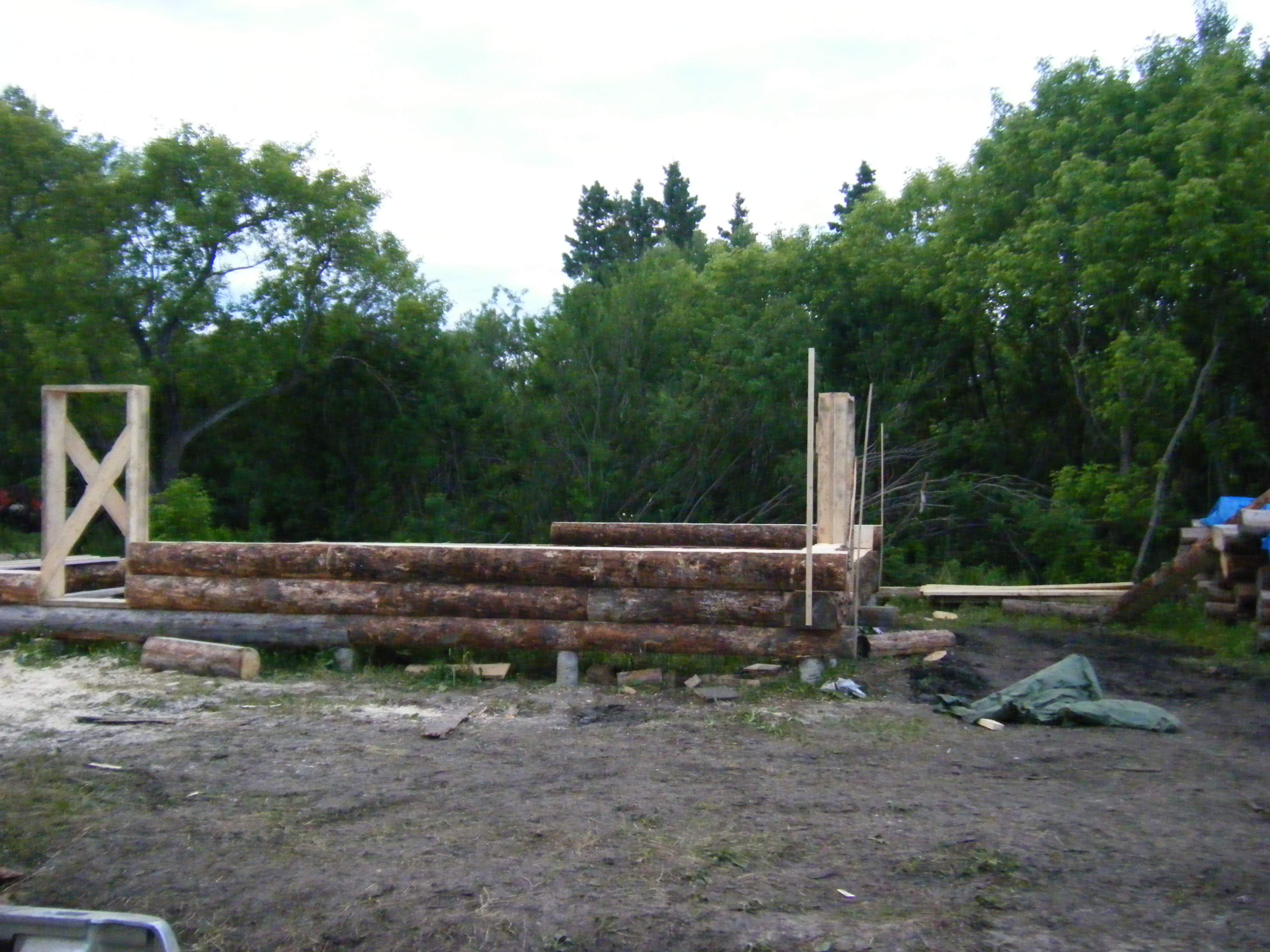

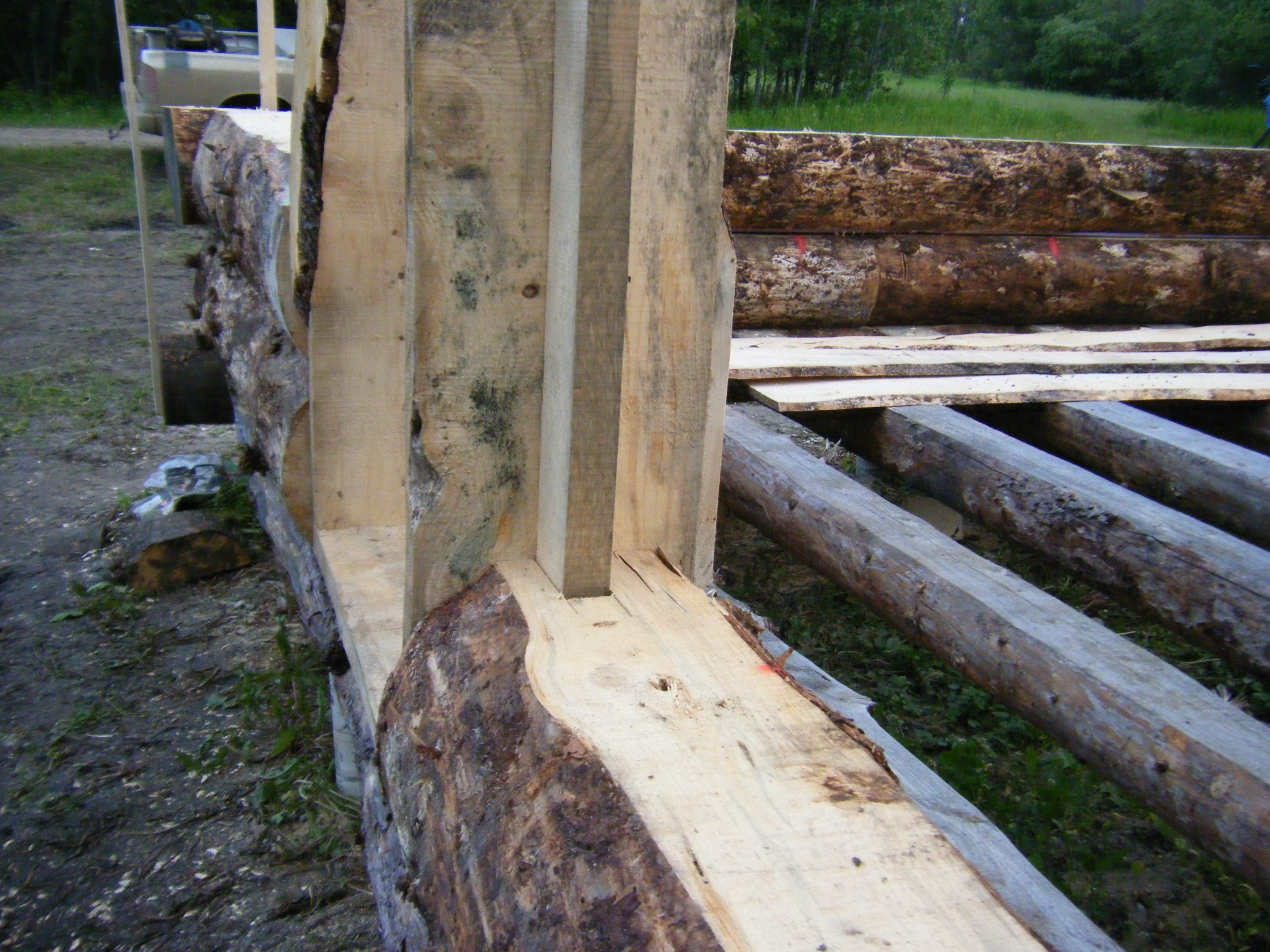

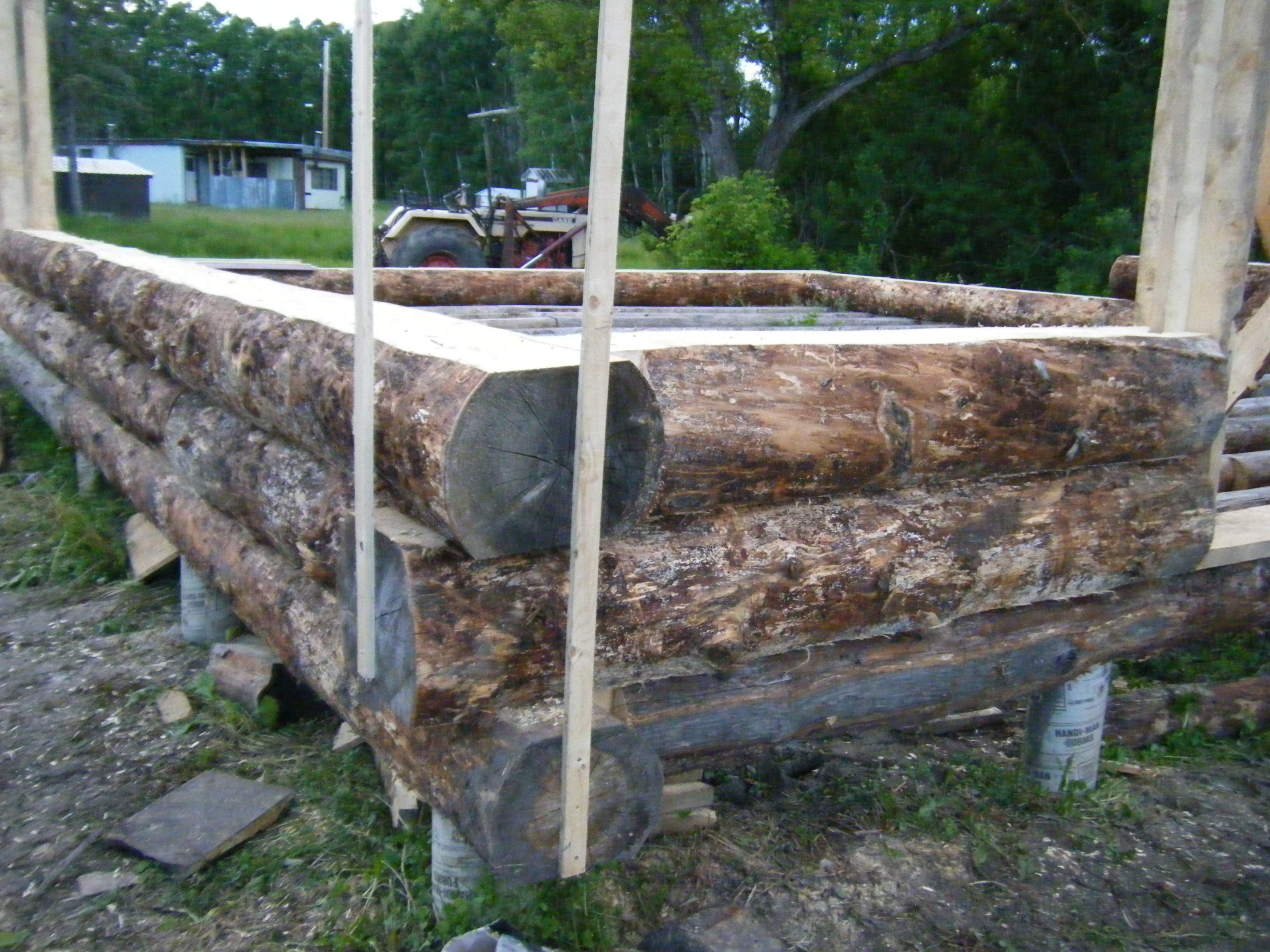

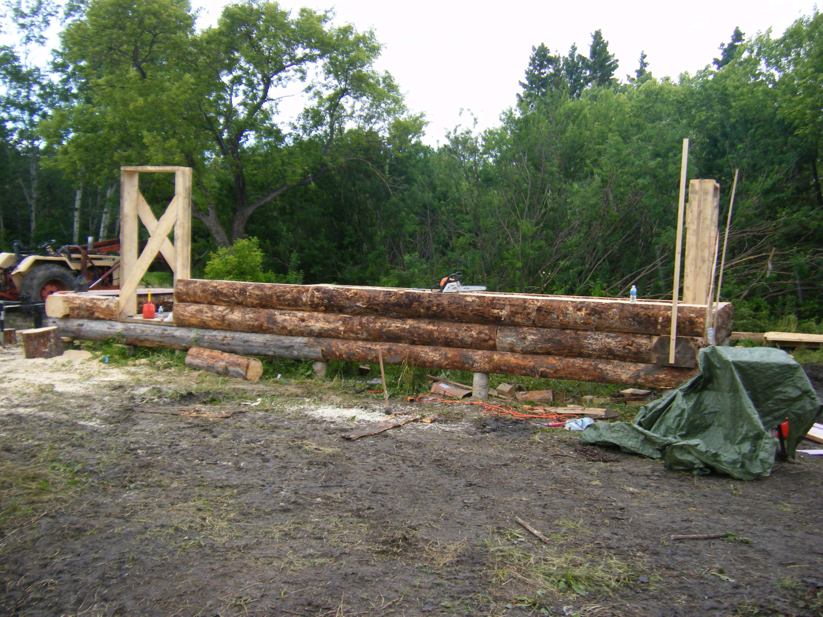

Spring 2011 is finally here and we got started again after 7 months of brutal winter. we had lots of help from friends and family to peel logs and we are milling them as they are peeling. we started the build and found out this was far more difficult than we thought.View attachment 302995View attachment 302996View attachment 302997View attachment 302998
Your concrete piers look small, compaired to the large logs! Good thing you have a tractor to move the logs around. What are the dimensions of the cabin, will it have a upper level? Just think about how hard this would be to build this, 100 years ago.:D
Dave
