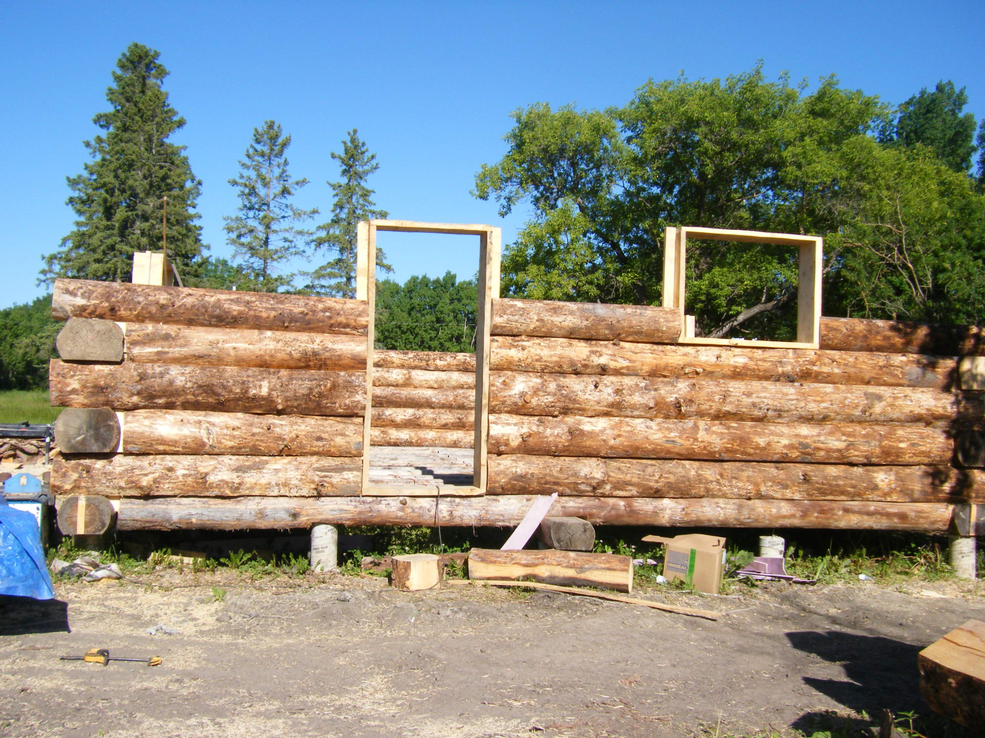

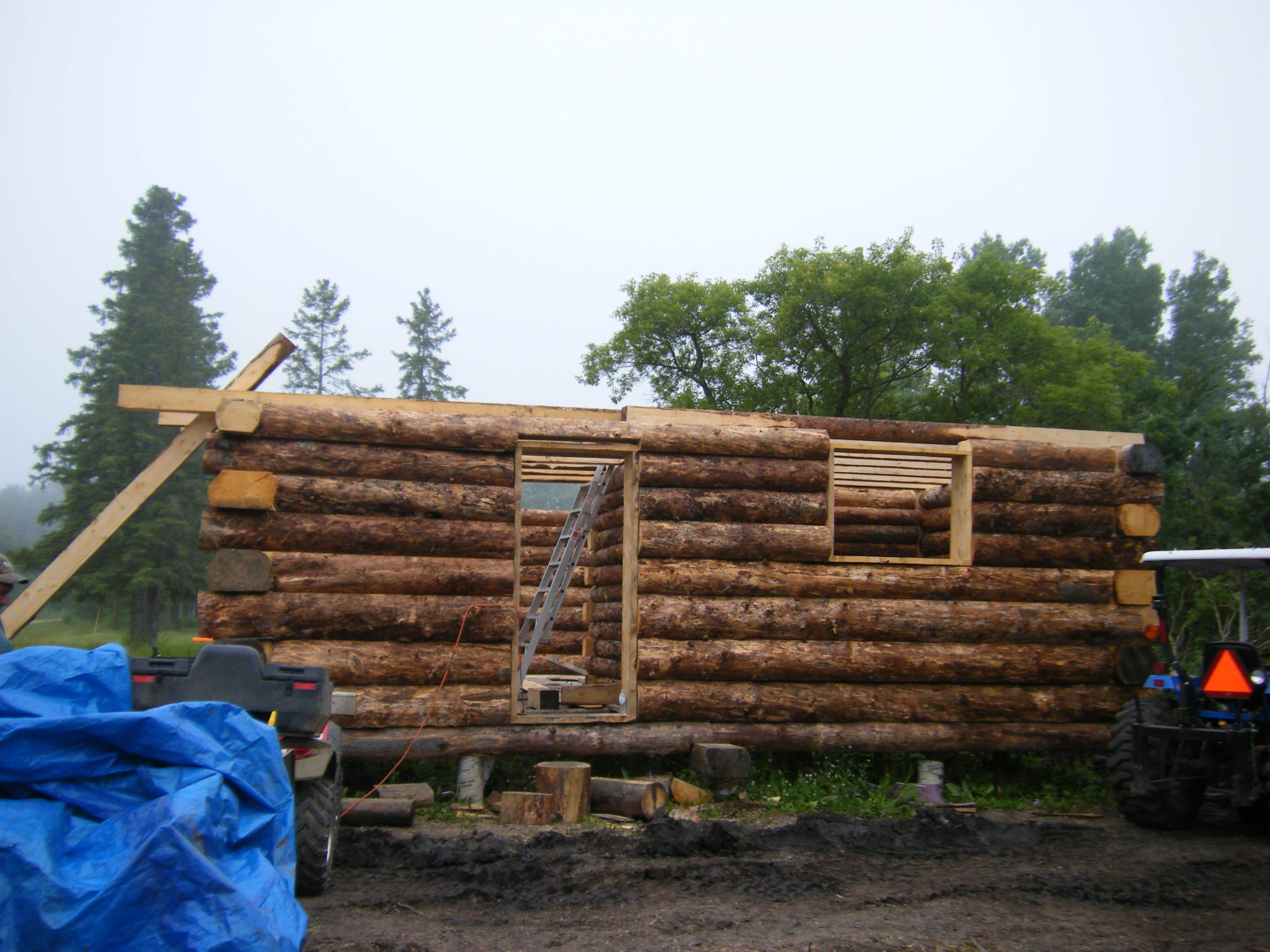

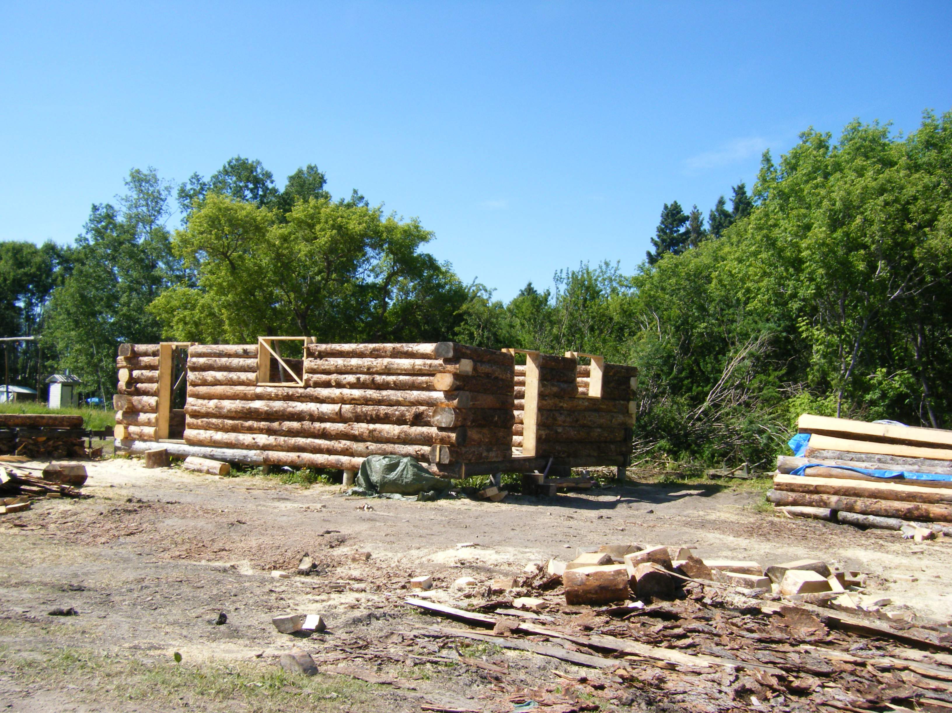

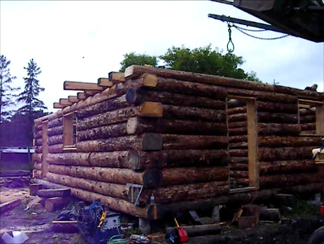

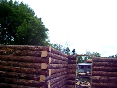

Well we got the walls started finally and it is long process. We built spine boards in the window and door frames to allow for log shrinkage .We milled all the lumber for the frames and the logs as we go. somme 013.jpgsomme 014.jpgsomme 020.jpg

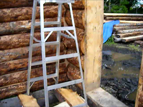

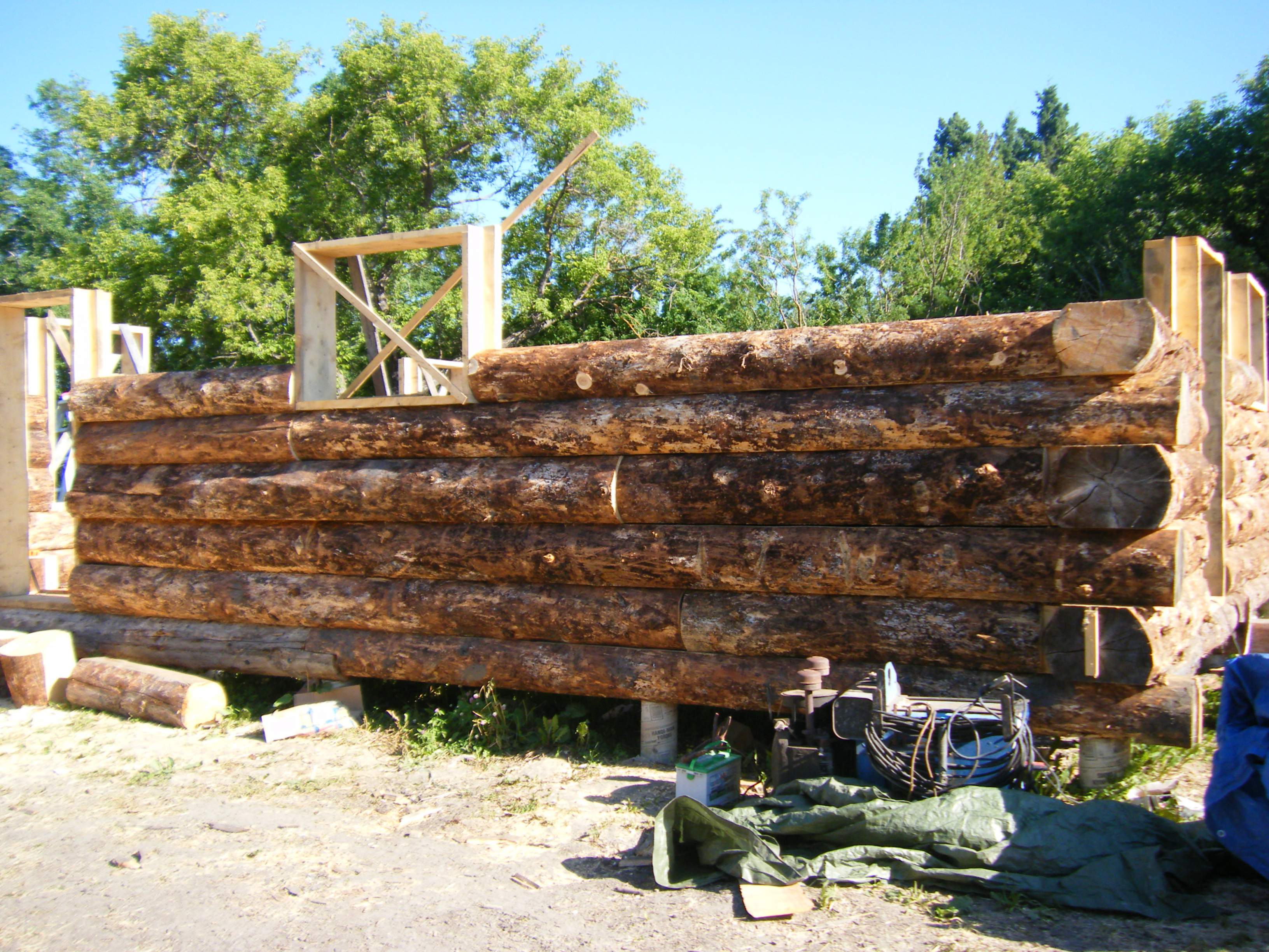

Our cabin is 26' by 30' with a 14x26 loft. When we cut the logs flat on both sides we sealed them with two strips of a seal called EM Seal. It compresses and expands with the movement of the logs. We are still dealing with lots of rain and are used to working in the mud. We fastened the logs every 3' with a 3/8 12" lag bolt which was countersunk in the top log about 5 to 6 inches. Lots of drilling with a 1" bit to allow for a socket wrench to fit. We welded a 10" extension on the socket so it would come out of the hole without falling off when the bolt was tightened. we used an electric impact run by our portable welder to tighten the bolts saved a lot of time and energy. We then built the bottom bedroom inside to support the loft and to tie the walls together.inside bedroom.pngworking in water.pngbedroom before door cut.pngloft floor joists.png

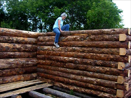

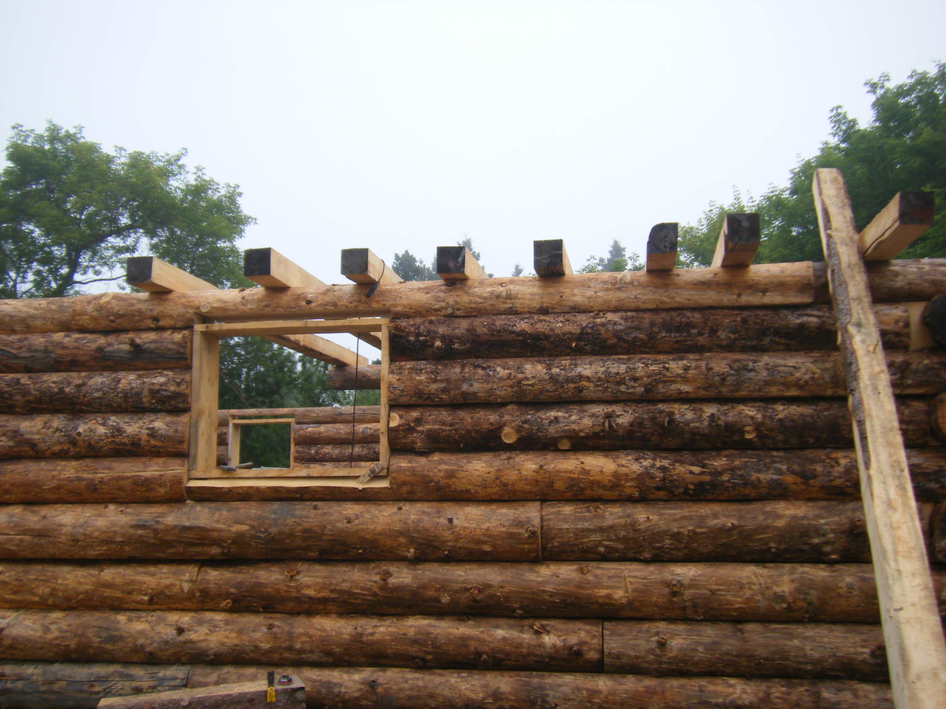

we lifted most of the lower ones with my t1510 fitted with log forks. easy with this because of the hydro transmission but when we could not reach higher we had to depend on old reliable my 730 case with a du al loader. we built log forks on the bucket to which we attached a 4x4" box tube about 8' long and made a jib so to speak so we could make the long reaches, worked very well however shifting gears and riding a clutch were not the same as the hydro .Once we got the walls up we started with the loft joists 7x7 just because that was the size of the logs. when they were down we used 5/8 tongue and groove plywood for the subfloor.As you can see my wife is really at home with heights,still don't how I convinced her to go up there. This as far as we got for 2 weeks as our second daughter was getting married . two down and one to go.cabin inside 013.jpgcabin inside 015.jpgcabin inside 016.jpgcabin roof 015.jpg

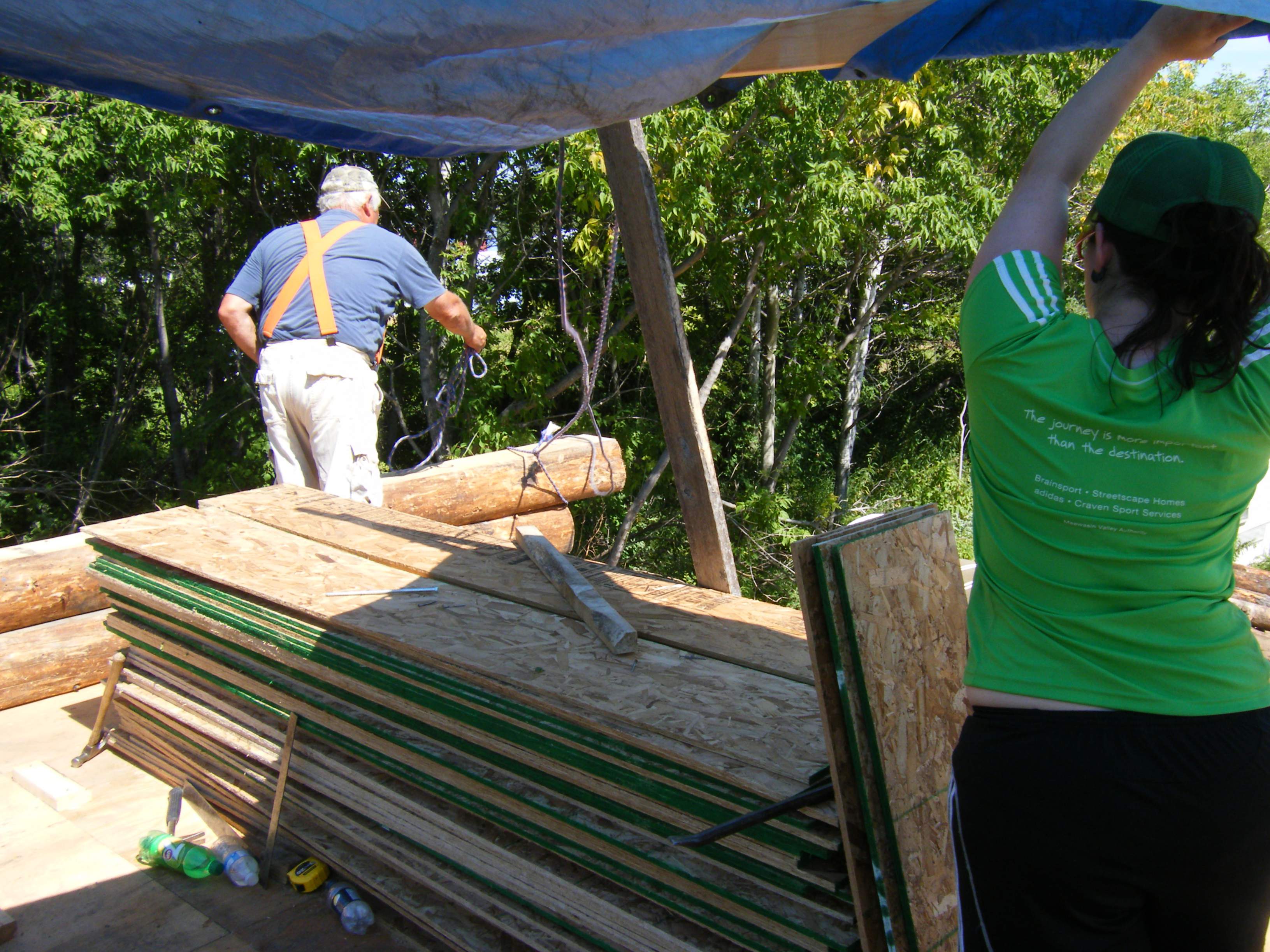

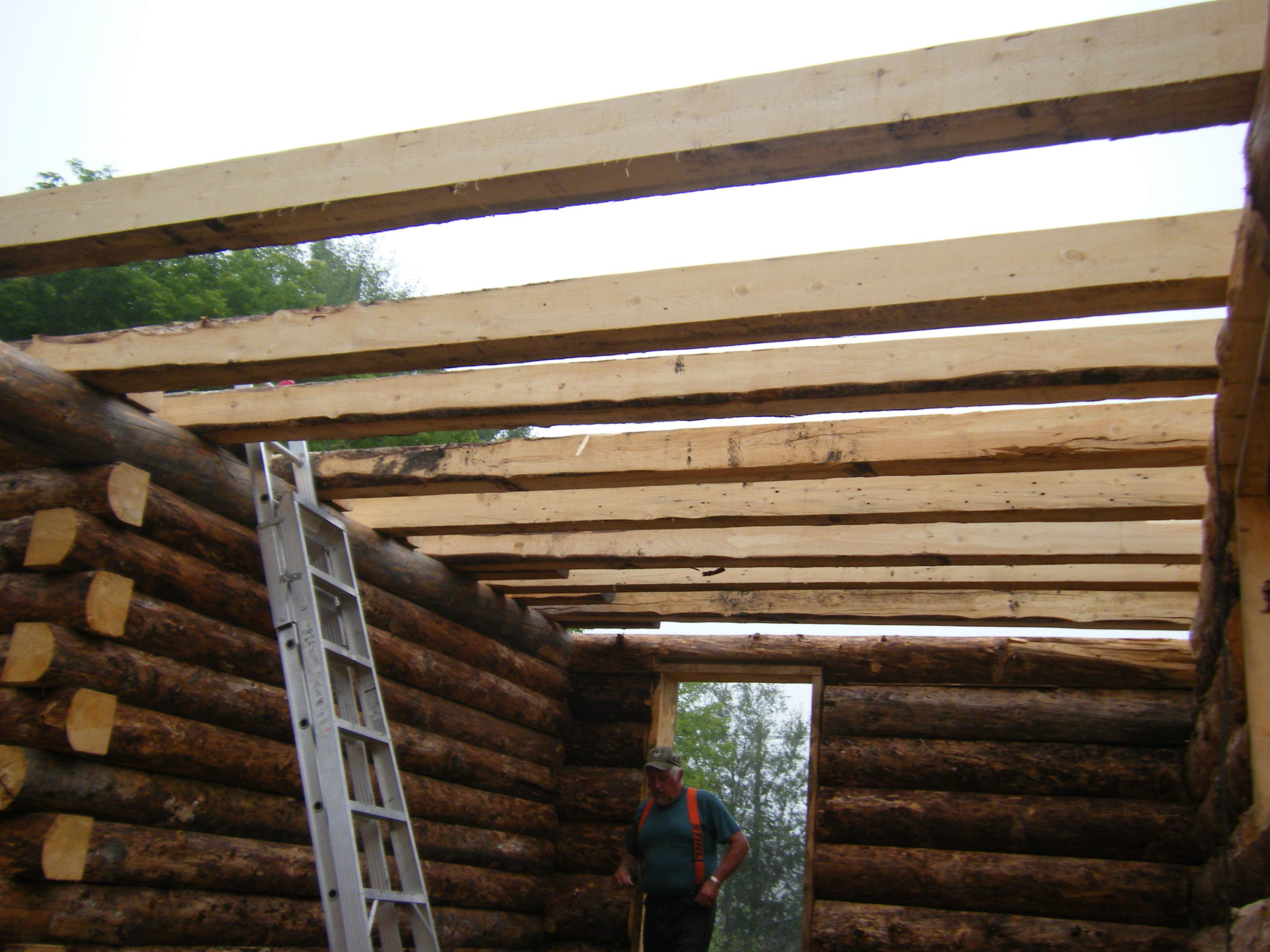

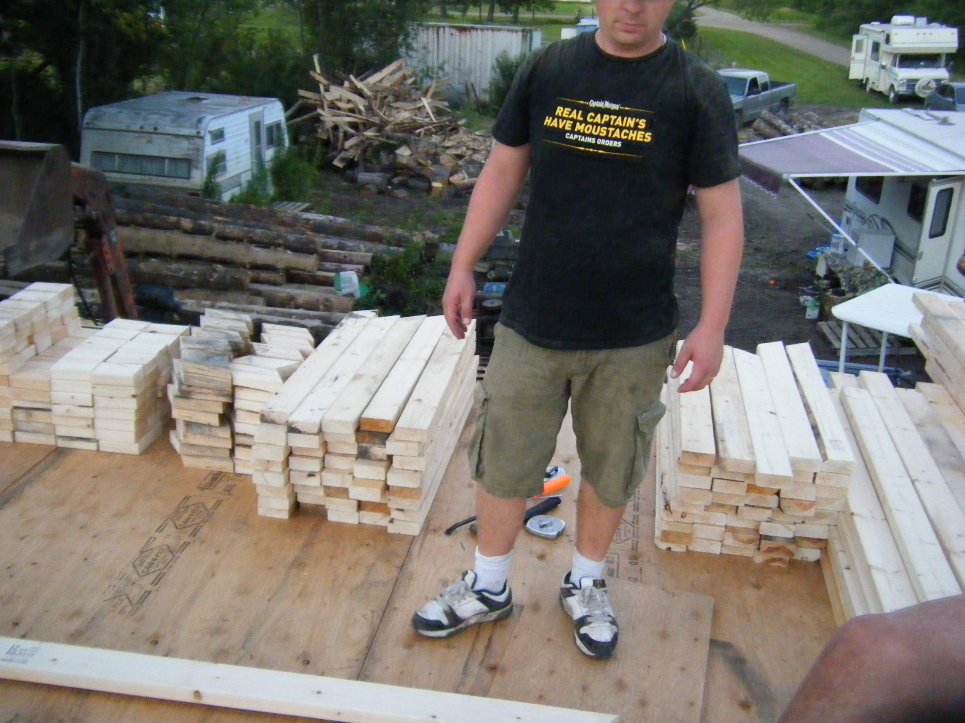

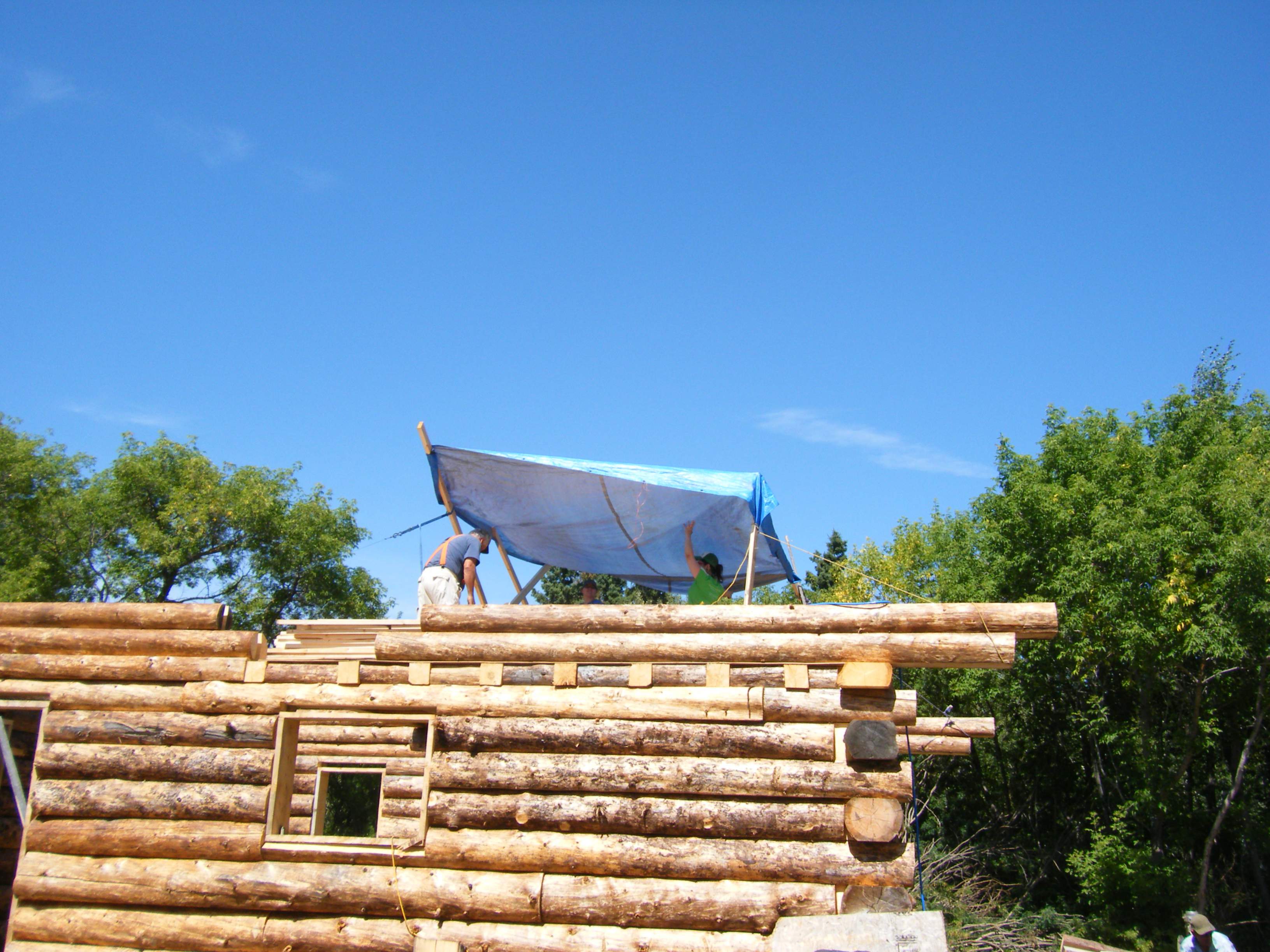

Finally got the second wedding done, another son in law to help, and away we go again. Got the last of the logs in place and started on the loft floor and building the rafters. For the rafters we purchased 18' 2x4's and 3/8 strandboard. We used the sawmill to cut the sheets in 1x8' strips . then we used the 2x4's for the upper and lower edge to the rafter nailing and glueing the sheets to the side to make a rafter. Lots of nailing about 7000 nails with the power nailer, Mike my son in law did most of the nailing and at the end of the day he sure felt it.the day we did this it was very hot and humid so we had to build a canopy over us to keep the sun off of us. My dad who was 80 was helping us as a forman.cabin roof 042.jpgcabin roof 028.jpgcabin roof 033.jpgcabin roof 041.jpgcabin roof 029.jpg

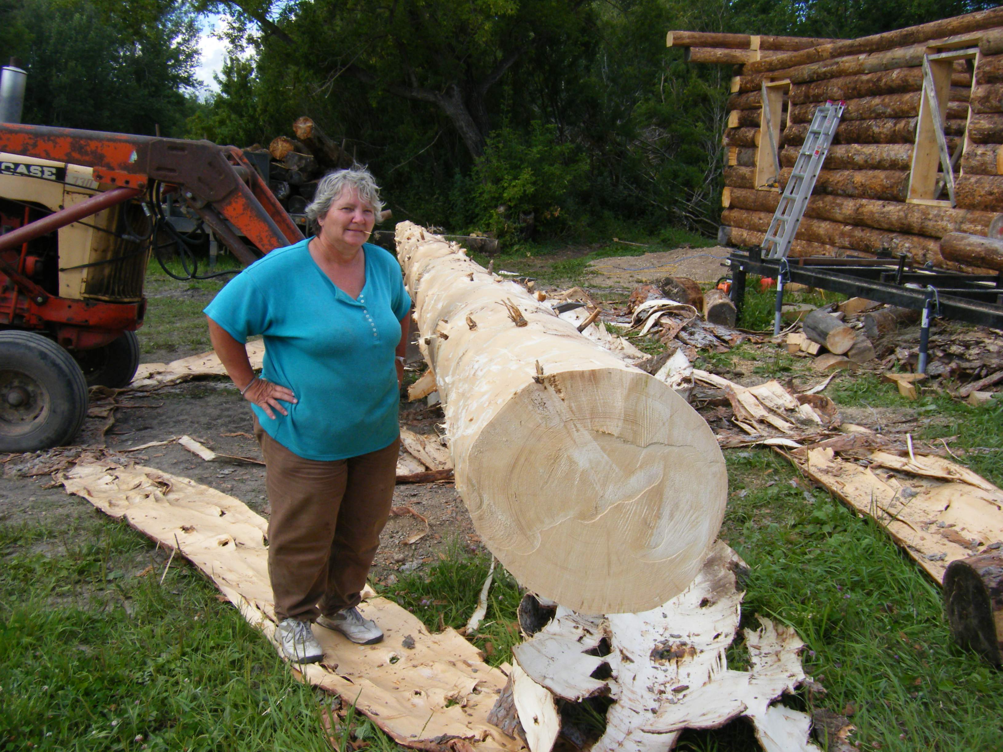

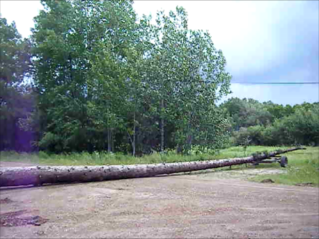

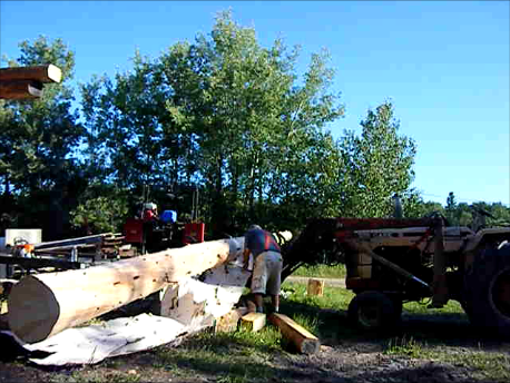

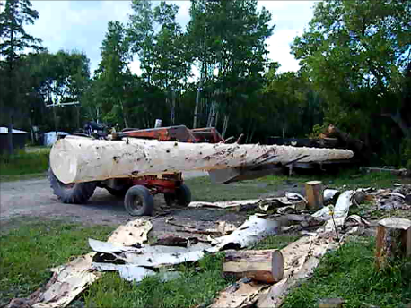

Finally got the rafters built and stacked on the loft floor. Could not have done it without the help of family and friends. We took a day off got on the quads and went looking in the forest for a ridge pole. After about 5 hrs of searching we finally found what we thought was the perfect tree. We had to take the quadrants back to the forestry branch get the okay and permits and back to the forest to cut it down. these are the pictures of cutting and hauling and peeling it.ridge pole before peeling.pngpeeling ridgepole.pngpeeling ridgepole01.pngridge pole ready to be lifted.pngcabin roof 055.jpg
