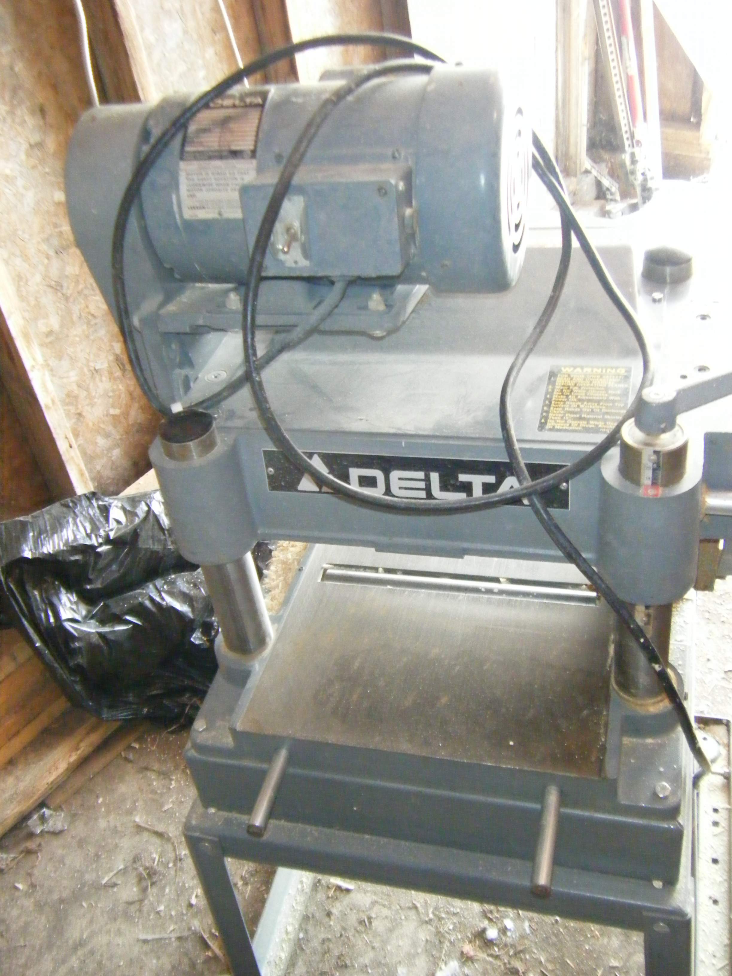

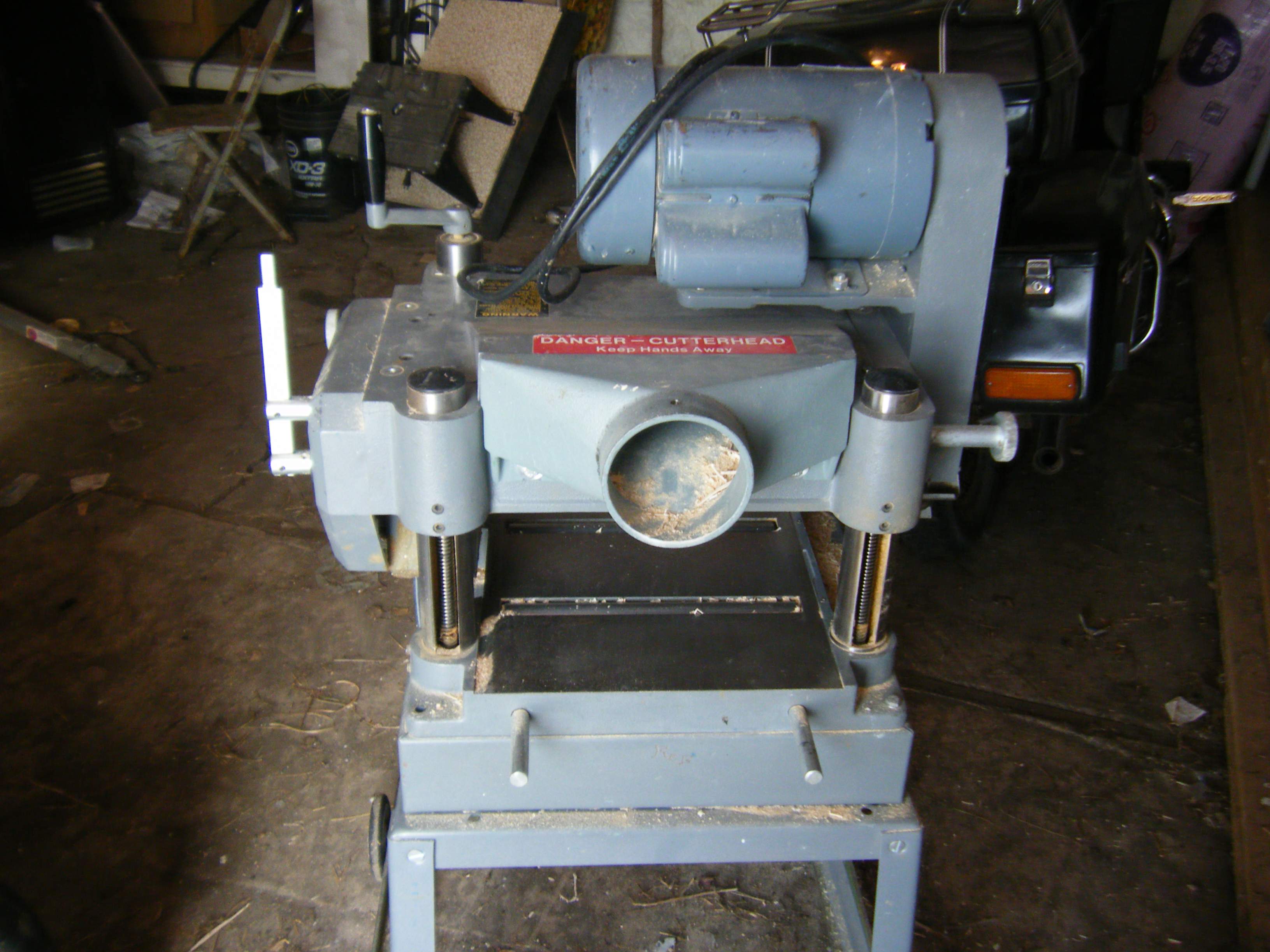

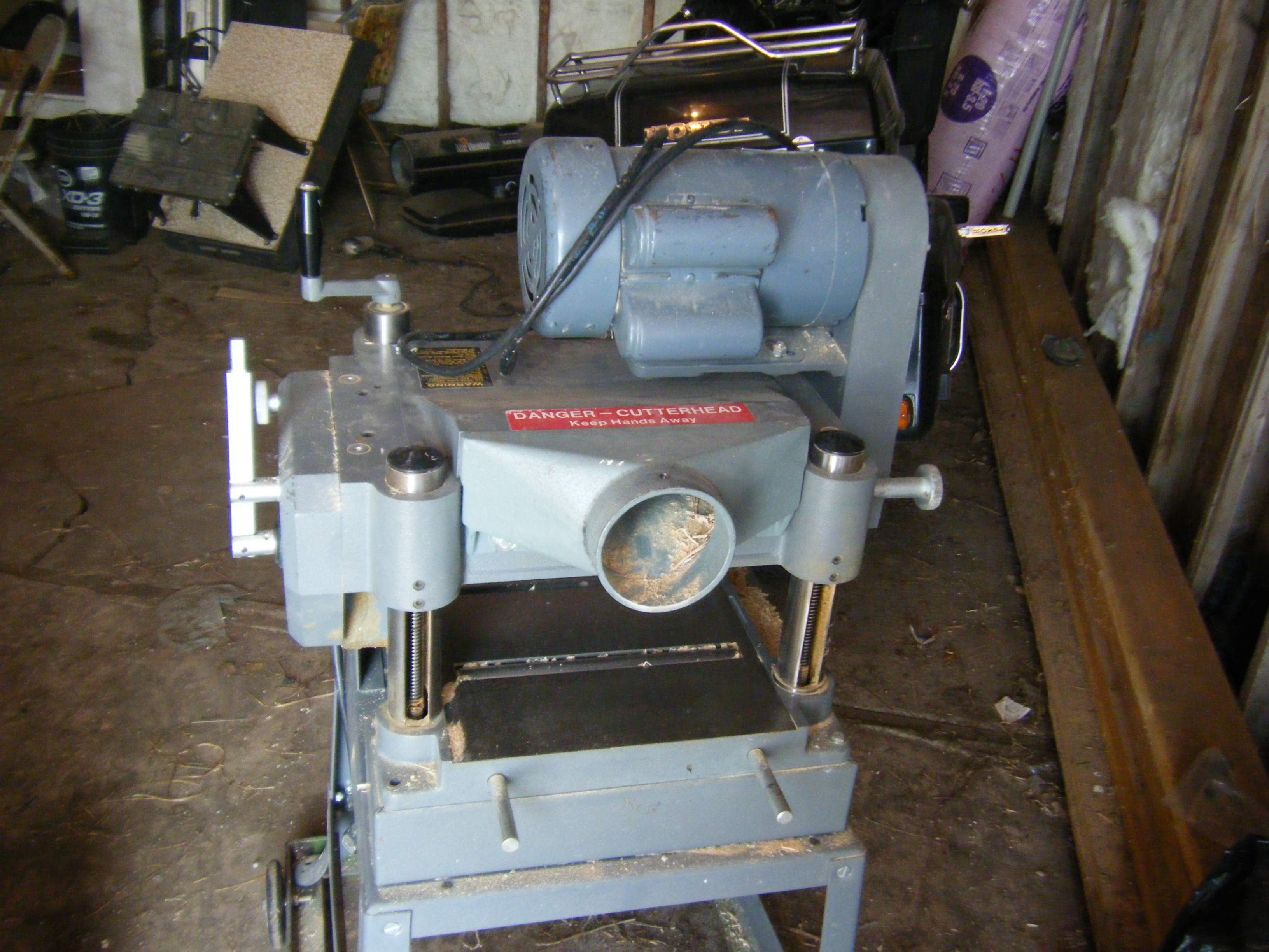

I have got some pictures of my planer to post. I have not used it yet as I currently don't have a 220 plug for 15 amp in my shop. I have an old westinghouse breaker box,hard time to locally find breakers to fit it so I have to wait to go to the city to Home Depot to get them. I got two sets of blades extra with the machine with the blade setter as well. DSCF5125.jpgDSCF5126.jpgDSCF5127.jpg

Nice, 15" planer, just a point, this planer needs to be connected to a 20 amp circuit not 15 amp.

Awesome looking sander.

Rmorey thanks for the tip. the cord has 2 flat ends side by side and the third ground I thought this was a 15 amp plug.

What does the tag on the motor say for amp draw? Being 220 it won't be that high. But there will be peak loading where it will spike to maybe double or triple the continuos amperage. Some motors will state the peak and continuos amperage on the name plate.

Unable to find a peak listing, just show 12amp 2hp 230 volt, however there is one mark on the plate that says am s 40 don't know what that is
