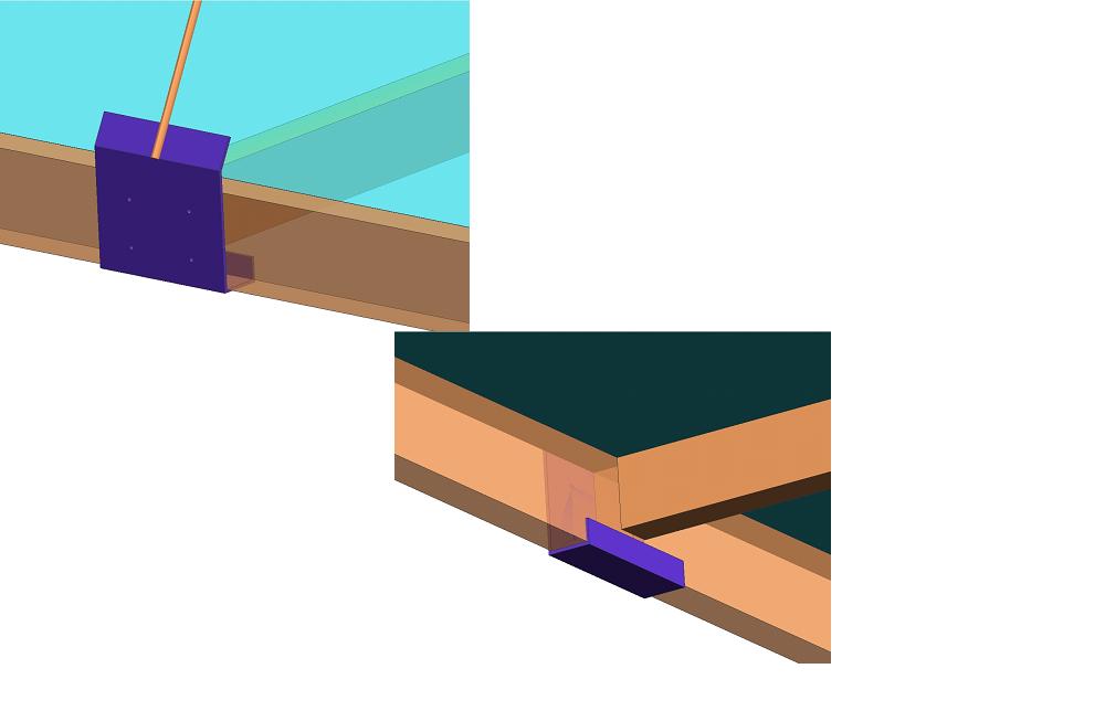

I need help on how to build aprox 28' of shelving on the inside of my pole barn. The short side has poles(3 - 2x6) 10' OC and I have added studs 2' OC for extra bat insulation, electrical outlets etc..
The shelf will extend out 33" and needs to be suspended so it is clear underneath to park the riding lawnmower and heavy implements. The light wieght implements like the sprayer, cone spreader, push mower will be stored on the shelf up and out of the way.
So far the only thing thats been done is to nail up the 2x6 ledger board. The initial plan is to put up joist hangers, joists and a rim joist and use 3/4 OSB or ply for the floor of the shelf. The plan on how to suspend it is in the air and how much weight can it hold?
There is nothing directly above the shelf location to mount anything. So the thinking was to chain or cable the shelf to the studs and poles with aprox 4' spacing. So what would be the best way to do this?

sounds like for the weight of items that you are storing, 2x4 joists on 24" centers should span the 33" easily with a beam or rim joist? of another 2x6 should span between 8' threaded rod or cable, or crs rod welded to brackets to go underneath 2x6 beam and over top chord of trusses. If you put at angle back to wall would that interfere with long items the you wish to store?
Also those hangars can add up, Unless you own Simpson stock why not nail joist on side to top of ledger and beam? Maybe the 1.5 inch gap would not be aesthetically pleasing?

Agreed, 2x4's 24" OC for the joists. Perhaps my terminolgy is not correct. I'm assuming the outside board nailed to the joists is called a rim joist.
</font><font color="blue" class="small">( of another 2x6 should span between 8' threaded rod or cable, or crs rod welded to brackets to go underneath 2x6 beam and over top chord of trusses. )</font>
Are you saying the rim joist should actually be a beam, 2-2x6's nailed together? Or just where they butt together?
My assumption is but them together half way between the joists then nail another 2x6 to the backside to beam that 2' portion.
My nearest truss is 8' out since this is on the gable side of the building. I don't think I'm following you correctly on this.
Also what does the bracket look like? I have plenty of 3/8 steel plate and bars I can weld up.

It might technically be a rim joist, I am not a carpenter. A single board on edge would be acting as a beam
to support joists away from ledger
<font color="blue"> this is on the gable side of the building. I don't </font> .
Oh, You did say there was nothing above for support! /forums/images/graemlins/blush.gif
3/8 is a waste 1/8, 8ga would be fine.
see pics
10' apart might wanna use 2x8 rim joist

The bracket is what I was thinking just wanted to be sure. The 3/8 material is overkill however it was free and have plenty. Thanks for your input.
