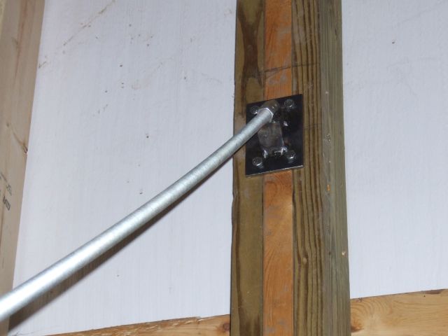

This is the upper bracket, needs primed and painted yet.

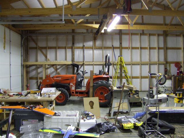

Here is a shot lookin down toward the door. Its hard to see but there is a 48"x 36" framed up on the corner to house the air compressor.
I changed my mind and decided to go 48" wide on the shelf vs 33" since its up high enough to walk under.

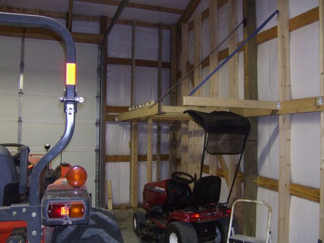

#13
Pic showing how wide the shelf will be and my other junk and projects laying aroung. The shelf may go another 10' and start hanging cabinets at that point.
Hopefully rest of the shelf will go up tomorrow if HD has more 6' rod in stock.

   / Building suspended shelves in a pole barn #14
Those are nice brackets.I have built simlar shelves with 2x6 screwed in the side of the framing like that,not sure it would hold the same weight though.Instead of parking your mower under it,I'd bet it you would have no problem parking it on it.
