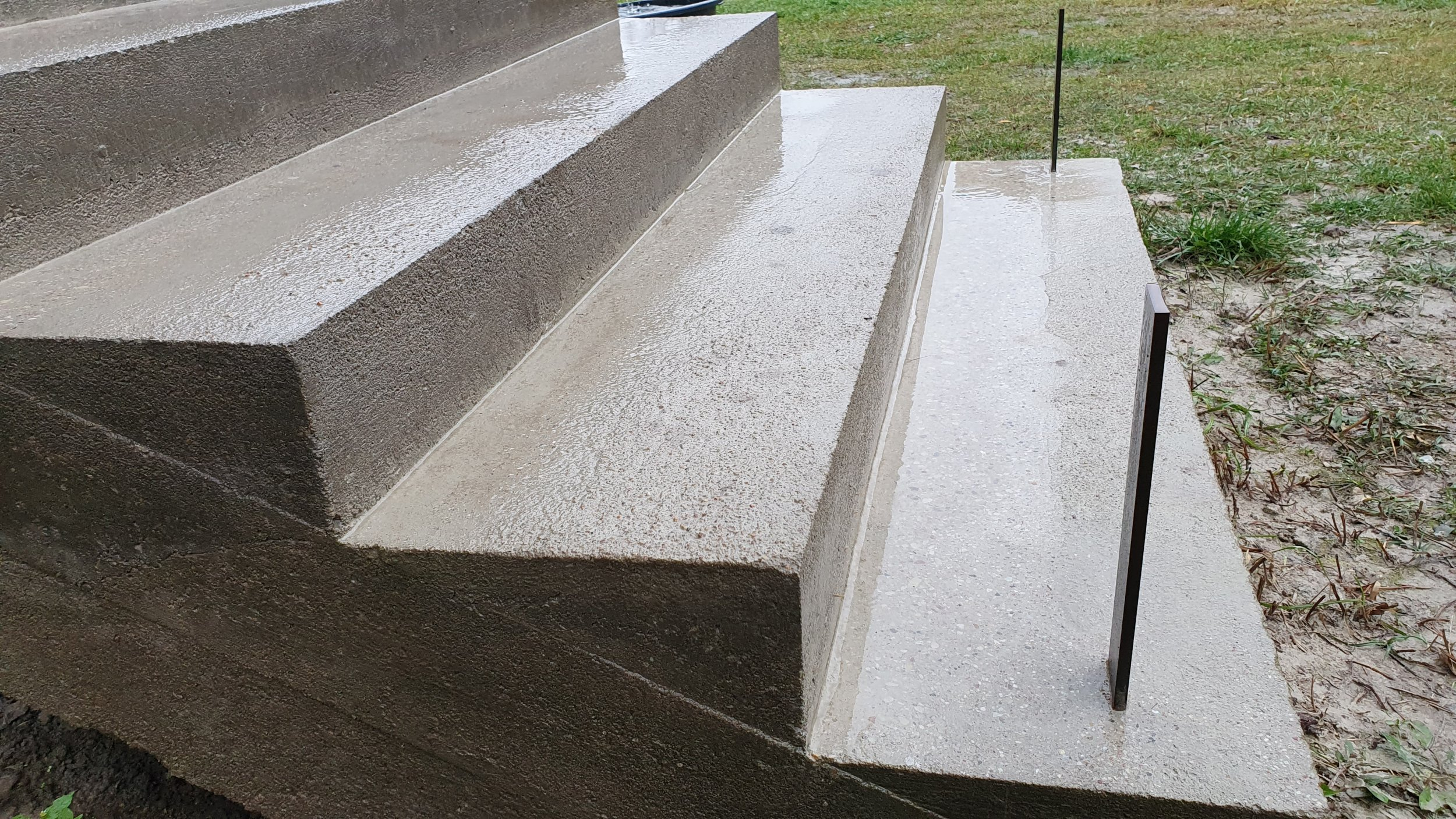

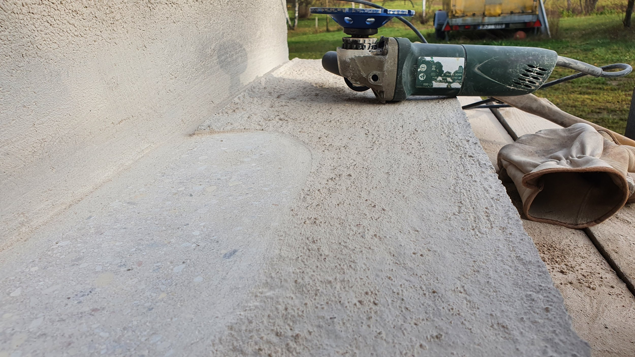

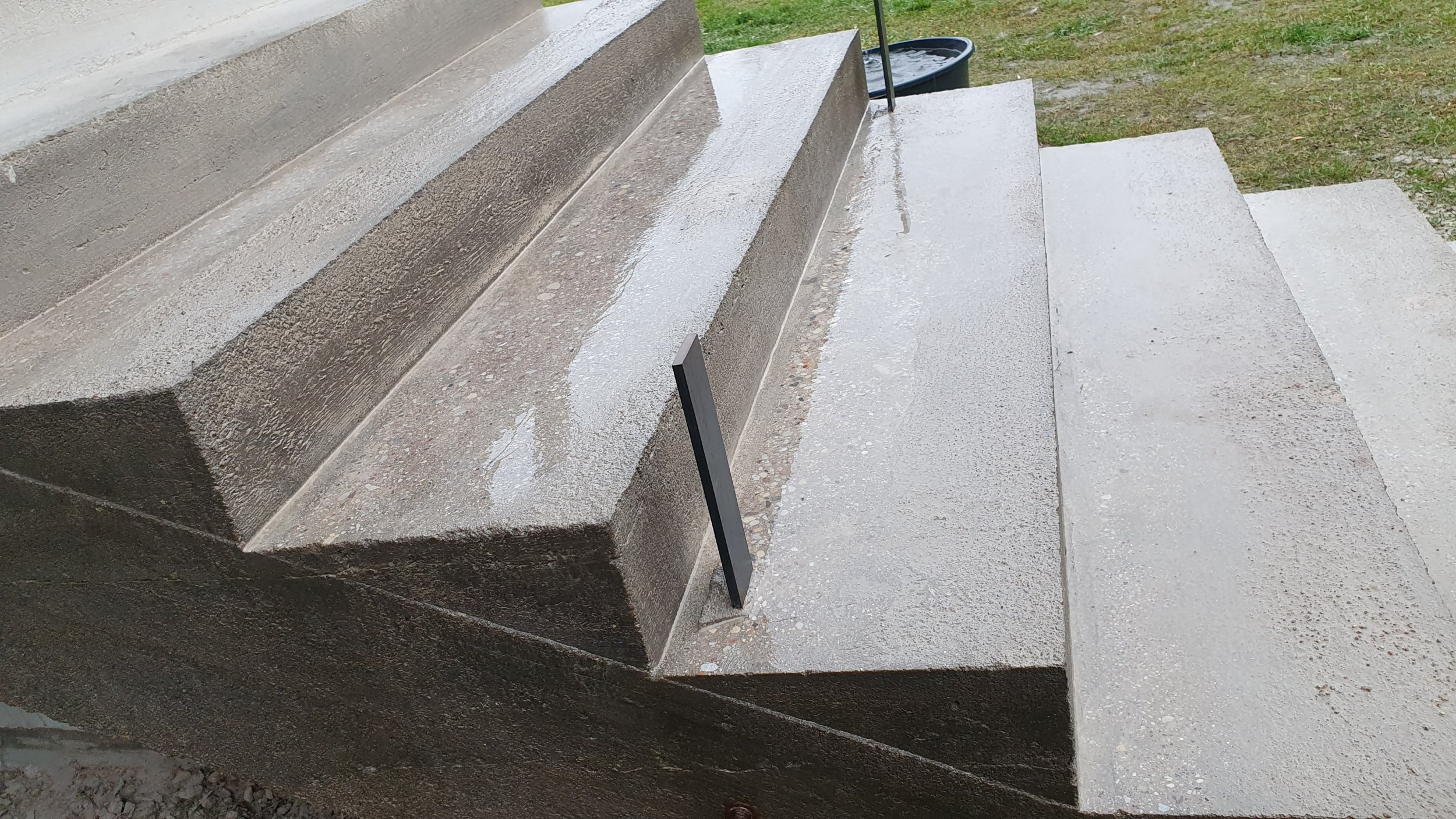

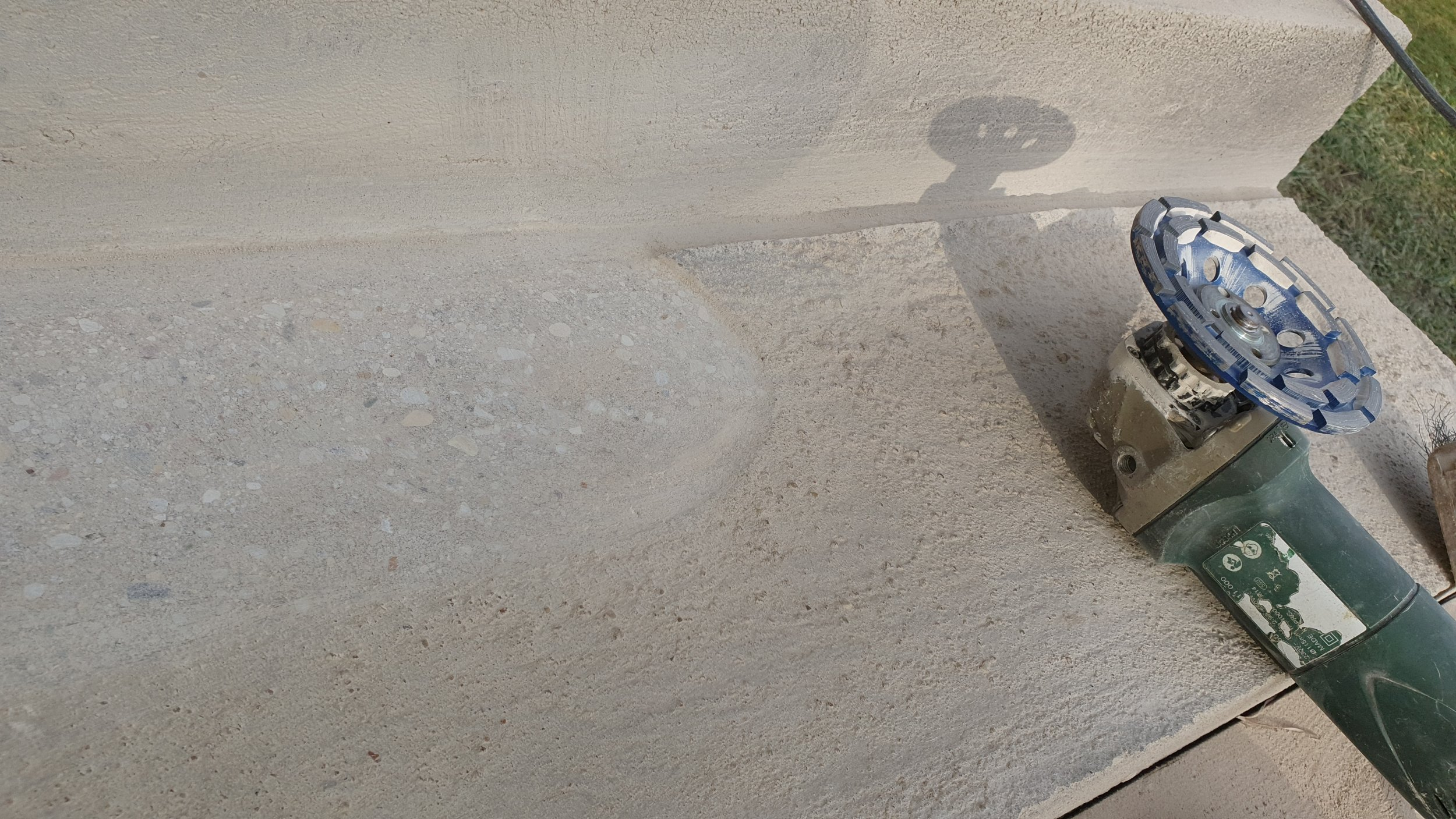

I managed to grind the gaps between the steps.
The rain shows where you need to make gentle slopes on the steps to avoid water accumulation.

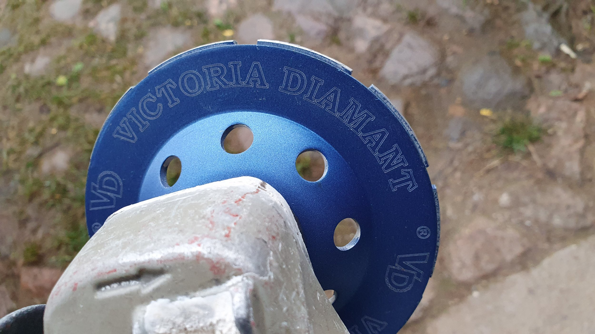

Grinding disc used. Works great.
