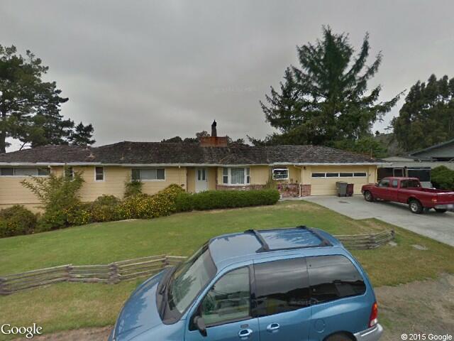

DW and I built our retirement home 7 or 8 years ago, and I designed most of it, including the complete layout
From our experience, I have some advice.
One of the things many people overlook in a retirement home is that you should design it to be able to stay in it for as long as possible, even if physical infirmities start to catch up with you. A lot of these things are uncomfortable to think about, but if you need these features sometime in the future, the need will come at a time when medical issues will have drained both your energy and finances. They are much more expensive to add later than to build in at the start.
1. We put a handicap ramp inside the attached oversize garage when we built. You will always be able to get into you car without going out into the weather and the outside appearance of the house is not changed.
2. Speaking of garages, our double garage door is 18' wide vs. the "standard" 16'. The extra space is very nice, and we all know our driving does not improve with age.
3. Every interior door is 36" wide. If, God forbid, you should ever need a wheelchair, this will accommodate.
4. Master bath has a very oversize shower, large enough for a seat and an attendant if necessary.
5. Master bath toilet is located so it would be easy for an attendant to assist on and off.
On the outside, don't forget to provide hookups for an RV so that when friends and relatives, kids and grandkids visit they have a place to park.
If you have pets, an outside faucet with both hot and cold water makes washing them a lot easier for both of you.
You don't say what your place looks like, but consider the orientation of your house with respect to the points of the compass before you finalize your design. We have a view and the large living room windows face due North. This means that whatever you are looking at is lit by the sun, and the sun never shines directly in the window. Both very nice features. This did not happen by accident.
