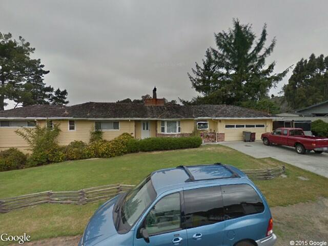

I'm having trouble understanding how the garage floor is the same level as the living area. I've never seen that where I live.

The picture I posted is not the best... it's from Google Earth.
The concrete garage floor is the exact same height as the finished framed floor inside the house... barely a bump for a person in a wheel chair.... maybe a 1/4 inch max... the thickness of the Designer Solarium Lino Floor.
Come to think about it... a lot of homes in my part of California are totally barrier free as far as having no steps...
My parents home is split level and the garage inside garage door opens up to the family room... all on the same level.
Basements are as rare as hens teeth here... homes either have a crawl space or built on slab...

The picture I posted is not the best... it's from Google Earth. The concrete garage floor is the exact same height as the finished framed floor inside the house... barely a bump for a person in a wheel chair.... maybe a 1/4 inch max... the thickness of the Designer Solarium Lino Floor. Come to think about it... a lot of homes in my part of California are totally barrier free as far as having no steps... My parents home is split level and the garage inside garage door opens up to the family room... all on the same level. Basements are as rare as hens teeth here... homes either have a crawl space or built on slab...
All the homes here have foundations with basements or crawl spaces with the garage floor lower than the living areas. Probably because of all the snow, ice, and mud our vehicles pack into the garages. :)
