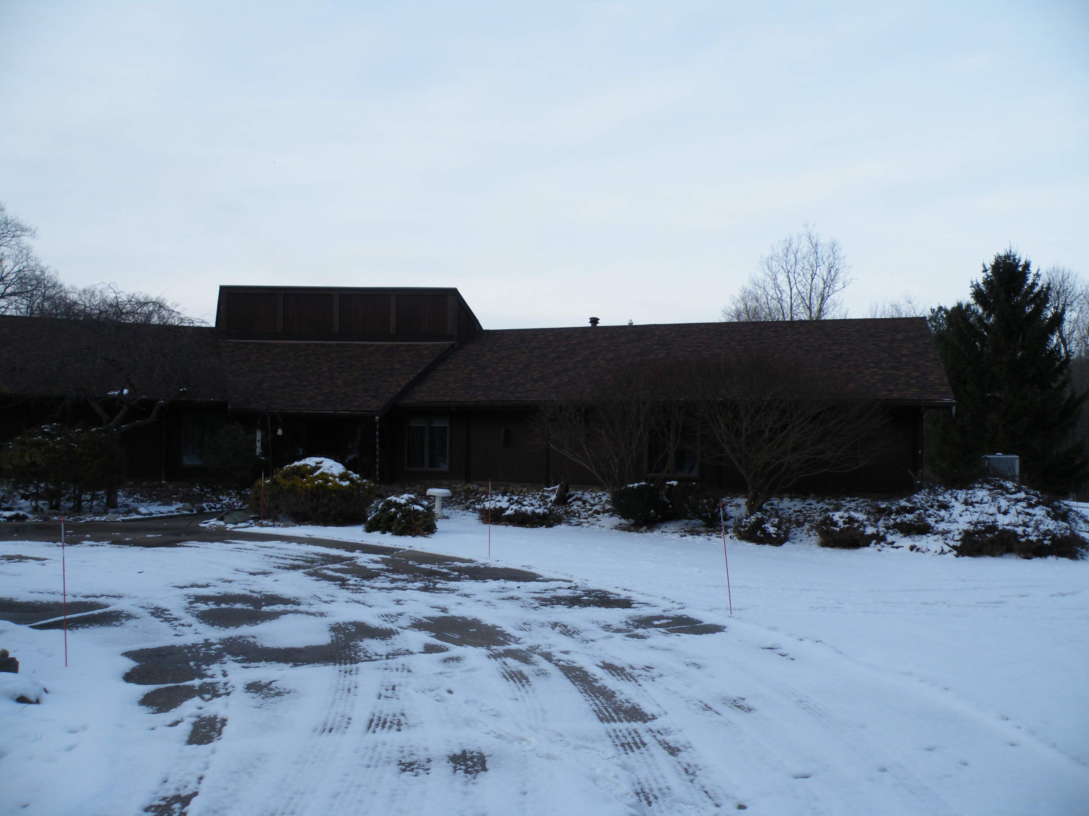

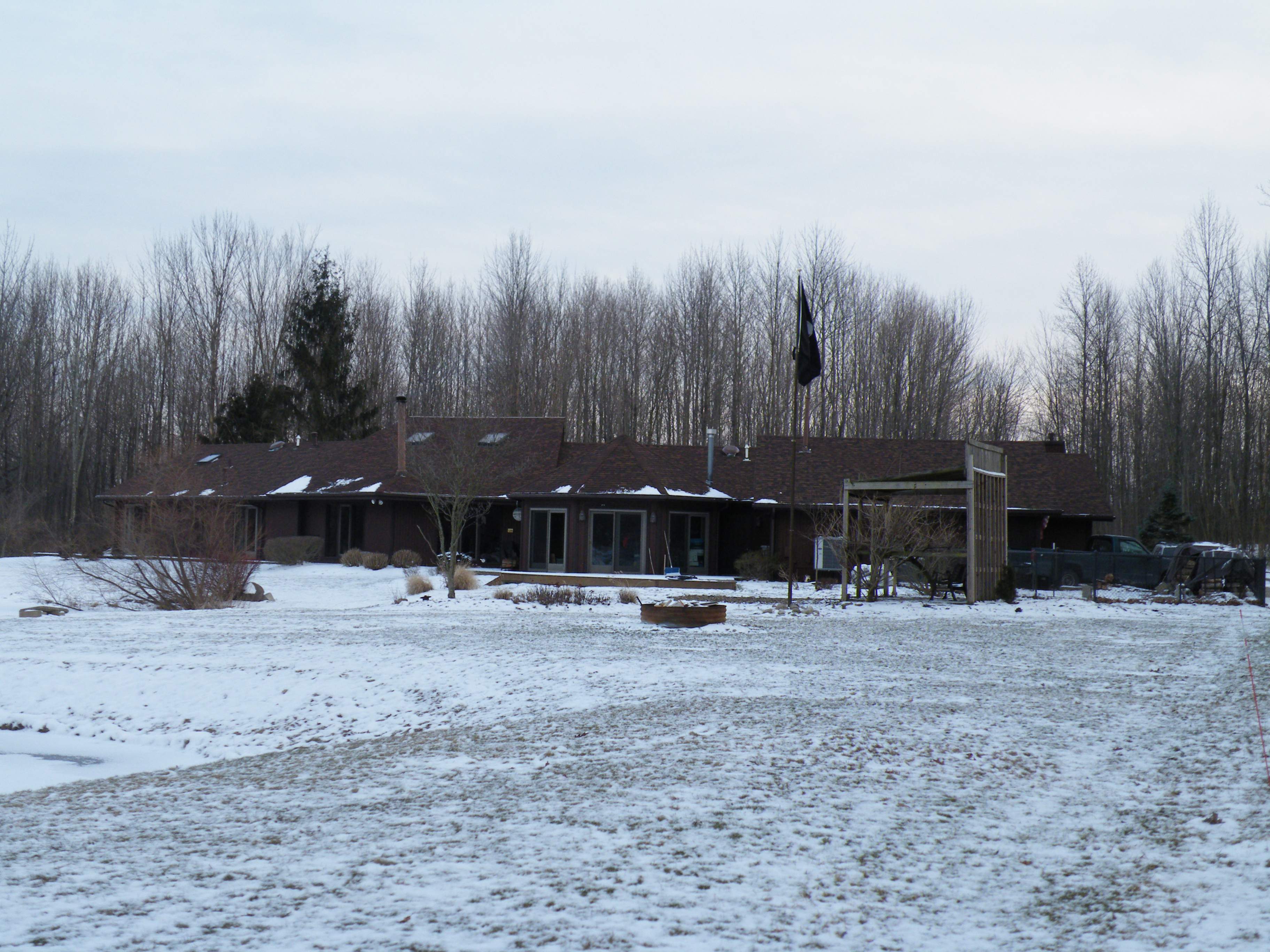

I admit that I have not read the entire thread - so - If things have already been mentioned - ignore them. I designed our home. Remember that everyone gets older and plan on handicap access for walkways (hallways) and bathrooms. Use ramps instead of stairs when it is possible - stairs should have low risers. More closets and cabinets than you think you will need. Garage is better than leaving equipment / vehicles outside - attached garage is best. Floor trusses instead of joists makes wiring and plumbing easy. We did hip roof so that there are no gables to take care of and wind to catch. I hate painting so our interior is all T&G walls and ceiling. Laundry on main floor.
