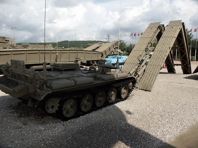

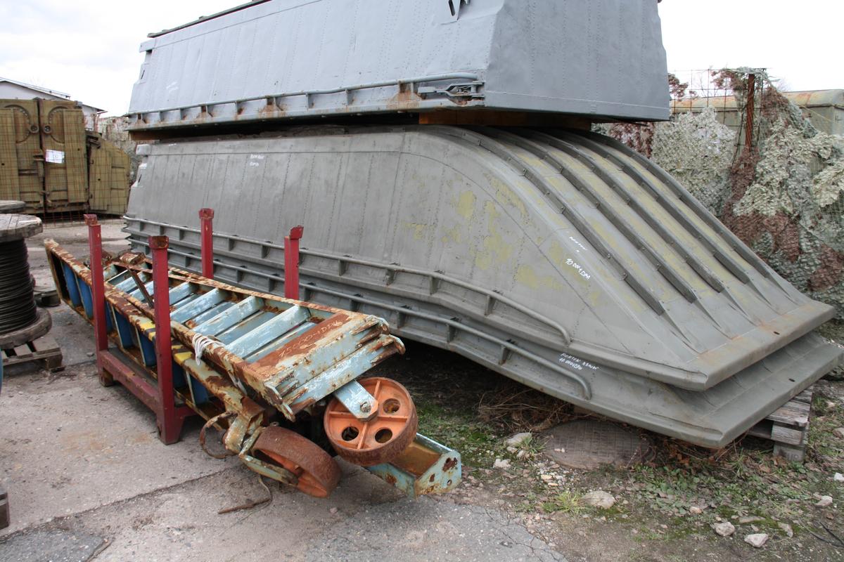

Did you explore the military surplus way? Maybe you need something like the second picture - mounted to your tractor:thumbsup:
The other picture is a military float used for bridges. They park them across the river side by side and lay the temporary road on top of it. Used ones you can find as a ferry boat on many rivers.

No such luck the milatary surplus places we have, are small shops with used amo boxes, boots and loads of junk or treasure depending on who is shopping.
Any idea How large those floats are or what they would have cost?

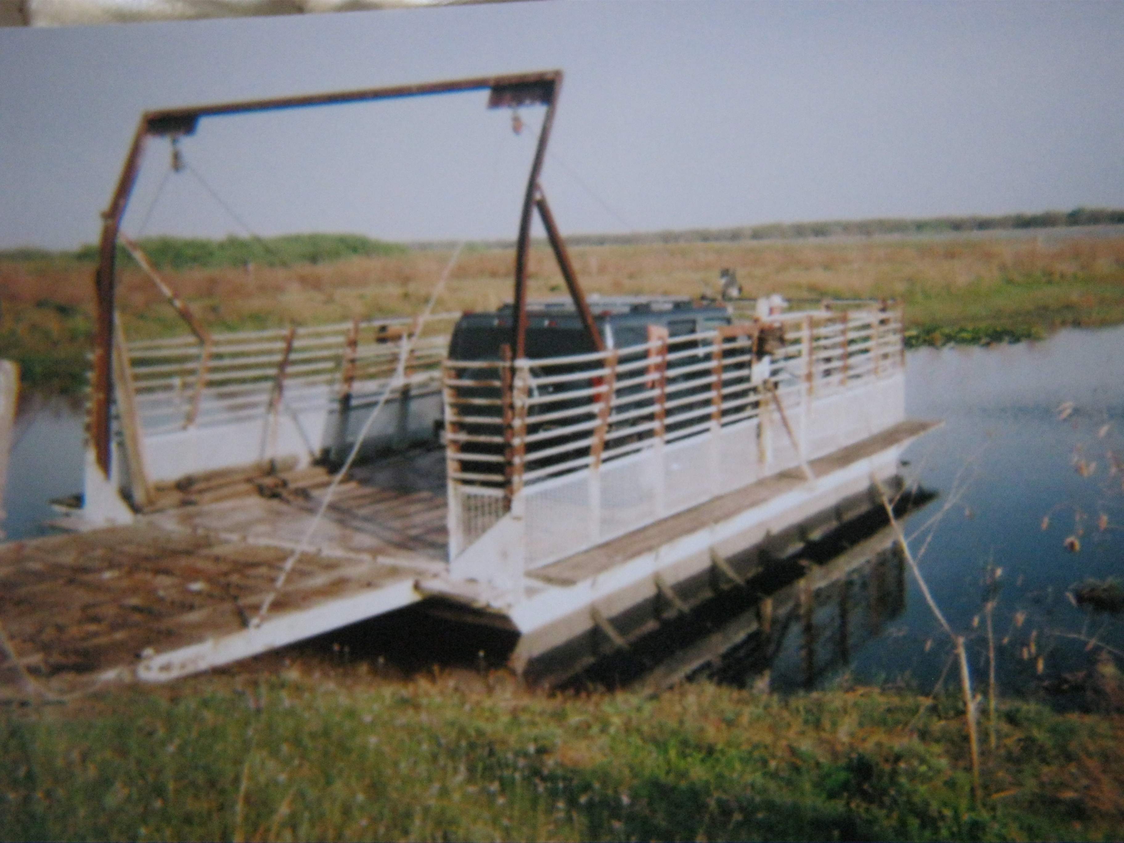

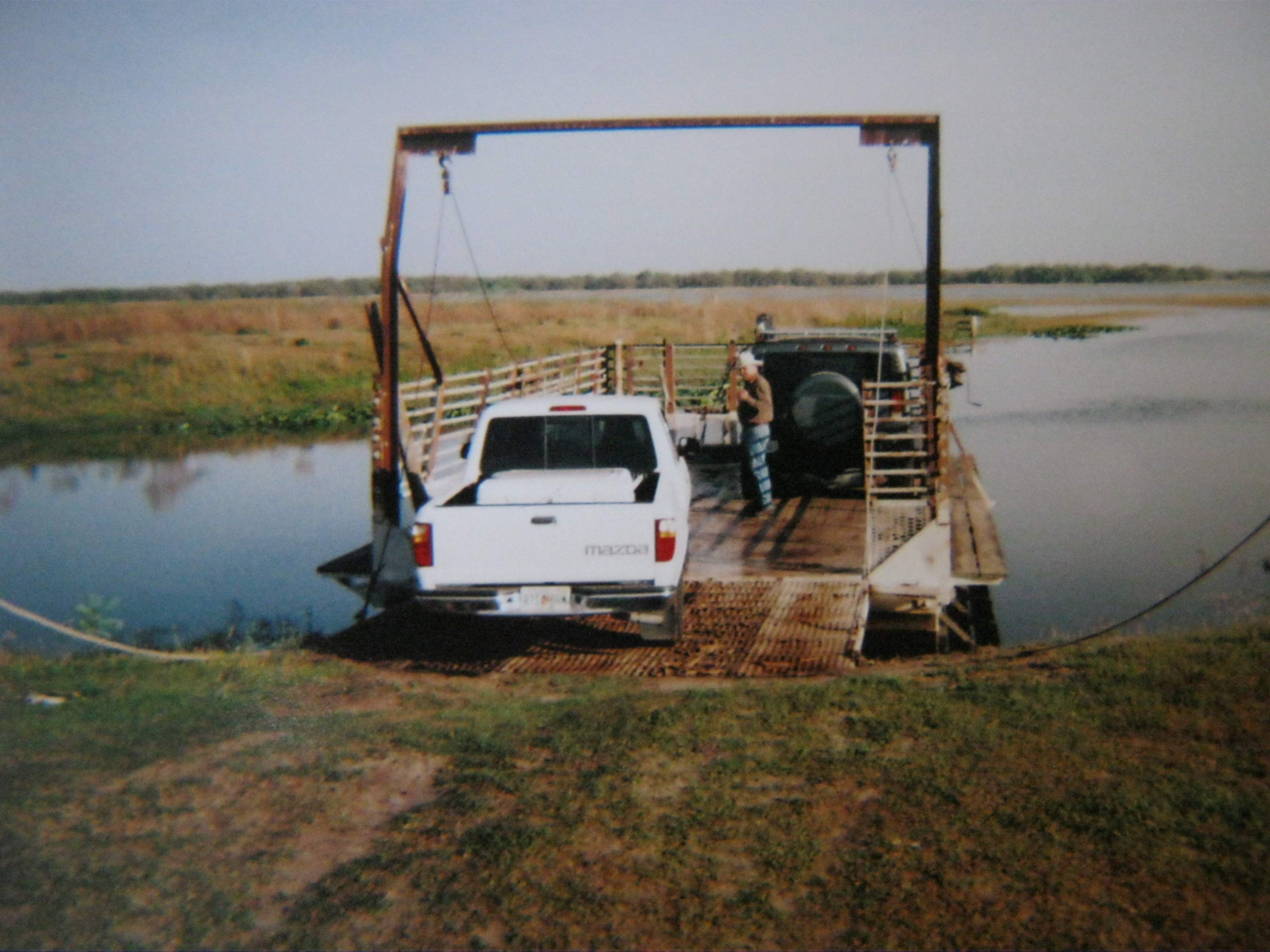

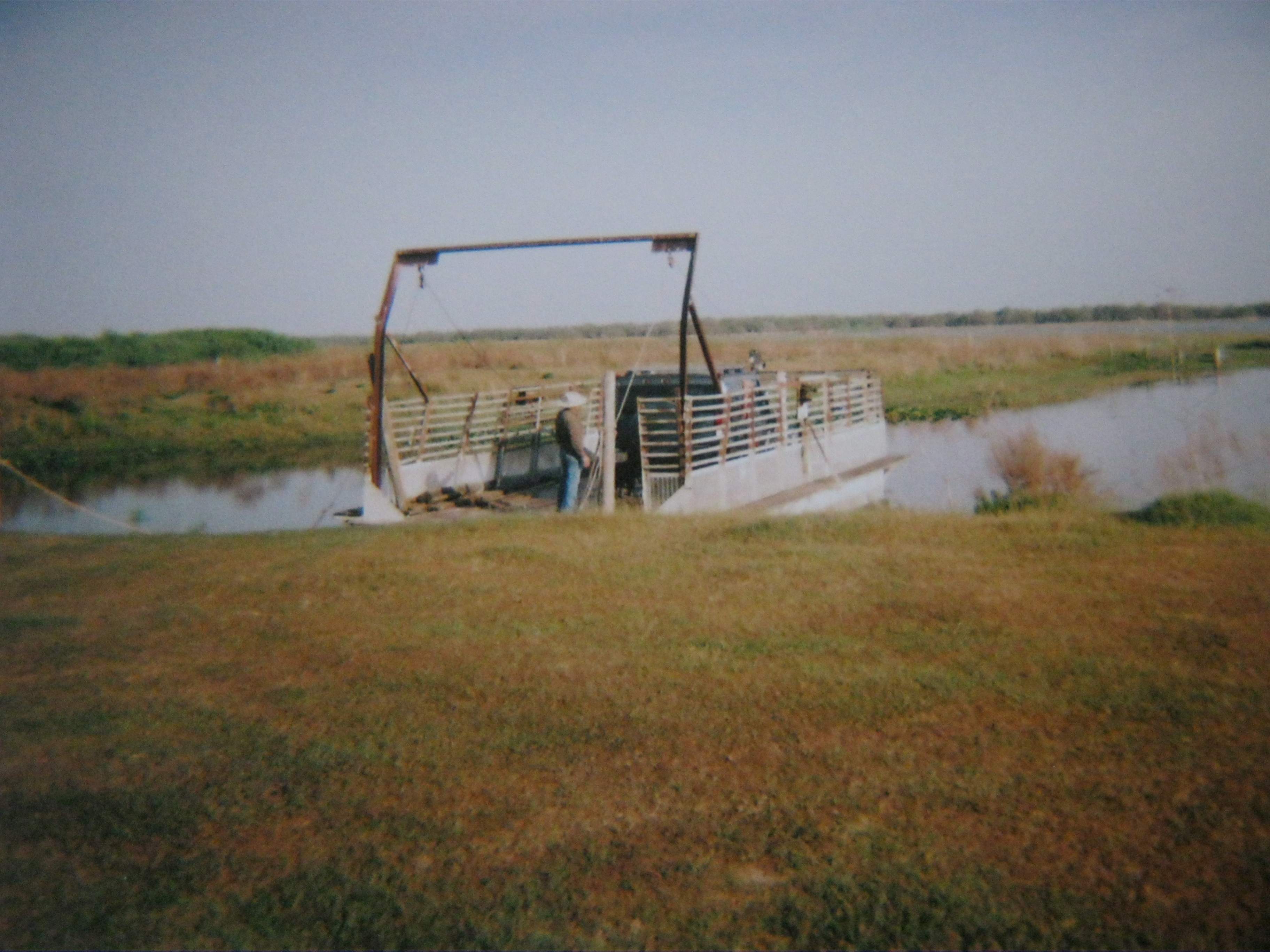

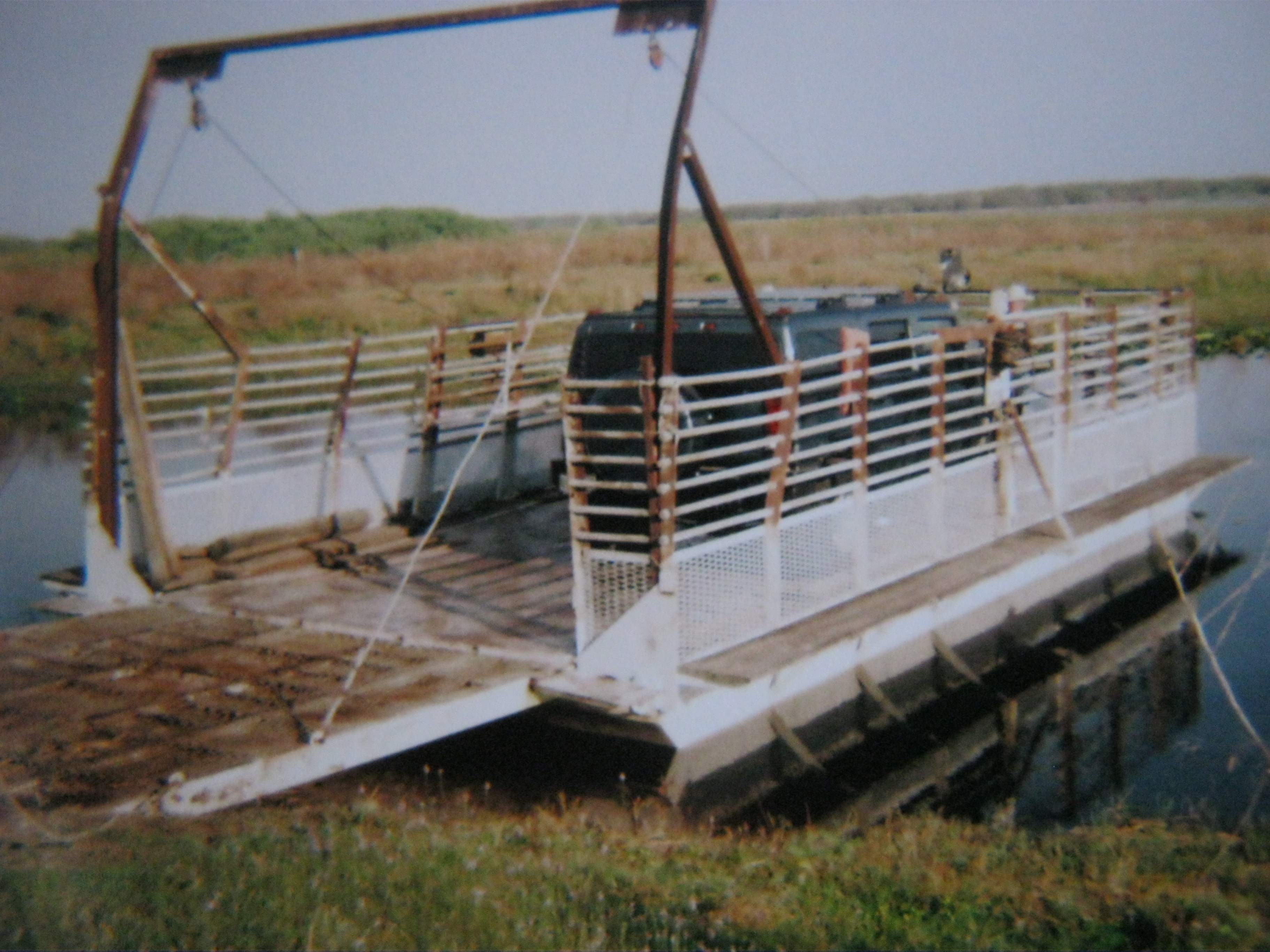

Can't tell you much about building a barge.Heres some pics of my buddys"cattle barge".In these pics,where loading a Hummer and Mazda PU. truck on there to hunt on the other side of lake.On occasion we would ask ourselves what we would do if barge flipped/sunk with equipment onboard. :(
Boone
Please excuse poor quality of pics.I took pics of pics with my Cannon A495.A little $120 camera which I highley recommend.

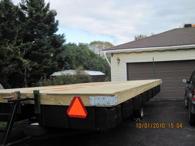

I will be constructing a barge, so I can move my Kioti CK27 back and forth from Cottage lot when I want rather than wait for the lake to ice over.
Has anyone built one yet? Tractor weights 5000Lbs, how overbuilt should it be, 10,000 Lbs?

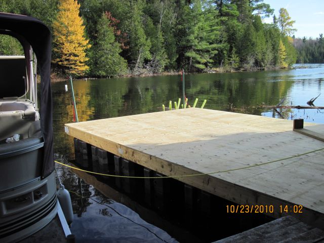

The lake I am on is Palmerston, closest town is Ompah Ontario, I now have my material so construction start probably tomorrow.:) Barge will be 12 feet by 24 feet, 2x8 construction plywood top.
Have considered stanchions from below deck to rest on the bottom, on the loading end only, to stabilize while loading? You would have to turn the barge around to unload.

Should have taken more pictures but batteries died, it barely sits in the water more like on top, about a inch into the water, top & floats weights 1800 to 2000 Lbs. leaving 10000 lbs. to carry loads, is as stable as a rock, will test in spring, 12' wide 24' long, drove it up on pontoon trailer, handled very well, lots of concentration to keep it on my side of the road, had to get a special permit. It will get a good workout in the spring.:thumbsup:
