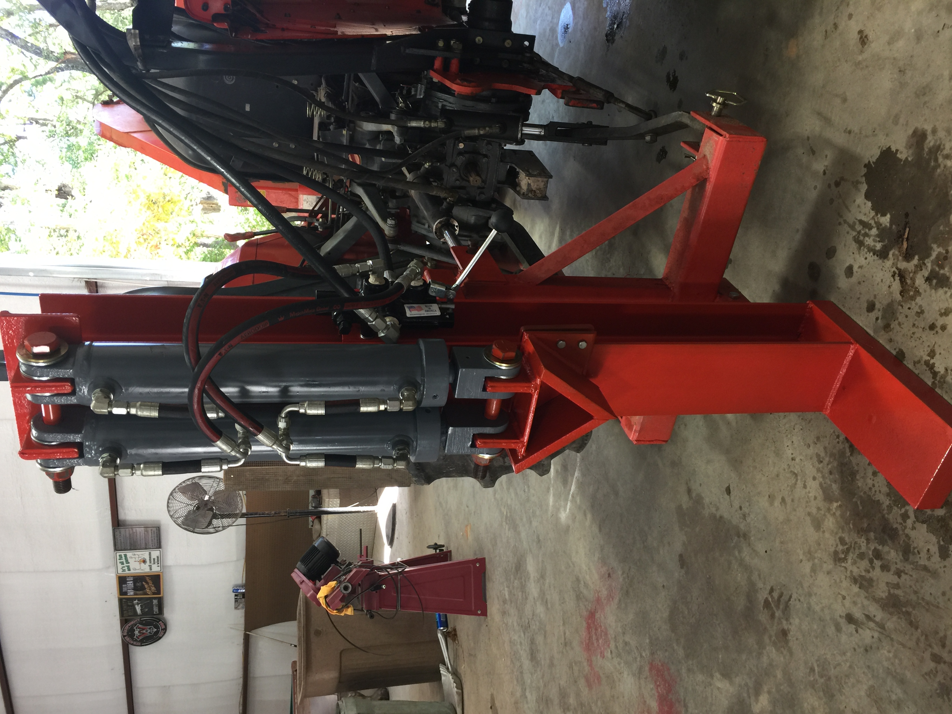

Nice job on your splitter. Here's one I built but my beam has issues. It's not heavy enough and twist. I've yet to find the time to fix it. IMG_0477.JPG

Store bought 24 t is likely a 4" cylinder. It stands to reason a pair of 3" cylinders would out preform

The plumbing bill make you wonder why you didn't just buy a cylinder?

Yea I was wondering how they got 25+ tons outta those box store splitters. Finally put this one to the test on some really nasty logs. Outdid my buddy's store bought 24 ton.
I was wondering that too. How do they come up with those numbers? I saw one advertised as 35 ton!
A 5" cylinder with 3600 psi will get you to 35 ton.
The 40 ton splitter that TSC sells says 3800 psi but doesn't state the cylinder diameter. It would need to be about 5.2" to make the 40 ton claim accurate.

My splitter is a 42 ton, 6"x30" cylinder. I'm very spoiled. :eek:

What kind of wedge are you pushing? I briefly considered putting a massive cylinder that was like a 10" bore on my splitter, but for a bunch of obvious reasons I didn't.
I push a flat plate. Wedge is at the beam end. Split the wood away from the cylinder. In my simple world that just makes sense. My wedge is a 2-way, 4way hydraulically raised/lowered.
