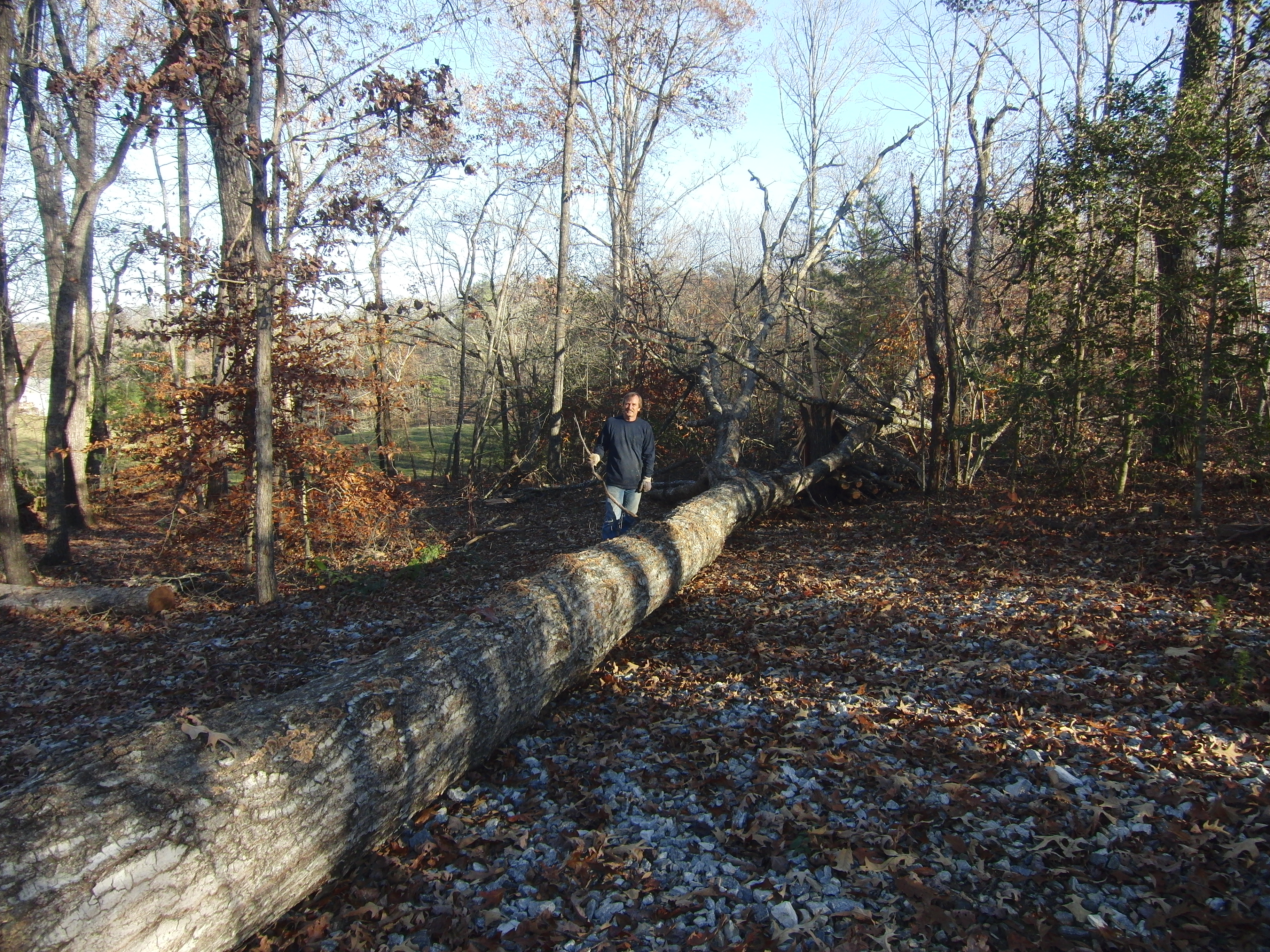

/ Built me a log splitter. #44
This is not typical but one that I had on my property that needed to be removed. 6 tree down.JPG
most will be smaller.

This is not typical but one that I had on my property that needed to be removed. View attachment 524711
Shame to cut that into firewood...

That is a big tree, could get some nice planks out of that, but the background does not look like Florida to me, looks like North East, like my back yard, guess red oak grows everywhere.

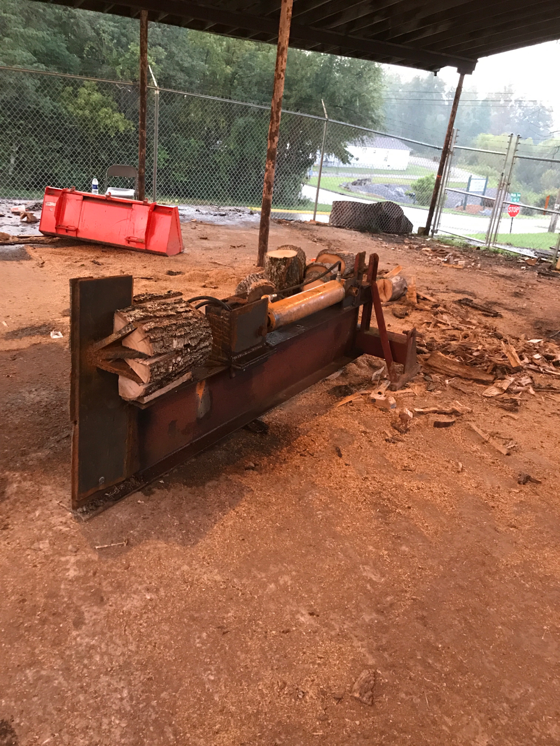

/ Built me a log splitter. #48
Store bought 24 t is likely a 4" cylinder. It stands to reason a pair of 3" cylinders would out preform
Splitting force is proportional to the square of the radius of the cylinder. Therefore, at the same pressure, a 4" cylinder will have almost 1.8 times the splitting power of two 3" cylinders.

/ Built me a log splitter. #50
Better double check your math.
Show your work if that helps;)
/ Built me a log splitter. #51
Yep - I blew that one. I compared a 4" cylinder to a SINGLE 3" cylinder. In that case, a 4" is 1.777 time what a 3" would be.
TWO 3" cylinders would be 12.5% more force than a single 4"

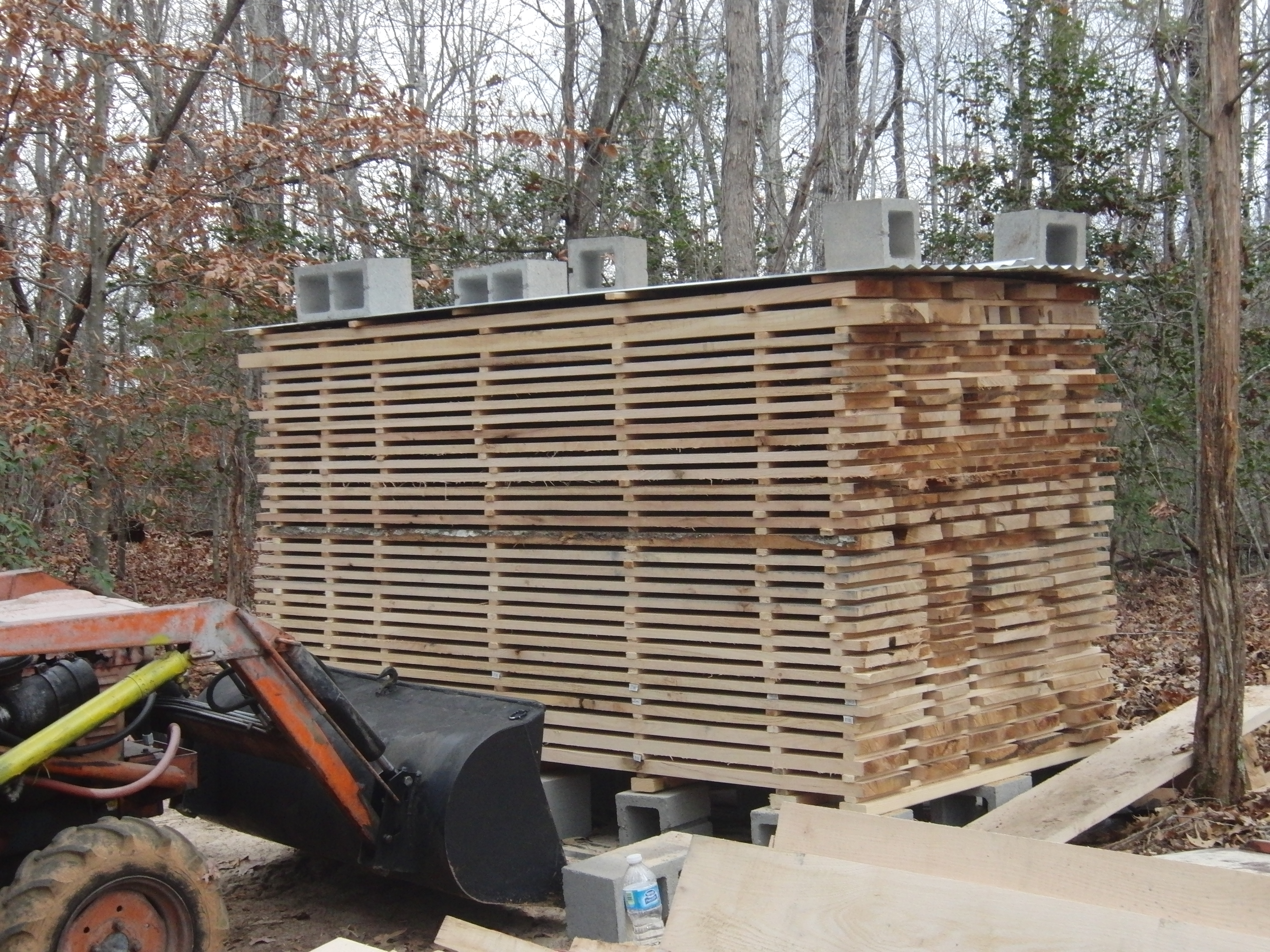

That downed tree was just an example. It and another were cut into lengths. I had a portable BSM cut it up.
