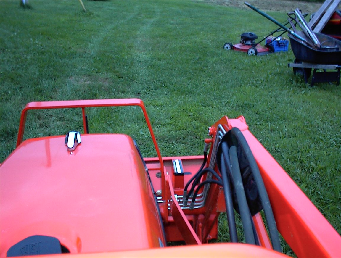

I have an idea of a simple visual level... the Kubotas use a flat surface (flat stock) welded to the top to show you what level is - the problem is that you have to view it from an angle. It would be very simple to attach a short piece of flat, or pipe, that is angled towards the drivers seat (eye level). If you can see along the flat, or through the pipe, then the bucket is level relative to the tractor. Similar to sighting a shotgun.
This is not perfect either but it might be more effective than the existing (or in my case non-existing) system. The perfect solution is to mount a camera about 8 feet outboard of your machine and use and LCD but that might cause other problems.:D

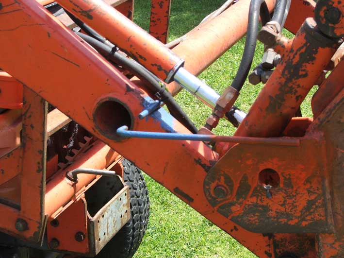

Heres mine. About as simple as it gets. When the two blue pieces line up, its level. When the loader is raised I can view it easily from my seat so i can level the bucket before I drop it to the ground. If the bucket is already on the ground I have to lean out the side to see it but its still much easier than trying to judge by viewing the bucket alone.

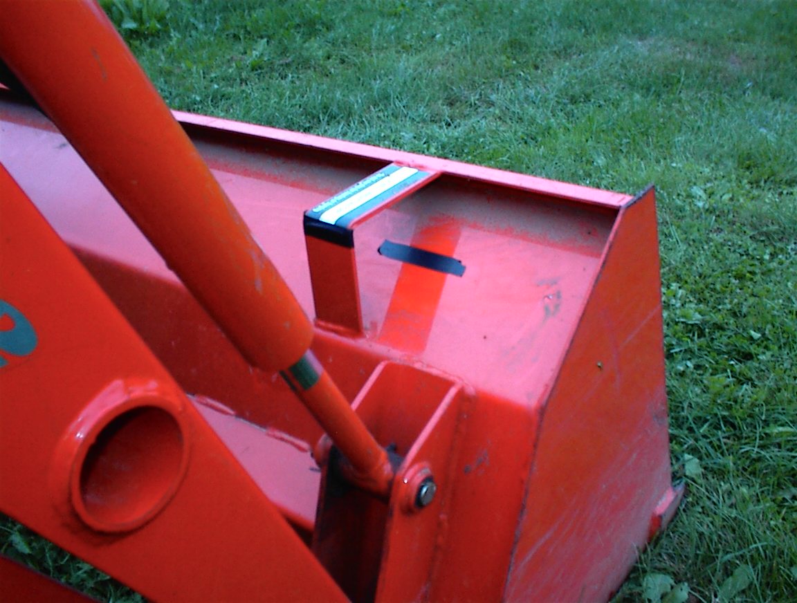

I have a kubota with the flat stock on top of the bucket and it's pretty useless. I really liked Mikes idea with the pipe so I went outside to see how to stick it on to try. And when looking at it, I thought the shotgun sights might be easier. Then I decided to use a piece of black tape to see how it would work. I placed the tractor on the driveway and leveled the bucket. I placed a piece of tape on the upright holding the 'level indicating' flat stock and another on the bucket so when sitting in the seat the two pieces of tape line up. It took a couple of tries to get it right, but now when the bucket is level it looks like one piece of tape. I'm going to leave it a while and if it works as good as it did while testing it in the yard, I'll paint a line on the bucket or something more permanant. I know it will only work when the bucket is down and only for me, but that's all I'm interested in.
