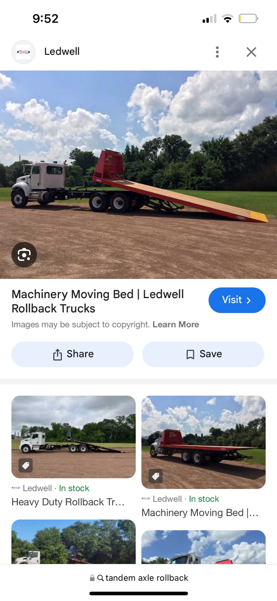

I never pretended to be bright but I have yet to ever see a roll back strong enough to carry even the smallest of bulldozers. Maybe its time to wire all trucks with wifi cameras that can be reviewed by insurers from time to time.
   / Bulldozer comes off of trailer, kills 2 #73
They make some heavy duty rollbacks. One like this could easily carry a smaller size track loaders. I’d put my D3 dozer on a heavy spec single axel rollback.
