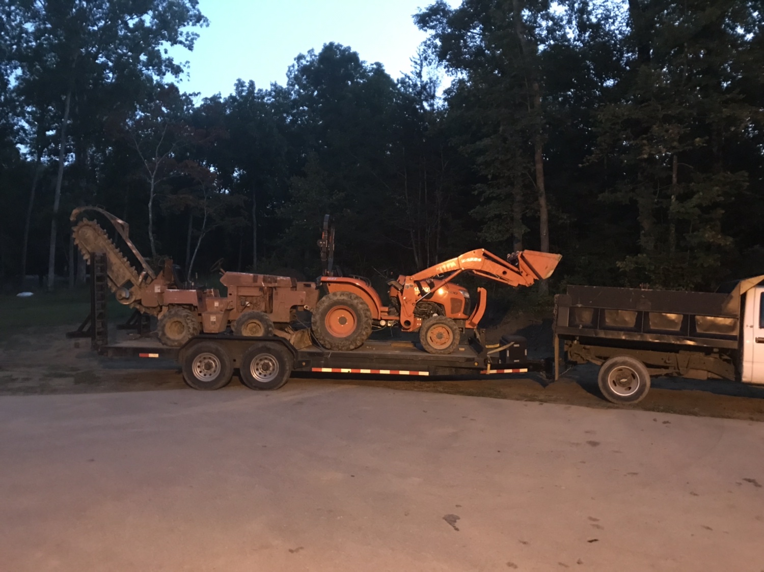

That’s exactly my feelings. I hate that roll. I pulled a 16” covered trailer about 100 miles with a 2016 half ton and it just sucked. Even my 2500 suburban that’s really like a 5/8 ton is much better. Compared to a 90s ton there’s no comparison. IMG_9109.JPG

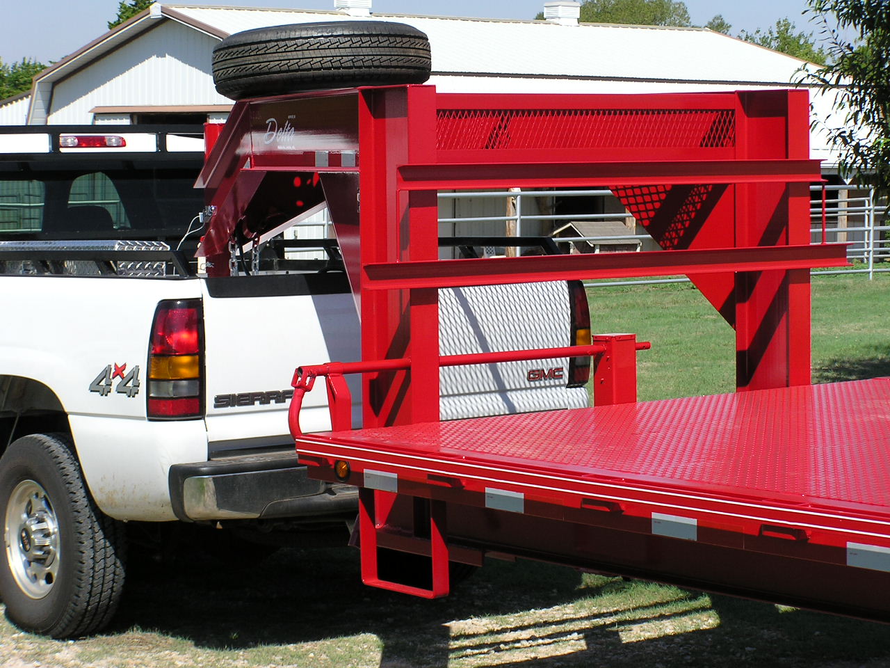

Thanks for all of the opinions so far on this, I agree a 1/2 ton with a goose neck is not a common sight but I'm trying to plan for future needs with this one. I will still have my 16' 7k trailer to use for light stuff.
I did stop and look at the gooseneck and right now am leaning that way. I want to give it another couple days to think more about it though. one thought I have is if I don't like the goose neck I think it would be easier to sell a 24' gooseneck vs. a 24' bumper pull. used trailers I have looked at are not very far off of new if they are not worn completely out.

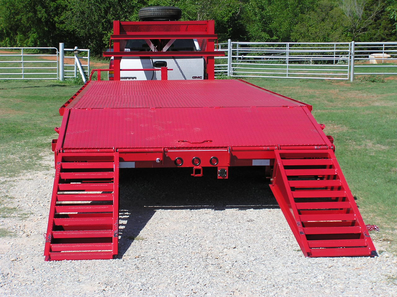

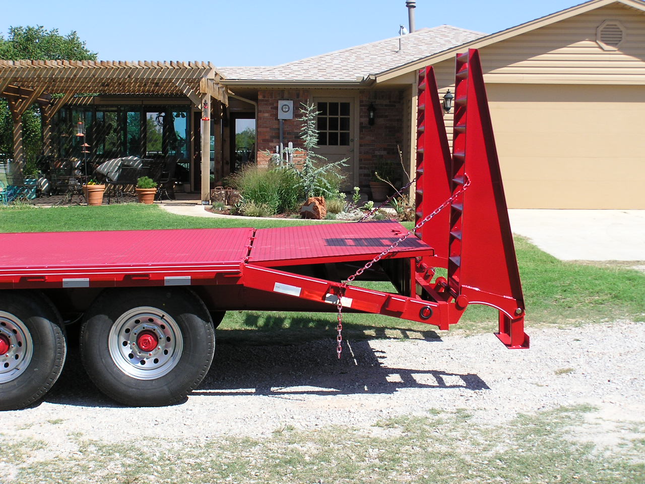

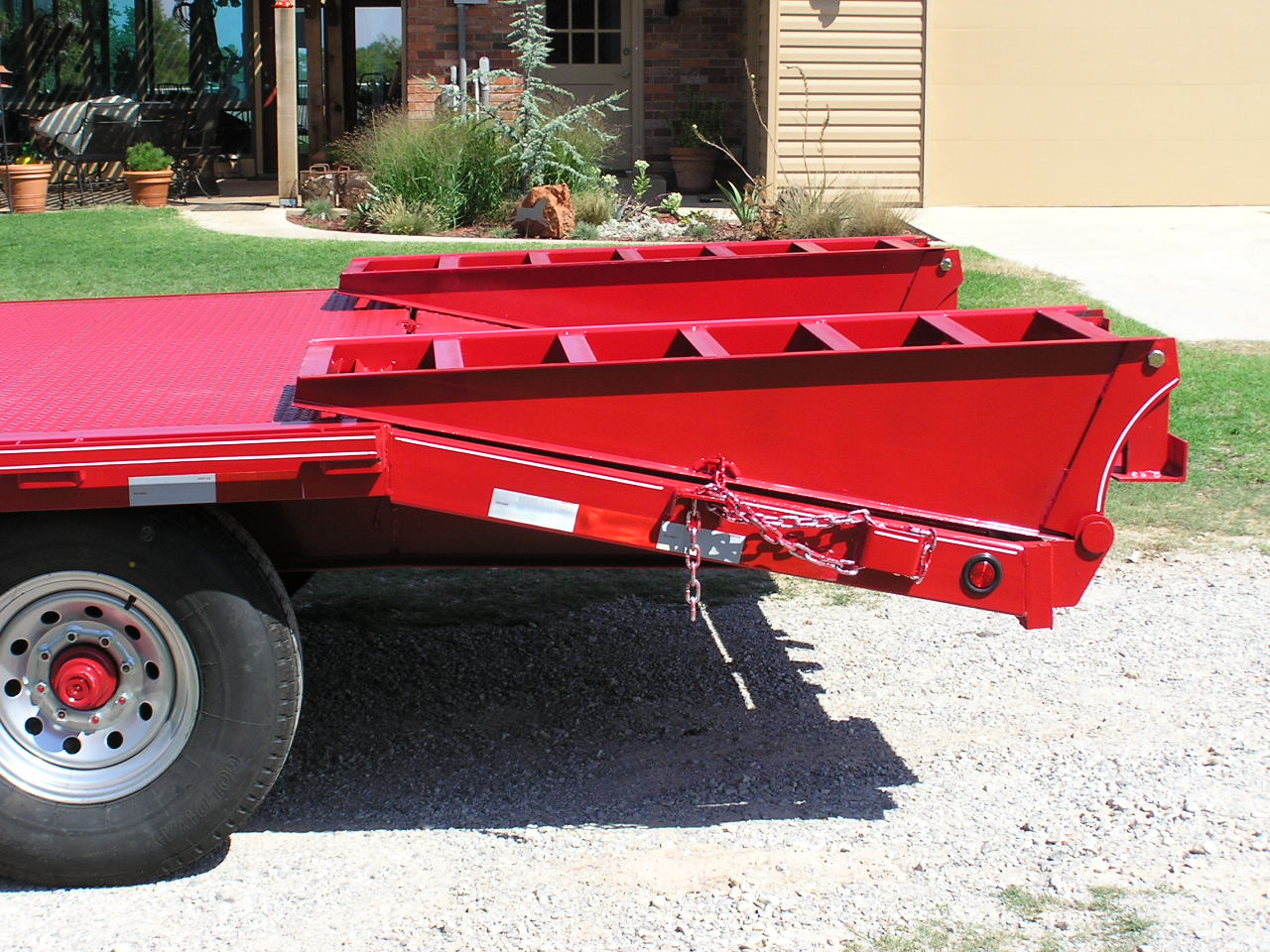

Look for two spring loaded jacks, three fold up mega spring loaded ramps, and brakes on axles. Three ramps allow for tricycle tractors or UTV/ATVs. The mega ramps fold up flat and make the dove tail part useable like to set a implement on it needed. Mega is what some folks call them IDK about where you are.

Since you are in Arkansas, check Delta: Equipment trailers from Delta — Single Wheel Flatbeds
Ordered mine in 2006 and drove to the factory to pick it up:
