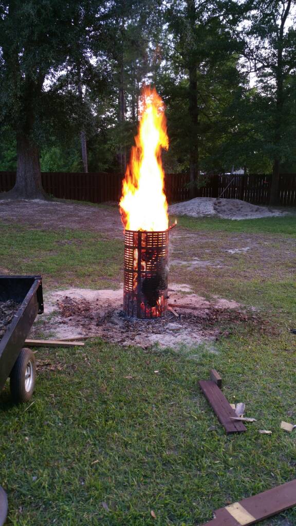

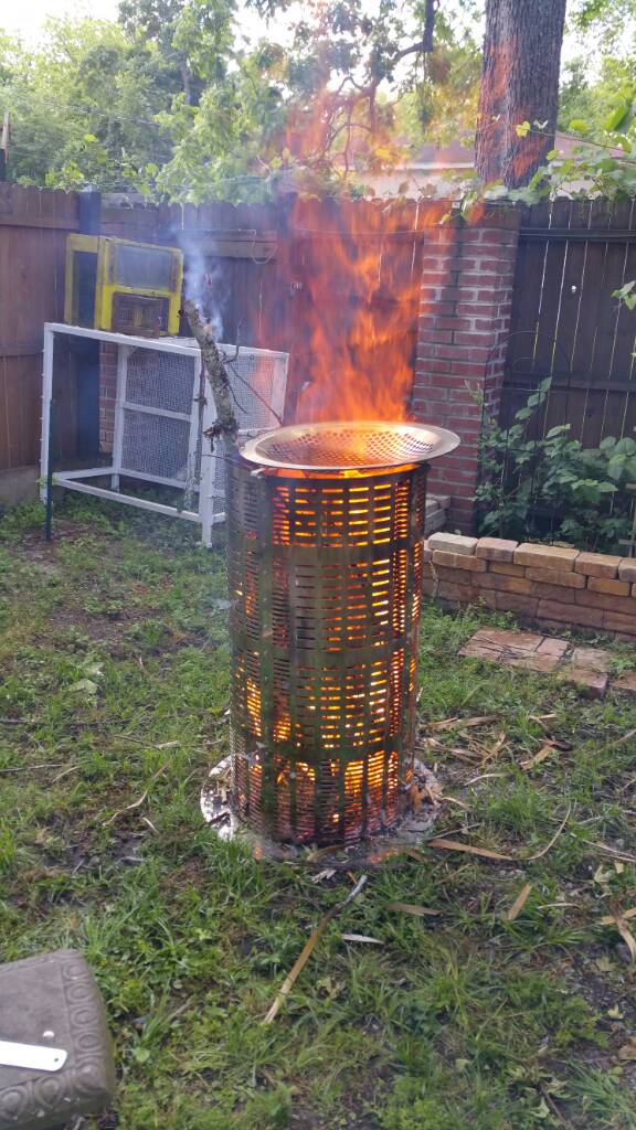

So, Paul, you're using a 'vortex' or 'cyclone' type.
I'm leaning towards this type of design as, for my purposes, the barrel will be used only for tree limb/twig disposal. Perhaps some leaves.
I learnt a new (to me) term in my research; Hardware Cloth. Which I would've simply referred to as a metal 'mesh'. Anyway, it's constantly recommended as a spark-arresting top/lid.
I wouldn't think hardware cloth would last very long with a well designed barrel. Probably burn out in less than one season. Expanded metal mesh wouild be a better choice.

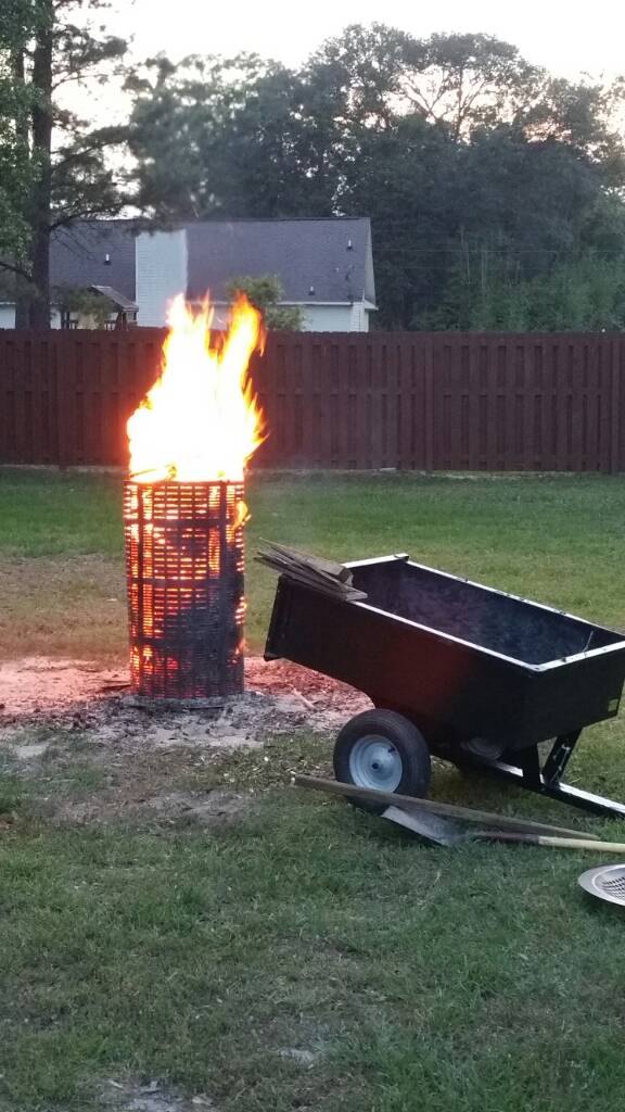

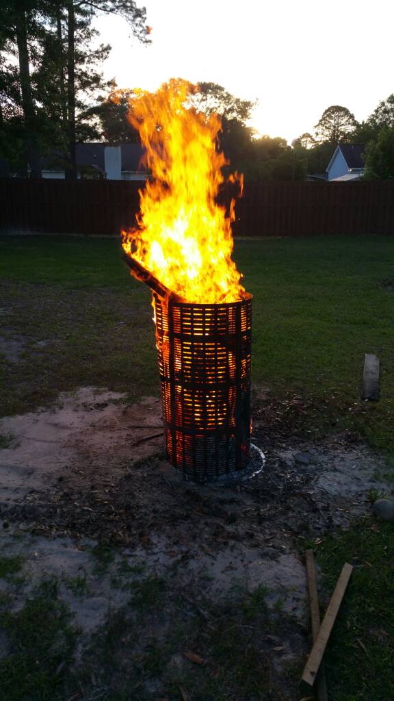

I understand what you're saying, Mate. :) But the thread title is/was about designs... and joefromga did offer a design. I think that Bird was describing a similar design too, referred to as a 'cage' type.
That being said, I got my 55 gallon drum for free so I'll use what I've got.
