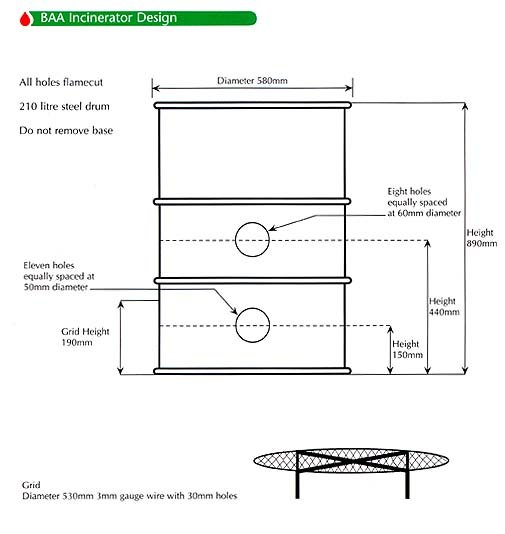

The plans in post 13 call for 50mm and 60mm holes in the barrel, but I can't find any store with that size ammunition or guns.
Bruce
They are around, but hard to come by recently.
They are usually mounted on tracked armored vehicles or towed designs.
Also putting the newspapers or wood inside to keep the projectiles from going thru both sides is just not going to work effectively..:)
Would the German 88mm be too large of a hole?:laughing:
Bruce
Ha... just take better aim with your small caliber delivery mechanism to open up the existing hole. :D
