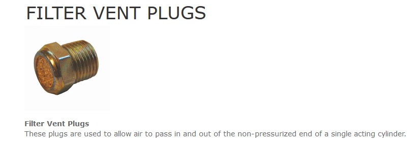

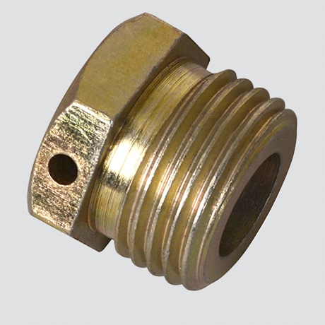

not real clear on the terminology but its the silver hex screw at the top of the cylinder, it has a weep hole in it where the fluid sprayed out which is what led to me replacing the cylinder.
It looks to me like someone made a home made vent plug for your cylinder.
You need to buy a proper vent which is made from bronze crystals sintered together.
They allow air to move in and out but stop the dirt.
The solid plug with a hole drilled in it may have created a partial vacuum as the cylinder retracted and sucked some fluid past the seals as they aged.

The plug he has is also a filter vent plug, I have several of those type on cylinders and gear boxes.the hole is in the side of the plug so you can turn it down away from moisture.
   / Bush hog 2615 legacy bat wind hydraulic cylinder help
#15
It痴 not homemade, that cylinder is the original.
I bought a new cylinder to replace that one and the new one did not come with a plug so I値l be using that plug in the new cylinder.
