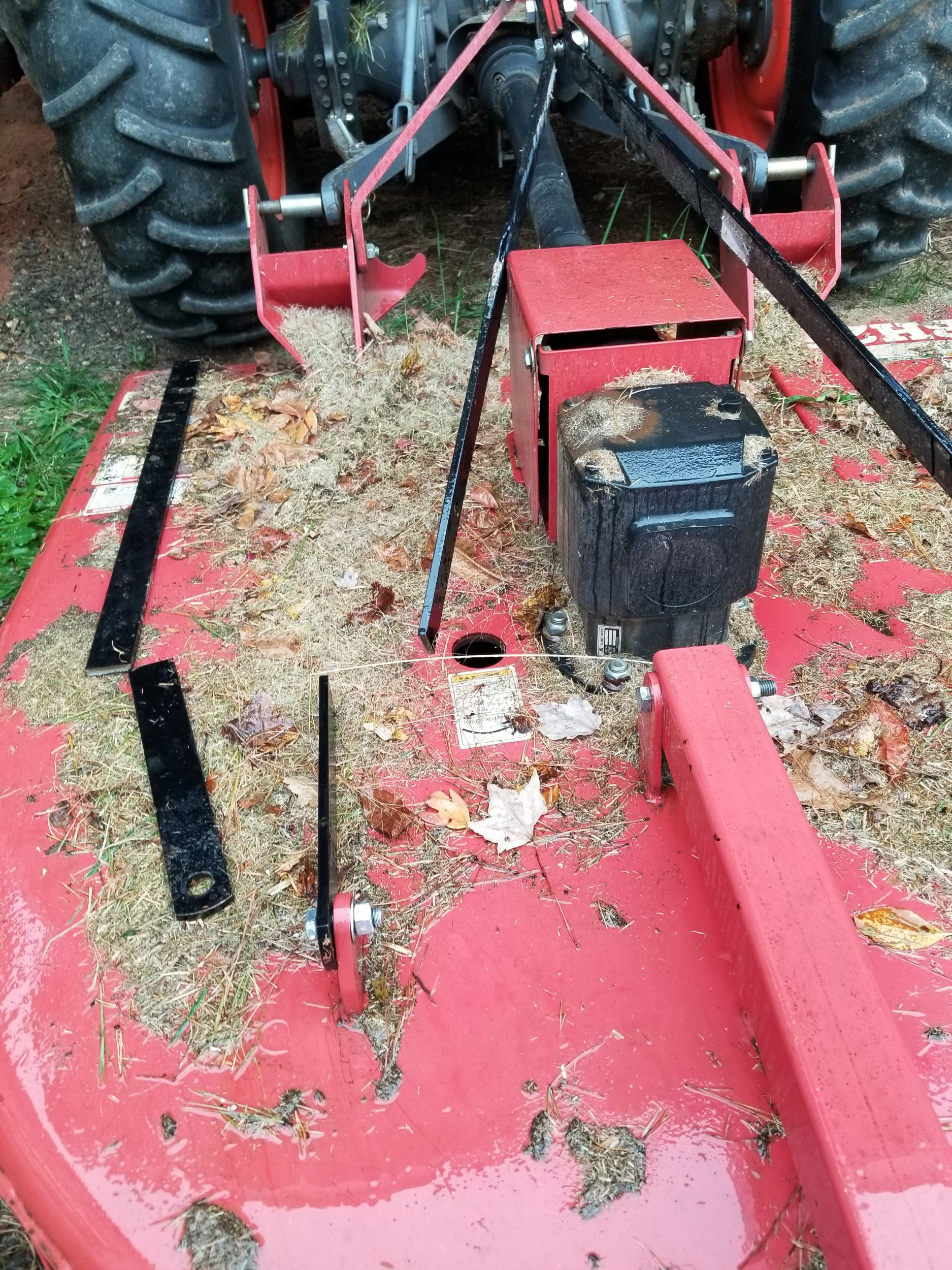

Could you show a pic of BOTH bars ( the broken 1 AND the intact 1) on the machine on the BH please? The photo cuts of the intact bar.
/ Bush Hog BH25 yokes breaking
#22
I'll get back over there in the next couple days and take a couple more pics.

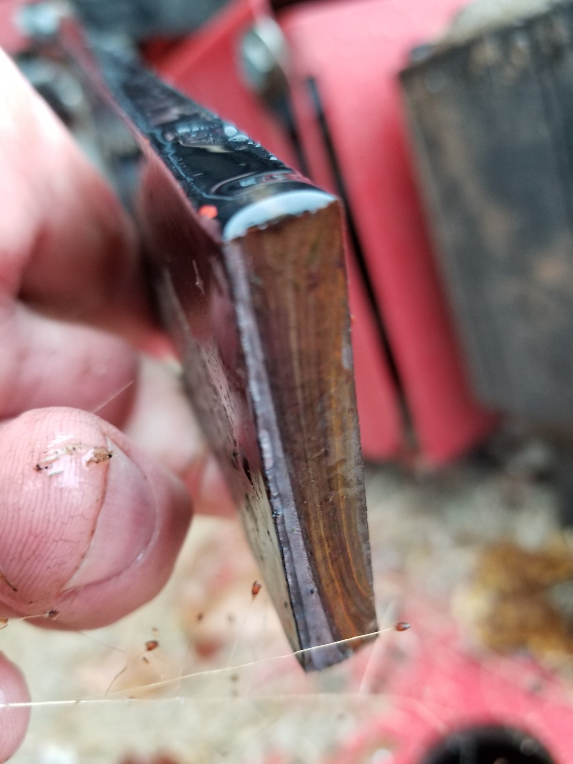

Ok, good to know they at least look correct.
I'm not sure why they would be "hardened" I would think it might make them more brittle.
Looking at where the break is and trying to compare to the picture it looks like the "bend" is further back or closer the mounting point in the picture I found.
May not be, hard to tell!

IMHO the 3 pt center linkage on mower isn't pivoting as designed. My 1st guess is bolt with nut in photo too tight & preventing any designed pivoting of hitch components. Please post a complete view of mower top link attachment to confirm

I take care of some equipment for my neighbor, fixing broken things and maintenance. He has a BH25 that has broken the yoke bars a number of times and I was trying to figure out why and it seems a manufacturing defect. Where they stamp the bend at the factory it seems its somewhat shearing the steel. 3 of them have broken this summer. This last one only made a couple laps around the field. So I investigated the break a little closer and can see there isn't much metal left to break.
Anyone else had/have this issue?
The pics of the broken ends are two different yoke arms.

Got over there this morning to look it over again. I don't see anything wrong with the set up. The top link has the right amount of play and moves freely. The bolts holding the bars are loose enough to provide free travel. The main yoke that attaches to the top link swivels freely. Nothing wrong. Here's a few pics.
The one pic is of the other bar that's not broke and a close up looks like a crack in the paint right at the bend line.
Hes picking up new bars today and taking the broken ones in with him. They already said in the past they won't do anything but they asked him to bring them in for "inspection".
Personally I would just go with chains. It was my thought before even asking here. But he's not real keen on the idea. If he brings the broken bars back I'm going to gusset and weld them.
