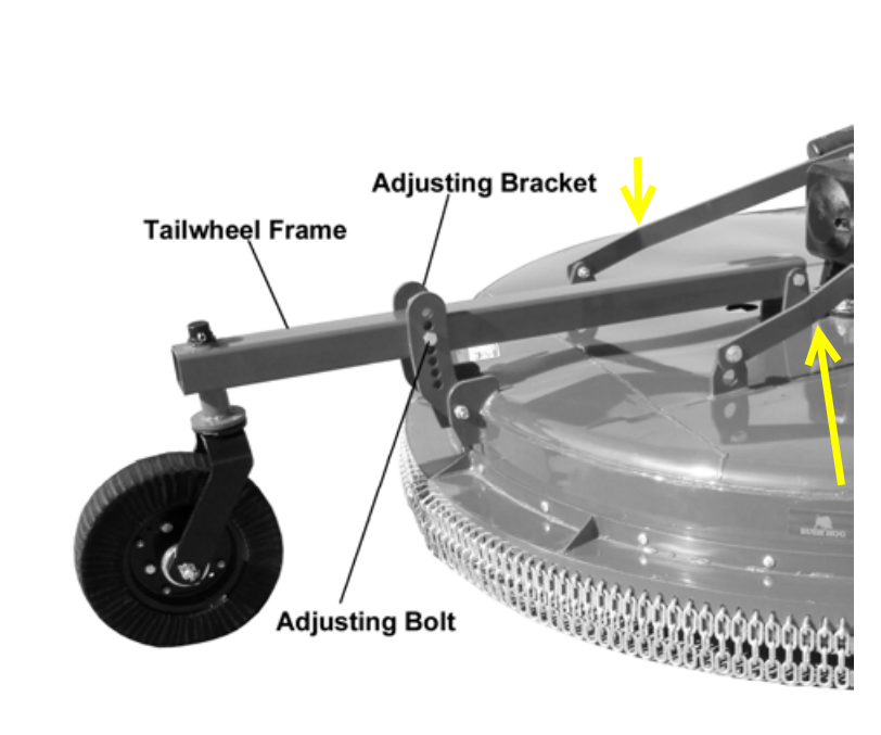

There are no torch marks. Nothing has been modified or shortened. When that link is in the resting position, everything is in direct alignment. When upward pressure is applied to the tail wheel the ramp is forced upward by the rear bolt that has a bushing on it.

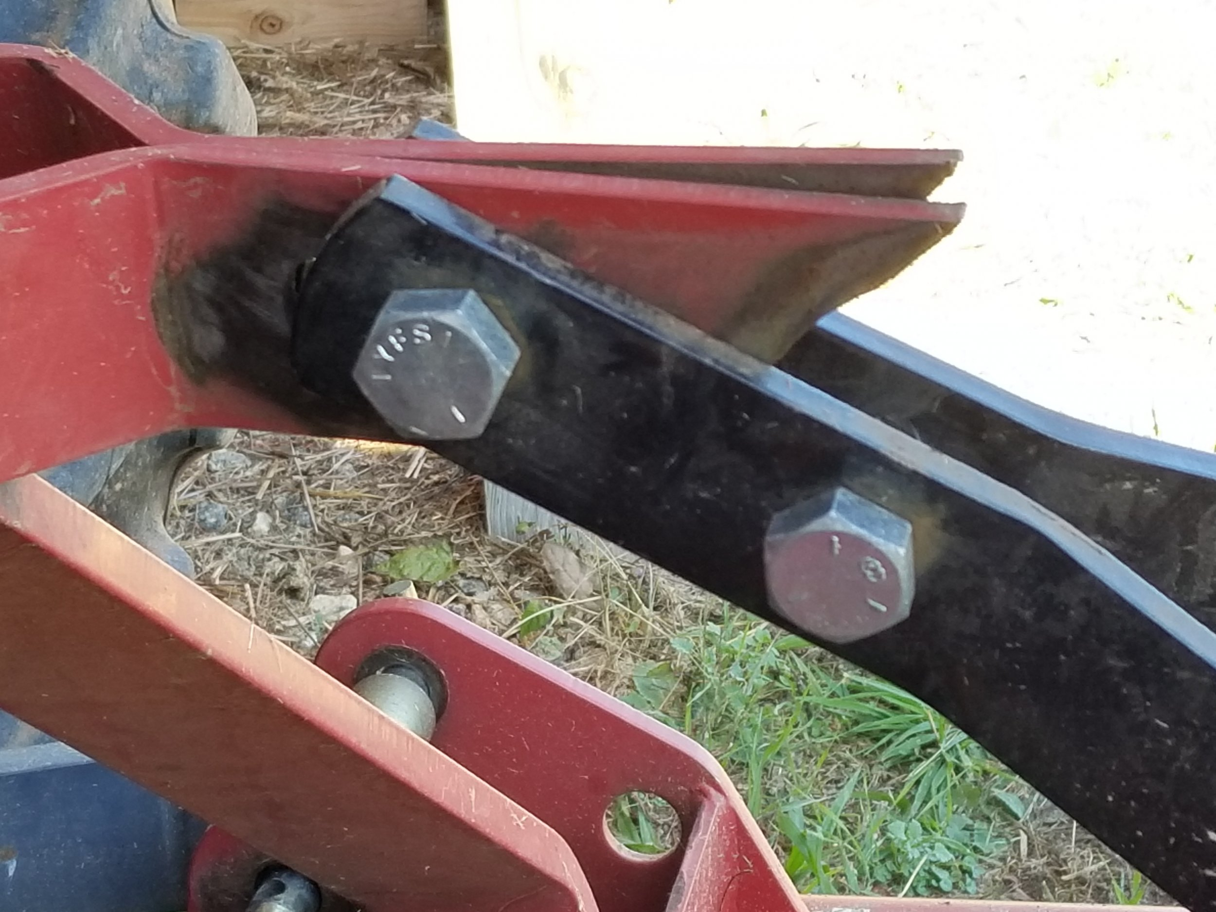

So this picture you provided
on the red link above, it looks like part is broken to the right.
If that part had another bolt hole for the black link to bolt through, then there would be zero flex in the system, so I'm ruling that out.
Instead, that part was longer to block the flex motion (keeping the black link below the red link) causing the black link's rotation upwards to force the red link upwards as well.
Now, with the part broken like that, the black link may be able to flex upwards enough, such that the black link is in line with the red link, whereupon there would be no tendency for the red link to rotate, and instead all of the force of the upward riding cutter would go straight through the links to the attaching bolts, and something gives.

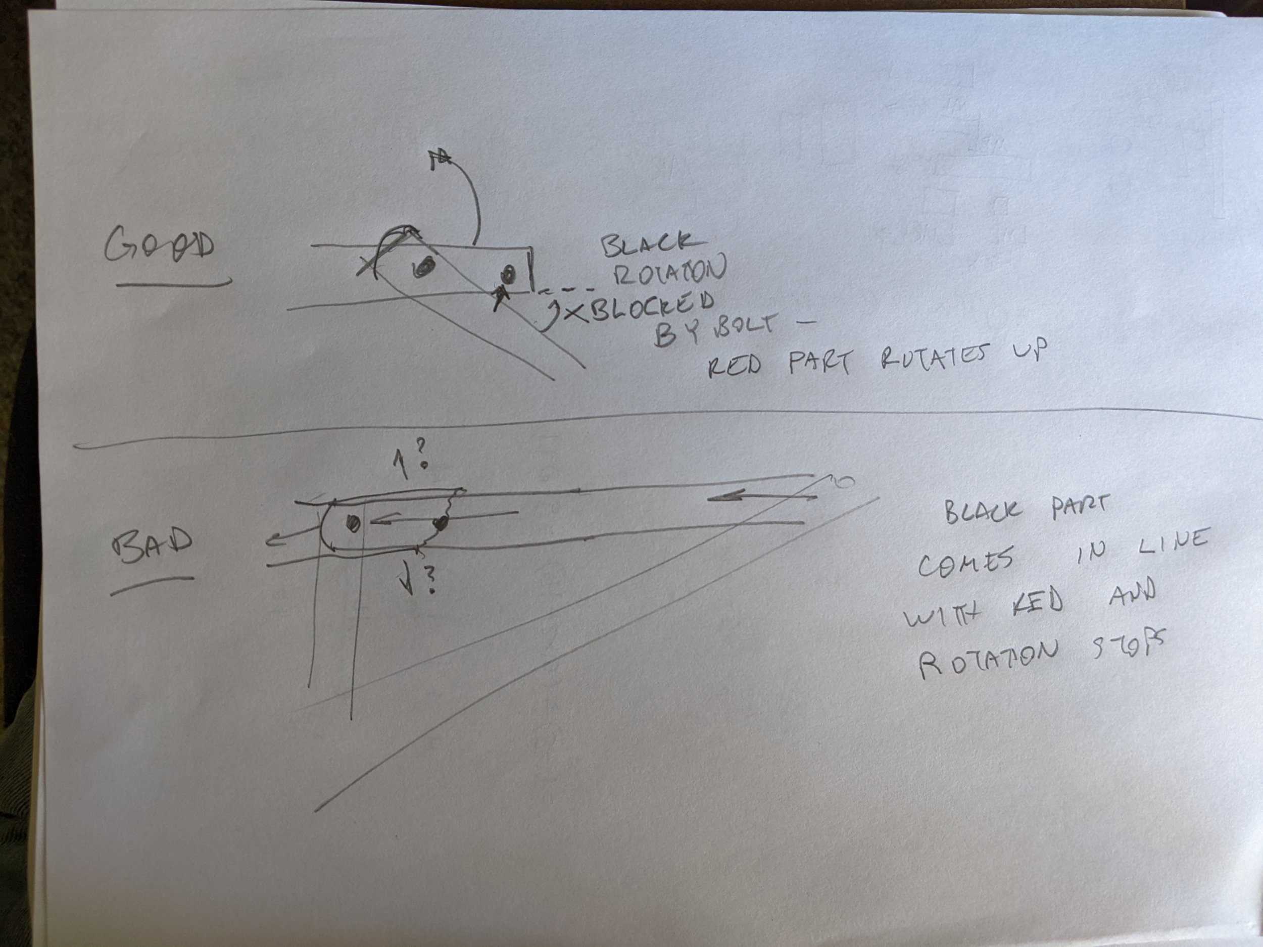

If you'll excuse poorly-drawn scrawl on paper I've tried to illustrate this:
If the red link was better lubed, the red link may continue rotating with the black link and nothing bad may happen, but if the red link doesn't readily move then the black link more easily "catches up" with the red link and comes in line with it, causing the linear compression.

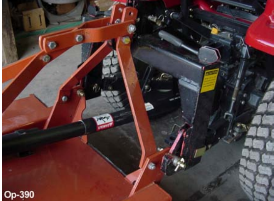

In fact I just found a picture from this manual :
Here you can see that the black links on the mower in question (orange & leading to the lower left in this pic) are supposed to be inside that upper link, and that upper link is supposed to be longer and have a bolt through... which will do what I described above.
Some of the pictures in that manual show the main triangle having 3 bolt holes; if this one's got 3, the flex link should be in the middle hole to allow more flexion.
Fix the flex link, and it'll work within a reasonable range of motion.
Or, leave it how it is, and use chains instead of the black links.
Either way, I'm with BH and the dealer on this one; operator error (in this case, a failed fix) caused those arms to break.

Ning -- lots of good effort to explain but I disagree in a couple of places. First the photos you show from a manual or wherever are NOT of a BH25, that is some less heavy duty hog. Current pics of the BH25 do show the flex link/clevis halves on the inside and the straps on the outside just as the OP shows. I see you caught that too by your post #55. Second the OP will have to confirm but I do NOT see anything broken about the flex link/clevis. Some wear yes, broken no.
Also my studying of that linkage says there is no possibility of the black and red metal coming into straight alignment for compression. Take all cases into account and realizing the front one of the two relevant bolts is in a slot in the black metal, not a hole. Incremental movement tending toward compression from any position causes upward movement of the joint and prevents 'hard' compression. Not a faulty design there.

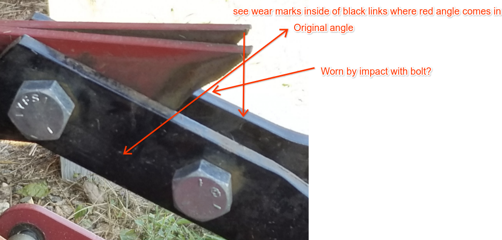

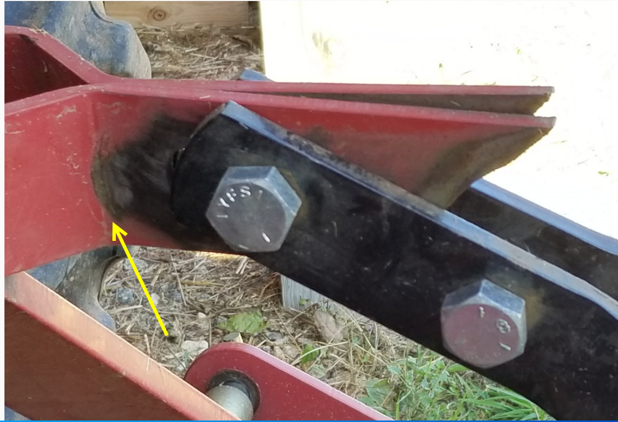

Here is something to possibly look at. See the wear spot indicated by the arrow.
Could it be that the leading edge of the black bars are moving forward in the slot on the red part and binding at the front were the arrow points and not allowing the red part to pivot up?
I think I would get the tractor and cutter on to solid level ground with the 3-point lowered all the way as if cutting and then place a jack under the tail wheel boom and start to jack it up and see how the whole assembly works and pivots. See how far the rear wheel will go up before it runs out of travel and see if the bars start to bend outward.
I think with extension, it could come into line, and then subsequent reversal could potentially cause the compression. If the other links are stiff, more easily than otherwise, and it won't necessarily happen every time. With more wear, though, the extension could result in a locked joint which would increase the chance of the compression.
If the flex yoke can't rotate downwards from its current position, I agree with you that extension causing the links to line up won't happen.
If you look at the wear inside of the black links, it does look like the red yoke is getting all the way in there at least occasionally.
Also note that it looks like the end of the red yoke is worn by impact with something - probably that angle is in place there intended to deflect the yoke upwards in case of a linear bind, but as that wear occurs, more and more strain is sent through the links briefly during the bind-up, and at some point there may be no more deflection from this angle and instead all of the strain may be going through the bolt on the left if the bolt on the right isn't hitting that ramp.

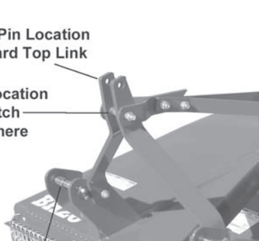

Here is an actual picture from the manual showing the bends in the yoke straps. You can see how far back the bends are.
I think the straps on it are incorrect.
I would also check that the top link is getting set correctly as instructed in the manual.
Looks like part # 50050342

Except I just unwrapped then new parts and helped him install them ..... new parts had a tag with that exact part number. I double checked.
