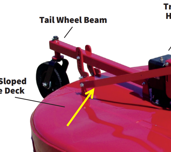

Looking at pictures of the original set up of the BH25 I think the two bars are not the same.
The "bend" in the bars is much closer to the rear mounting tabs in the pictures of a new one.
The bend in the bars on his is much further toward the front of the cutter. You can see in the picture that it seem to contact the rear mounting tab at a bit of an angle which could create a binding point.

Wirlybird -- I agree for sure. That is the only mode in which I broke mine and I bet that's how all of them get broken -- backing too hard into something creating unpredictable upward motions. Great catch on noticing that 'kink' being down much closer to the rear attach points (yellow arrow) on the newer hogs ! I believe the 'natural' bending or kink point for failure mode is about mid length of those straps making that a poor place to put the manufactured kinks. That may well be why the newer ones are near the rear attach points.

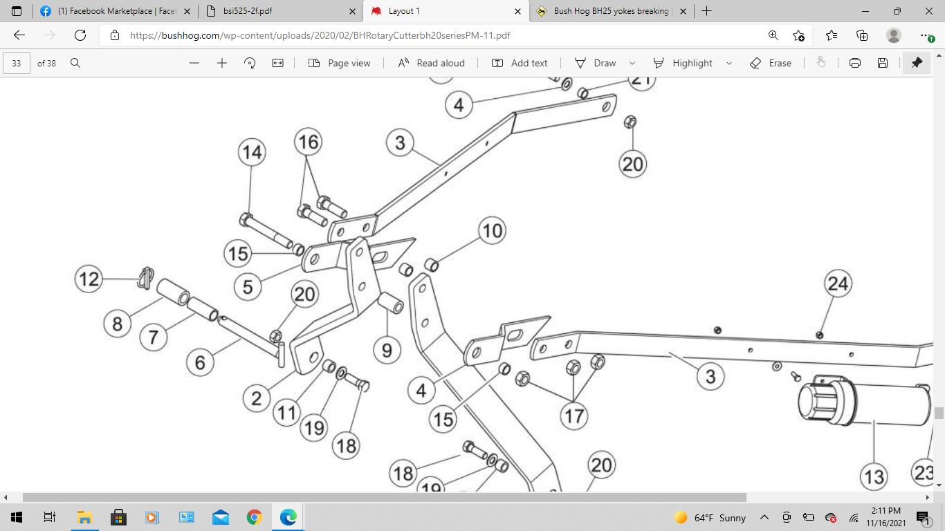

Additionally the flex link is supposed to be a welded assembly. In the pics it appears to be two separate pieces that can move independently. That's not at all helpful.
Parts fische shows it as two separate parts not welded together. I have seen some that are welded but this one is not.
