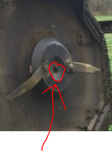

I was mowing grass with a 5 foot light duty King Kutter brush hog using a 40 horsepower NH tractor. It cut well in areas I had cut earlier this Spring but when it got into 2 foot tall grass (not that thick) it caused the blade to nearly stop but enough it did not cut at all. The mower has always been greased, the shear bolt was not damaged or broken. The blades are dull. When I would get back to the prior cut grass the blades would pick up speed and cut again but it had nothing for the taller grass. The tractor was moving at slow speed with engine RPM near 2500.
The problem is most of the grass is tall as my main tractor and mower have been down for 3 months waiting for an odd sized O ring. Really need to mow the tall stuff with what I have. Any thoughts or suggestions?
The king Kutter has a center piece that spins causing the blades move out. The nut that holds the center piece in place has a pin to keep the nut from coming off by accident. If this nut has loosened the gear box will turn but the blades are not being forced out because the center plate is not spinning.
If you have the tractor off and in gear with the PTO engaged you should not be able to turn the plate. The nut should be on tight. I have indicated the nut I am talking about.

There is nothing wrong with his cutter
