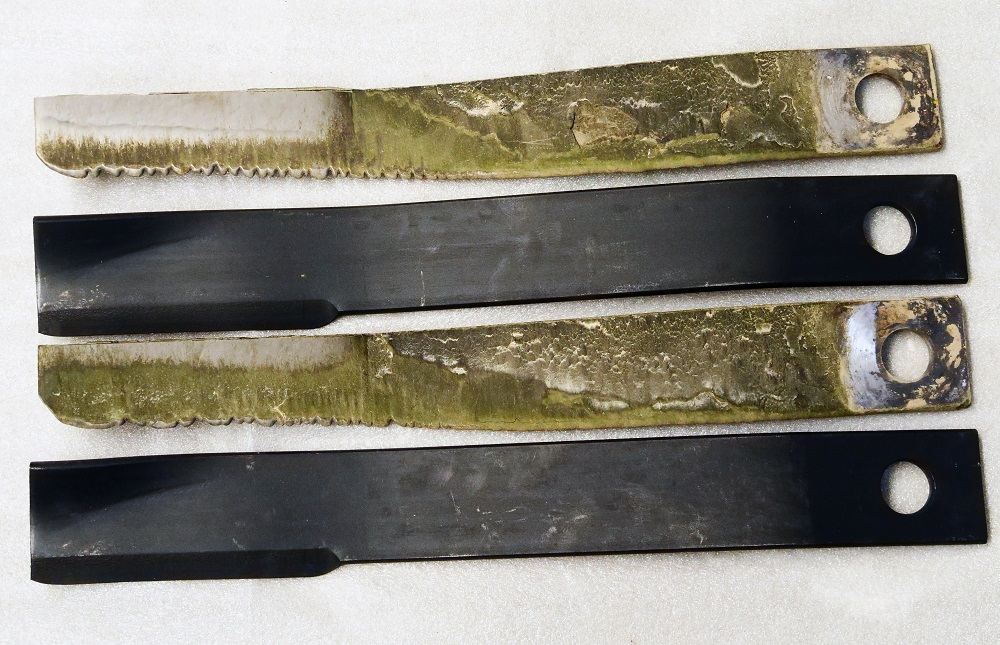

Do your blades look anything like my old ones? They weren't cutting grass anymore, just ripping it. Quite a difference from the new blades!
Heck they may not even look that good anymore.

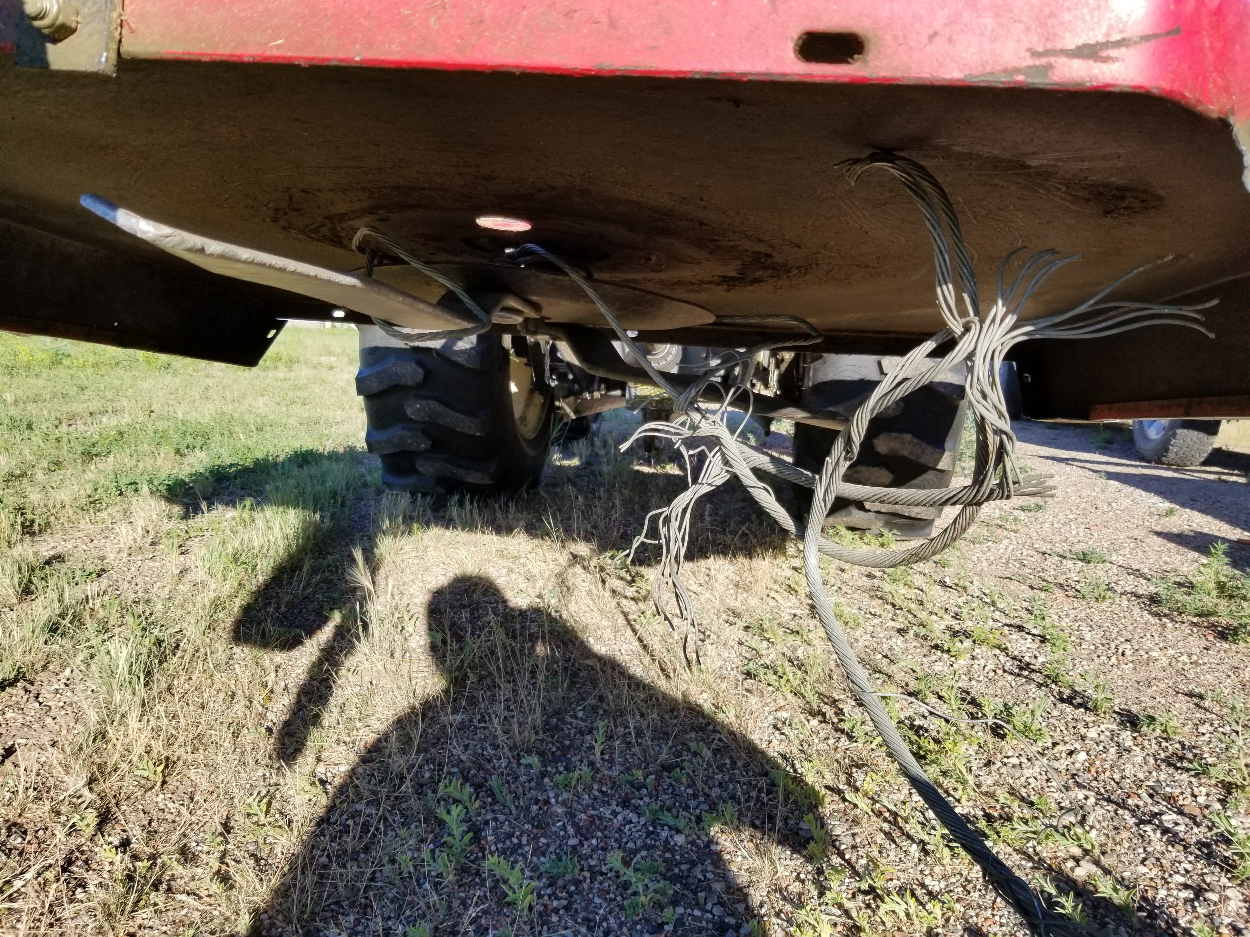

I recall they were definitely showing some wear the last time I was under the cutter (digging out a piece of cable that I "found" in the grass). But I wasn't really focused on the blades at the time.
Actually I think they just have a bit of wear at the tips. This is a pic from the cable wrap incident. Not a great angle to see the blades with (sorry), but I don't have any other recent ones showing the underside.

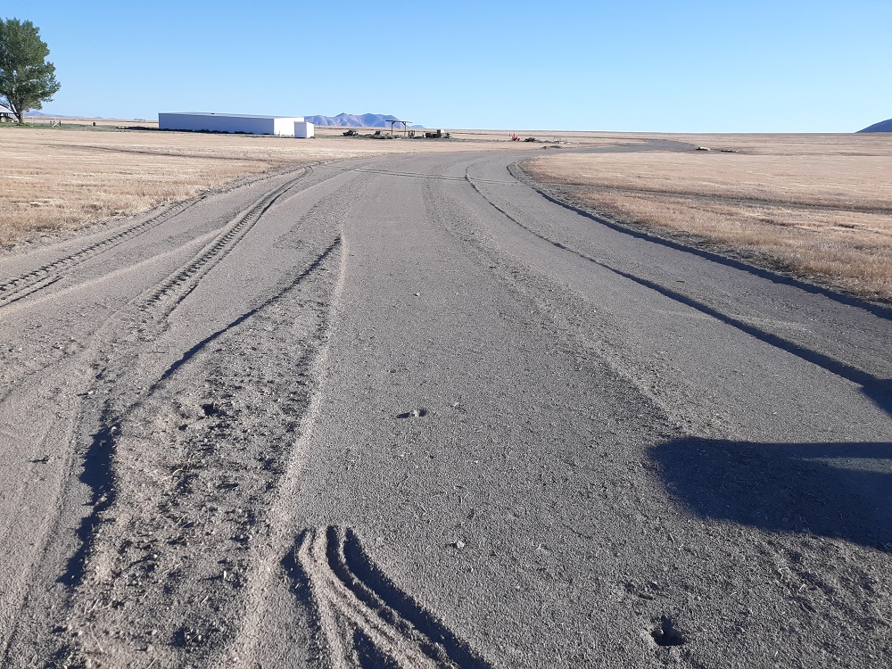

My nearest neighbors have kept a herd of goats on their property for many years. Unfortunately, there's a lot of this desert vegetation that even goats refuse to eat so each year I mow about 8 acres of their property in addition to mine, just to mitigate the fire danger around their buildings. (Fire danger is the only reason I mow my place.)
Everything mowed to 3" or less, and a wide firebreak is how I try to keep my place safe.

The photo of used blades by DesertEagle71 show the origin of problem I had. The clean spot on the blade around the bolt means it was rubbing the blade holder.

Very intriguing landscape. I think that's how Vegas looked at first.
