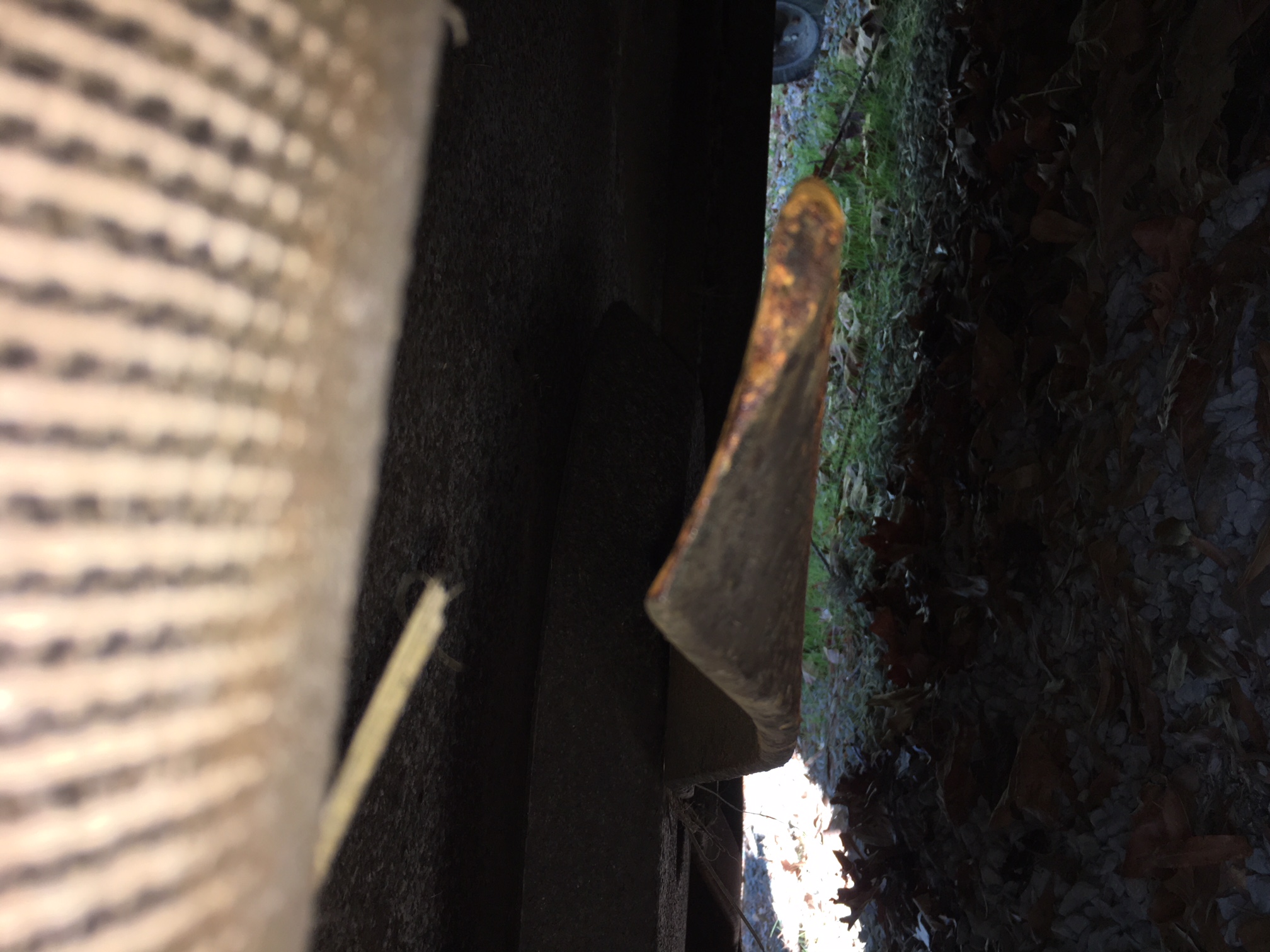

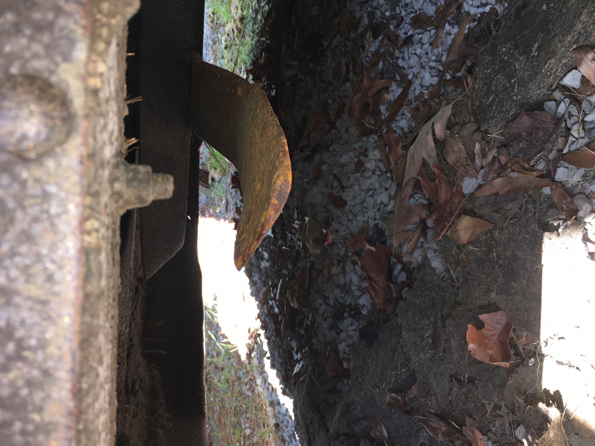

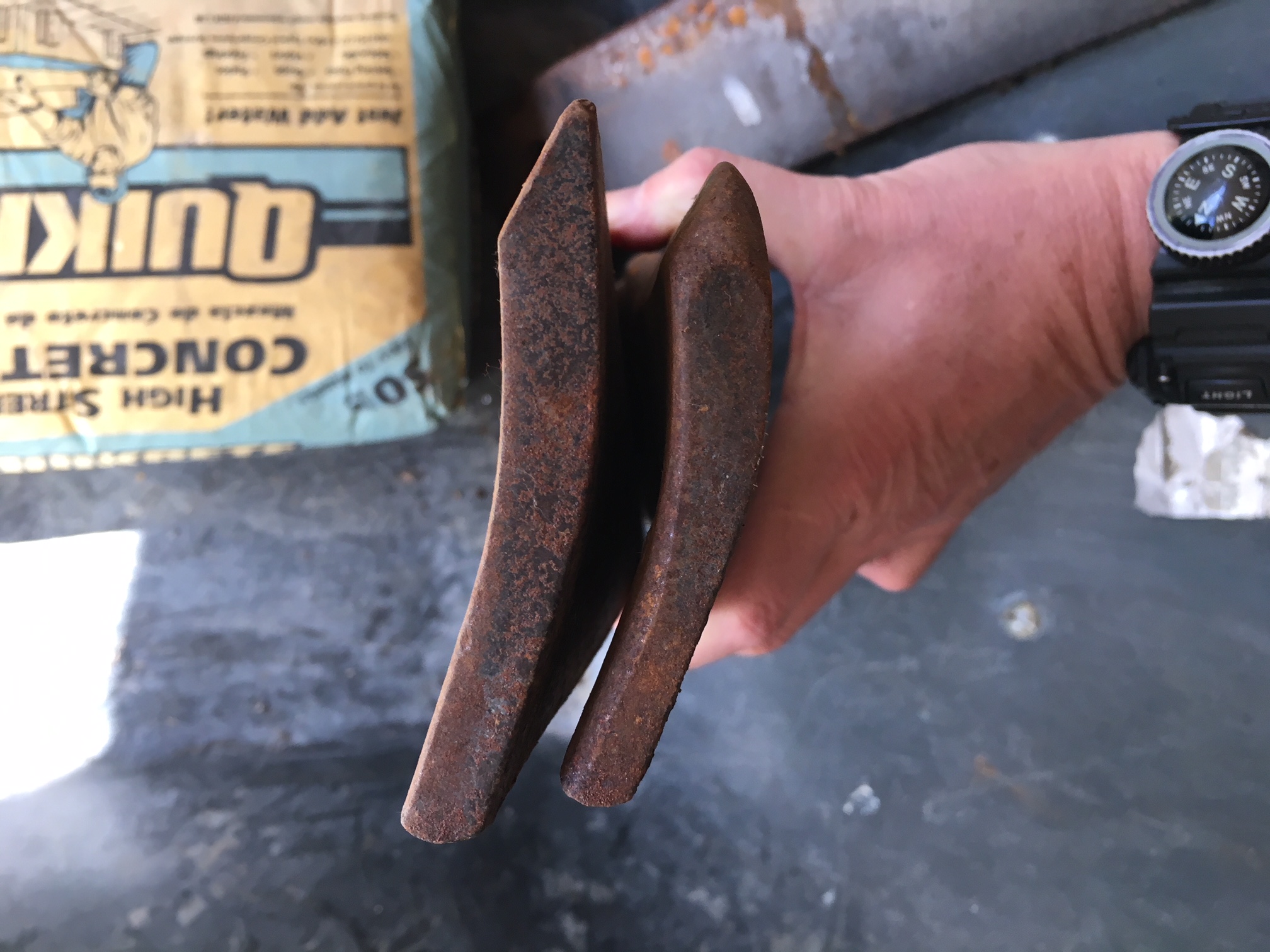

I found one set of blades I believe had been used and one that I believe had not been used. This mower has two spindles so I need two sets of blades.
One photo shows a comparison of what I believe is an unused blade and a used blade.
The other photos show the tip of one of the blades that is still installed on the mower.

I have a 3126 Bush Hog brand rotary mower. I inherited this mower with the farm.
I took a look at the blades today and believe they need to be replaced (thought that was likely before I looked).
Something I noticed that I don't understand: The back of the blades is worn down. What I mean by that is the opposite side from the cutting edge (as verified by rotation direction) is worn down.
Anyone have any idea what causes this? I don't find it in the owner's manual. My most probable explanation is operator error.
I found two blades I believe are new (well, old but never installed) and two that are obviously used...but not nearly as much as the ones on my cutter.
My cutter is a two-spindle, offset, semi-mount 10' version. I think I'll order 4 new blades but would like to know what caused this type of wear.

It's grit and sand wearing the lift side away. I have had the same thing happen to lawn mower blades. After several sharpenings on the cutting edge, the lift edge is worn badly and I get new blades. I would sharpen those rotary cutter blades and run them another season or two. Rotary cutters don't depend much on the lifting of the grass/brush by the curved back of the blades.

Update: My local dealer had new blades in stock. What I had were a couple of fairly worn blades, a couple of lightly worn blades and two sets of blades (on the mower) that are severely worn.
I'll trash the blades on the mower, sharpen the lightly worn blades and I picked up a couple of new blades.
