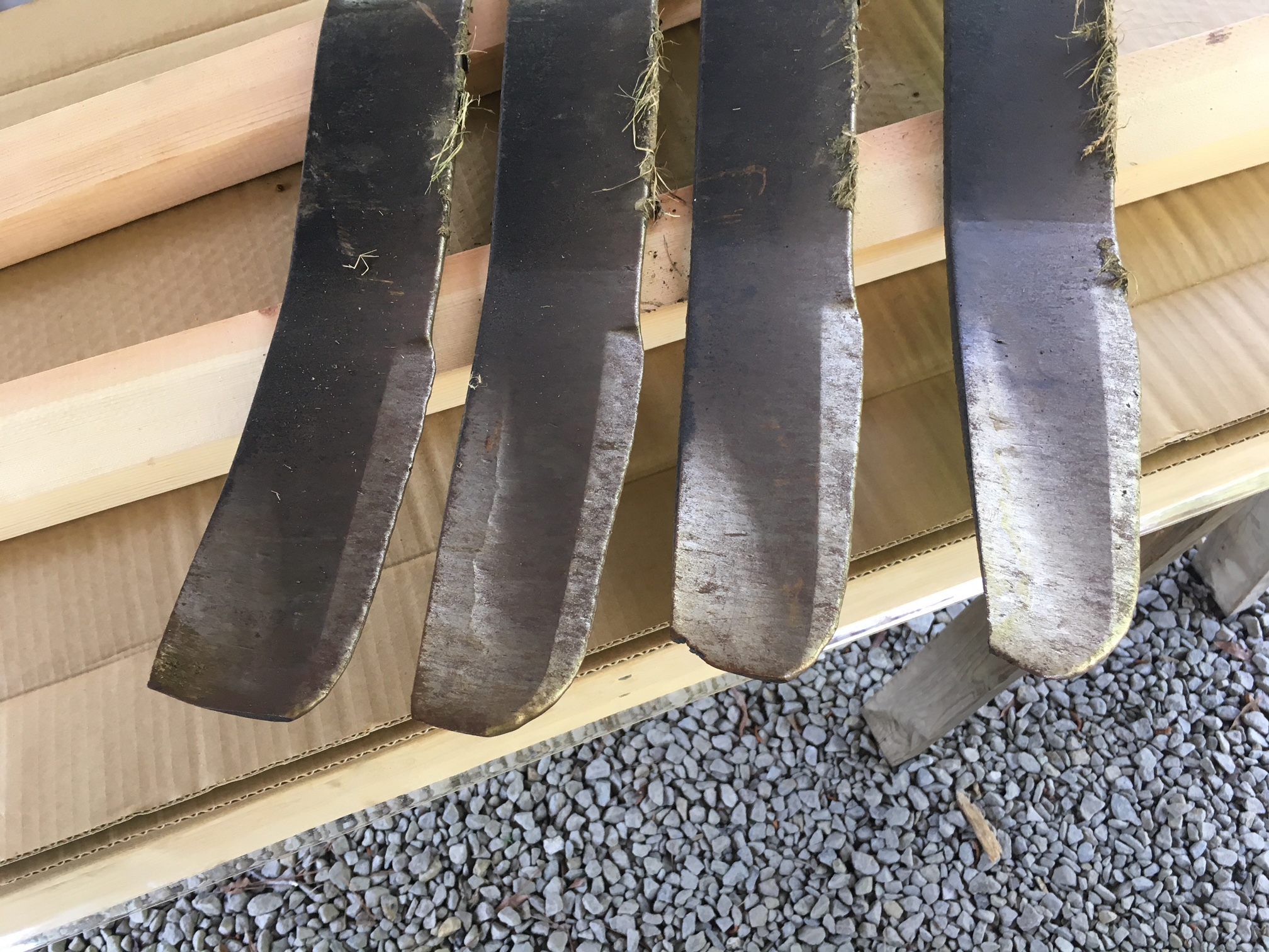

Bush hog blades worn on back side.

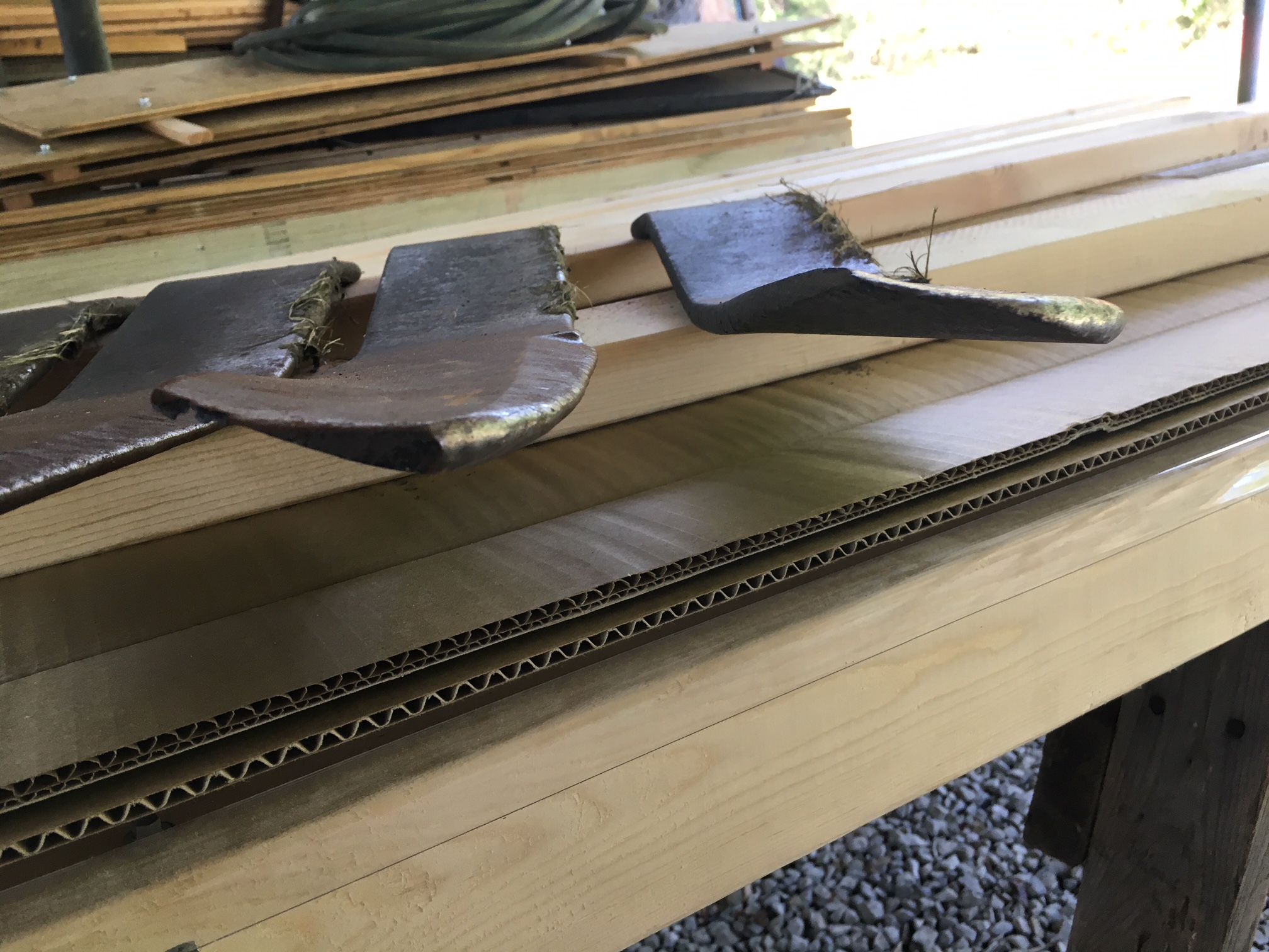

Changed the blades this weekend. Forgot to take photos but WOW they were in bad shape. One of them was worn so thin on the back side that it was curling over. Cutting edges were rounded and nicked.

As a follow-up, I remembered to take photos of the old blades this weekend. Though I had noticed a deterioration of the cut provided, I still thought it cut pretty well. It wasn't finish mower quality but was good enough that I used it around the house instead of investing in a ZT mower.
This kind of makes me think that sharpening blades is not as important as I would have imagined on a rotary cutter.
The backside blade wear clearly shows in one of the photos.
   / Bush hog blades worn on back side. #28
I usually equate wear on back side of blade to erosion from grass stems and dirt and gravel (gopher mounds) and occasional "baraaap" from disintegration of a rock (that floated up during winter), while mowing.... But then again it's on lighter blades for riding mowers, but don't see why same forces are not at work with bigger mowers...
