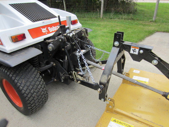

Bush hog keeps dropping ggv down. I cant find a leak. 2003 b7500

This is what it looks like installed....top link omitted for picture:

You probably just need new seals on the lift cylinder for the 3 pt. It's located inside the rockshaft cover.
   / Bush hog keeps droping cant find leak #5
Look between your legs ( when your on the tractor) there is a knob, just close it and it well not drop.
   / Bush hog keeps droping cant find leak #6
That will fix it if it's a leaky valve. Not so much if it's leaky 3pt lift cylinders.
