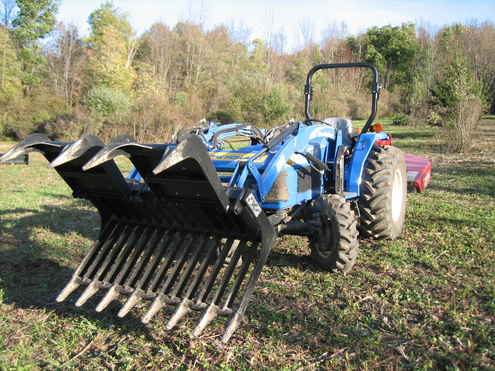

I bought the SQ172 new, I had a lot of work to do and it has performed perfectly! I did blow off the forward rubber guard but that was it and I was cutting up to 2.5 - 3 although I would try not to cut 3".
I always wonder though why don't they use a bushing on the vertical shaft for the tail wheel?

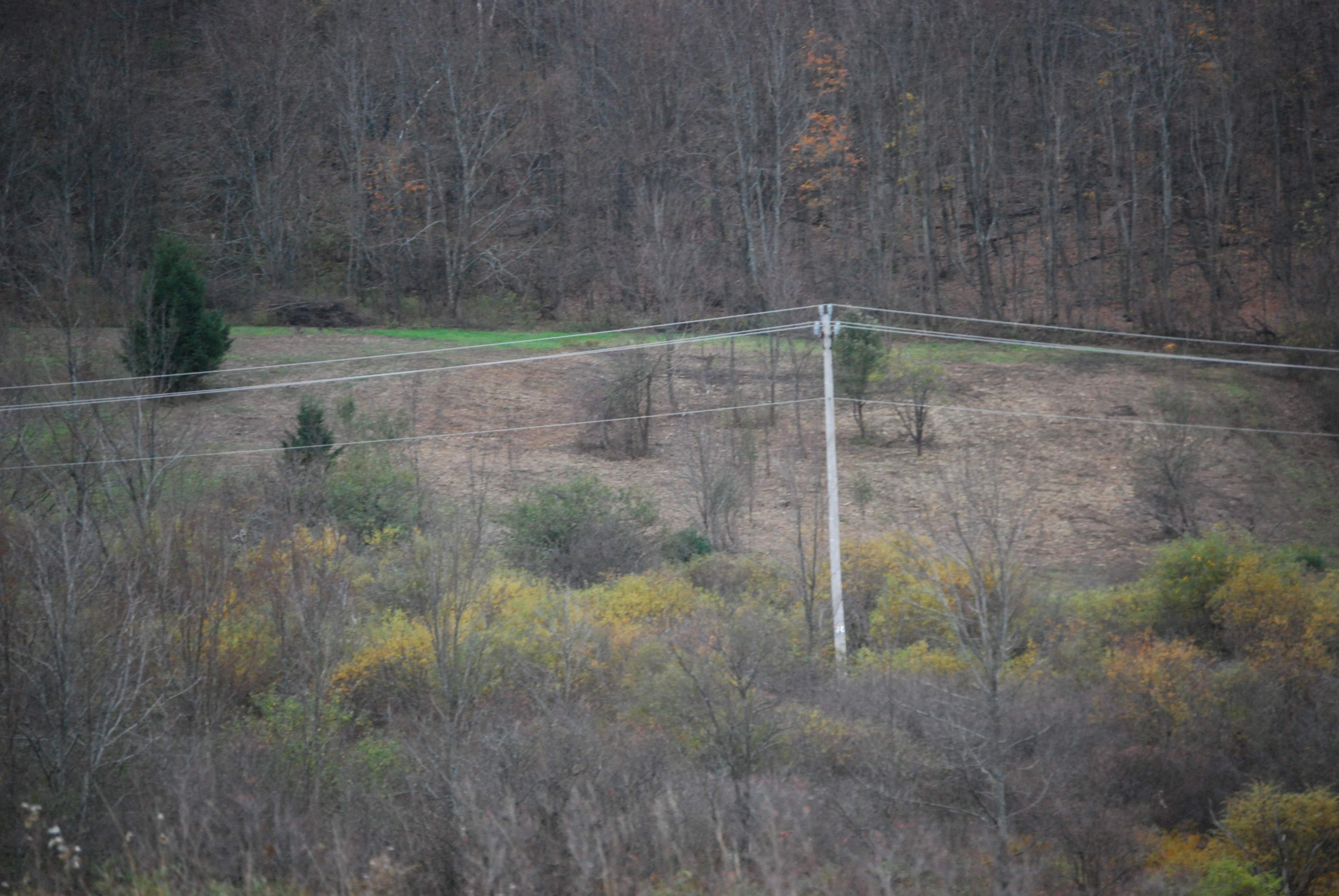

Here is a url of my (what was) most overgrown field. The satellite passed over this past october 21st. , if you select satellite view the pin will be in my field and the far right edge still needs to be cut with a mix of chainsaw and brush hog.
Google Maps To Send a Position
Below is are pics of the field before and after along with the grapple attached. I have leaned to brush hog with the bucket on to push down the brush and then move the piles of trees I cut and piled at the end of the day.

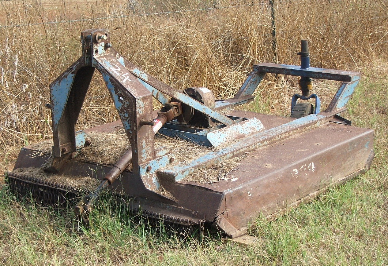

Stop using the rear wheel for a bumper on those light duty cutters. :) My old Ford 954 cutter has 5" boxed channel iron in the back and the wheel support tube looks like 1/4" thick or close to it. I've "bumped" a few low branches on Mesquite trees with it backing up to cut under them. If a branch gets hung up on the tube or wheel, it breaks the branch off. While it's not the prettiest cutter in the world, it was cheap and works. It regularly takes down 1-2 year old mesquite. I've accidently run over 4-5" fallen braches and it just bangs a few times and wood chips go everywhere until I lift or pull out. The #24 on front was the auction lot number. I got it for $30. I'm still using it eight years later.
