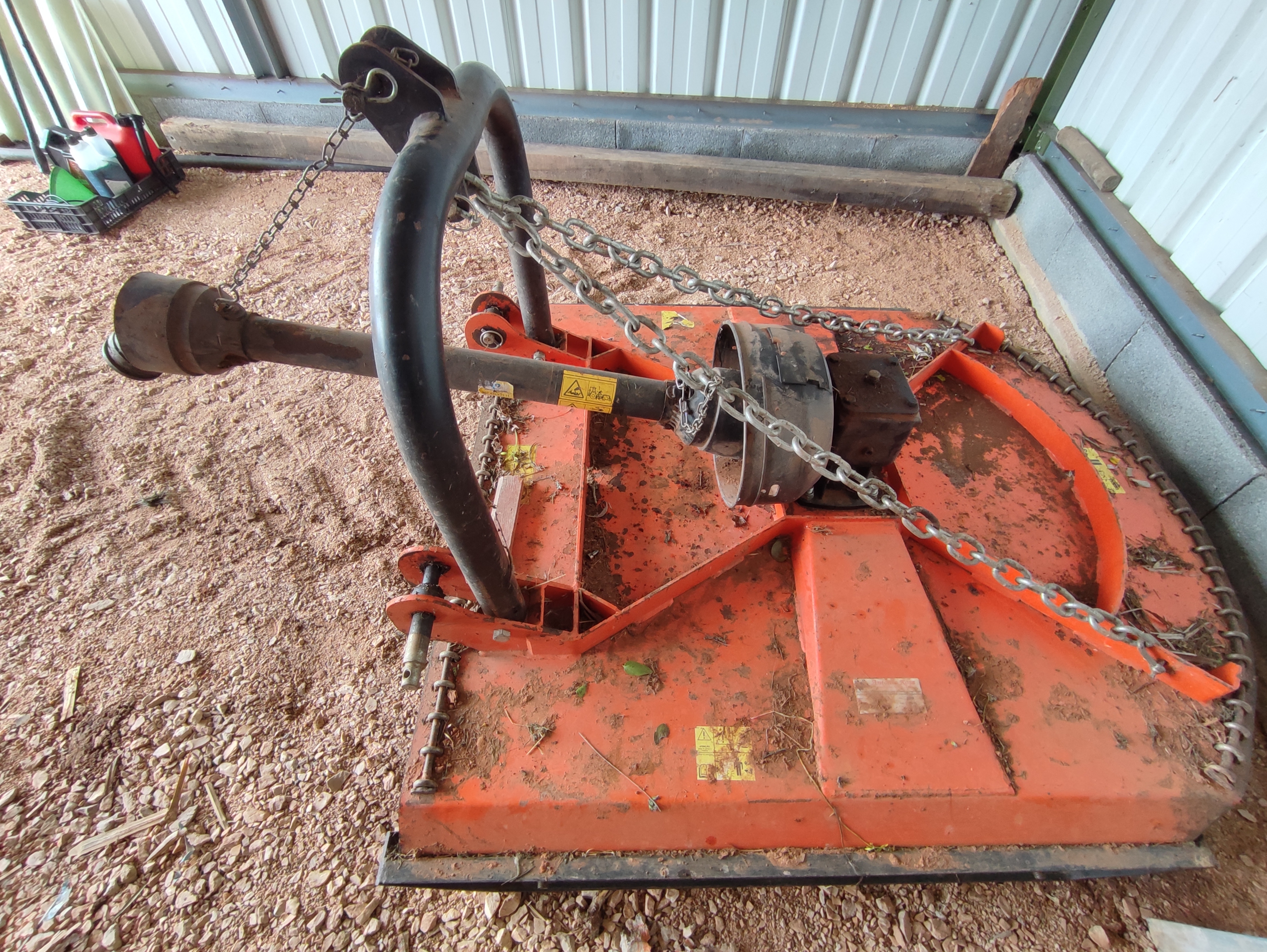

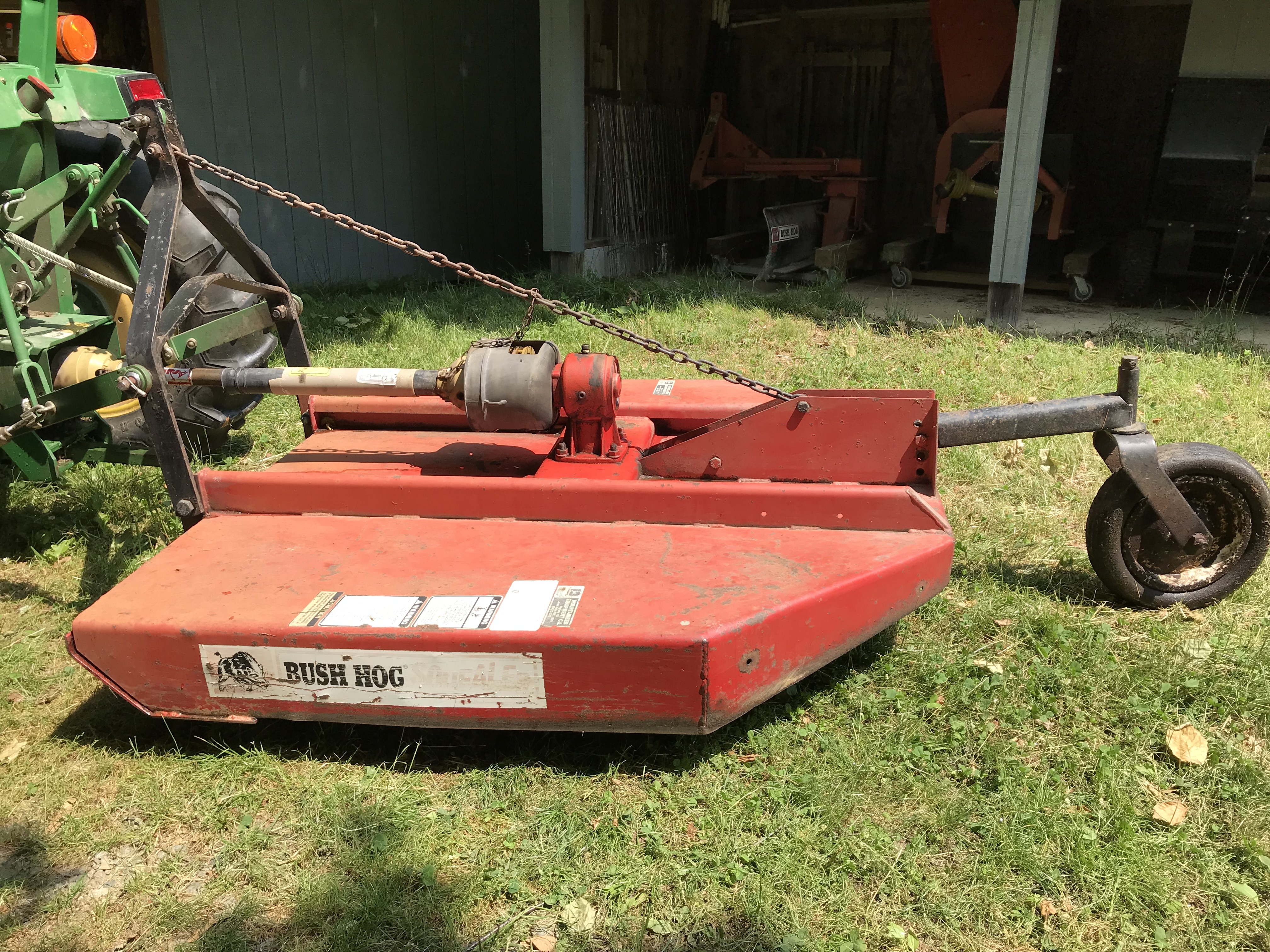

The chain was probably attached to the 3 point frame work, so that you can lift the mower. The wheel in the back should really only touch the ground occasionally, though before I bought a finish mower I would regularly run the wheel on the ground to cut the grass extra short.
New, the mower probably had a framework that attacked those pieces of angle on the deck to the 3 point framework. Mine broke as well, and I replaced it with chain, but my chain goes from the angle pieces to the 3 point, not from the back like that.
Not a great picture, but hopefully you get the idea:

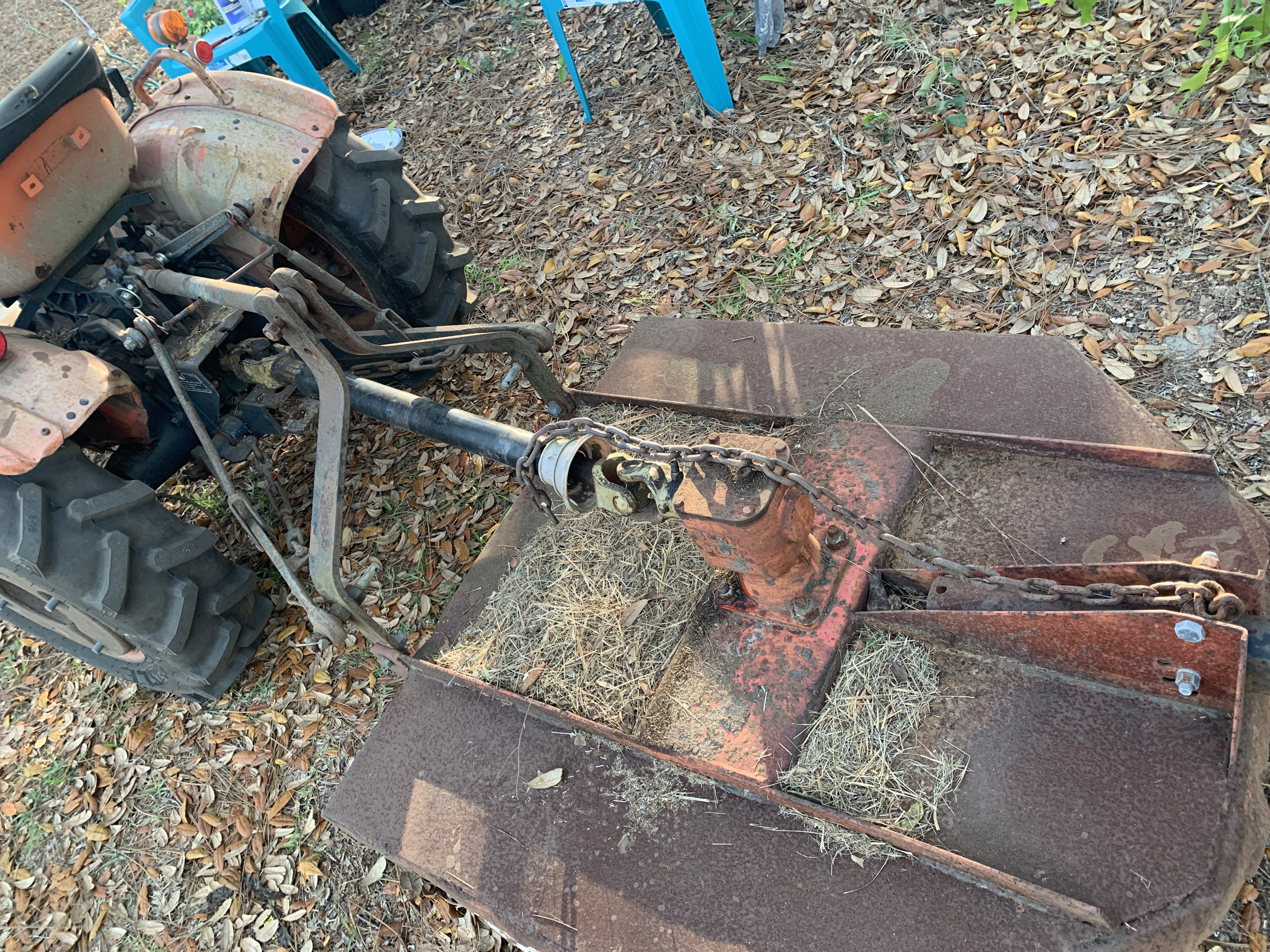

The photo in the original post looks very much like the Bush Hog brand mower I purchased new 28 years ago. It came from the factory with a chain like that shown in the photo. It was attached to the top of the 3 point frame, but I've sold the unit and can't recall exactly how it was attached there. I think it was to a bolt in the hole that's visible in the photo just below the attachment for the upper link.
Why do you say the wheel show only touch the ground occasionally? I always set it to run on the ground so it could follow the rolling terrain we have.

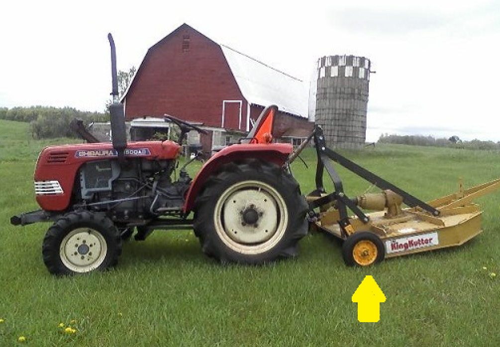

I was told that when I bought it. The dealer was trying to stress that it is for taller rough cut, not for a lawn.
/ Bush hog #25
OK. Seems strange to me. You are supposed to control the height of the cut with the height of the 3-point in front and the height of the rear wheel. That's why they are adjustable.

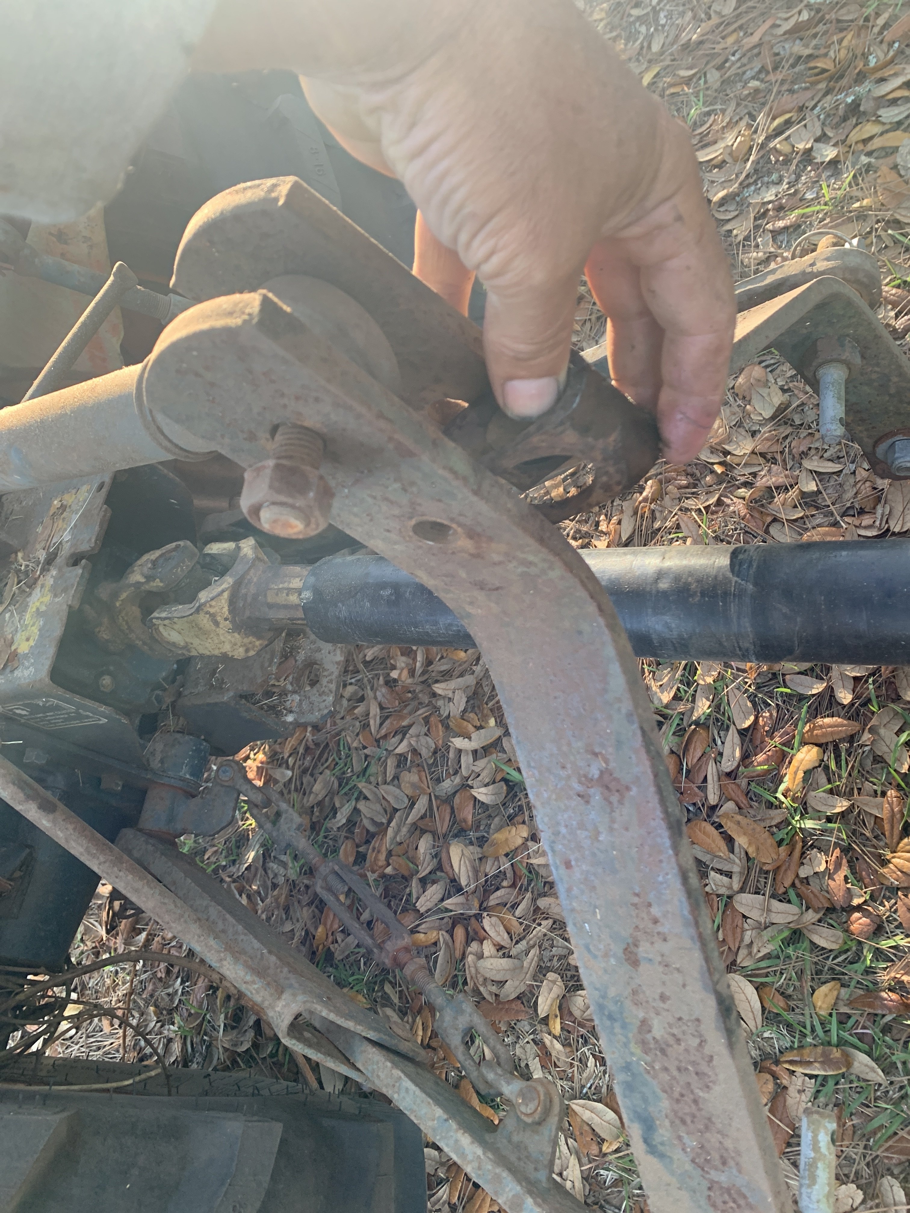

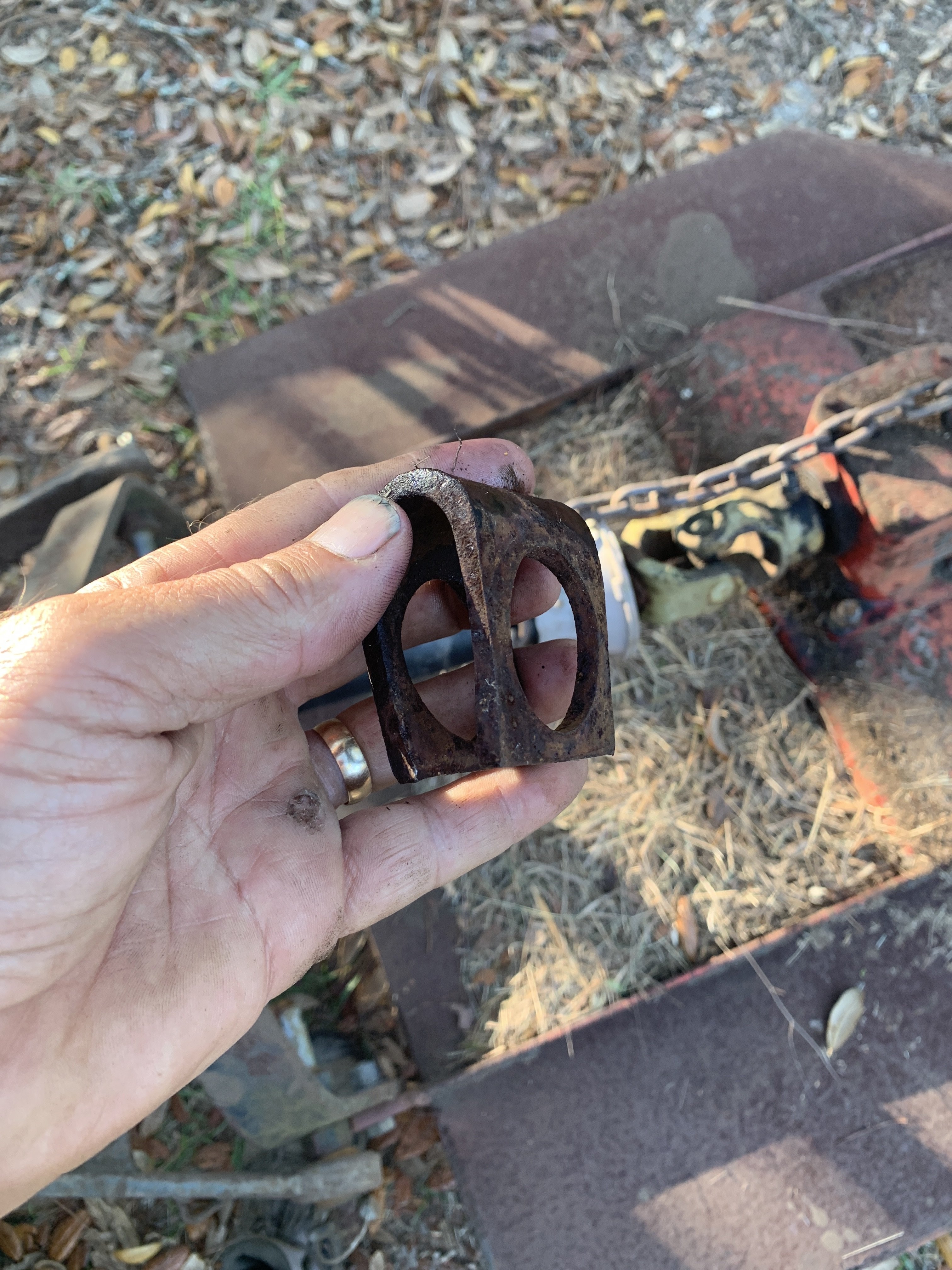

Good morning, is it normal that these blades be loose?
I know nothing about this, I need one and it’s been sitting
The bolt/ nut is tight, just sloppy from wear.
Not stupid loose in my uneducated opinion but definitely wobbly.
Someone has just abused this thing
Thanks
Before you run it, carefully check the PTO shaft that may have zerk fittings in the Universal. Be careful that it does not hit the housing when you raise it. Run it LEVEL, not nose down.

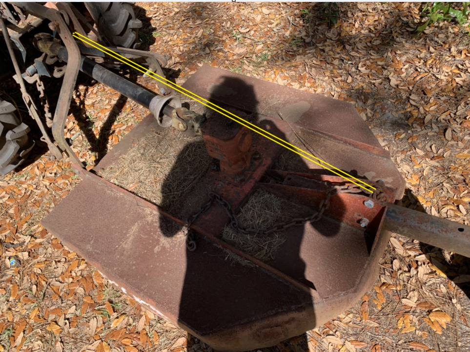

You're talking about the cutter pictured in your first post in this thread? It's a standard Bush Hog SQ from late 1990's. Here's a photo of the one I sold a few years back:
The skids are for when it mistakenly hits the ground, to keep it from digging in too deeply. It's not designed to run on them.
In response to your earlier question, you can see how the chain is supposed to be attached at the top of the 3-point yoke. The top link in this photo is set too short, making the chain tighter than it should be in normal usage. This is a photo I took when I put it up for sale and I had it tight so I could raise it up to take a photo of the under side.
Thanks
I would not give over $100 for it. I see a lot of pitting and pinhole rust. May be other problems in the gearbox. Is the PTO shaft missing?
