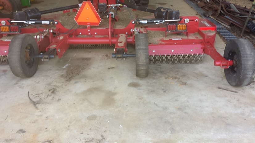

According to the Rhino TS12 Brochure downloaded from their website, you can see in the first picture how it has a unique tongue design that allows it to pivot on the cutter itself which improves turning radius.
I believe the Rhino TS12 was the first to come out with the 12' flex-wing cutter.
The specs show the TS12 overall length as 148". I measured my Bush Hog 1812 yesterday with it hooked to the tractor as 180". That's a huge difference! I pay attention to specs and try to figure how most things play into actual operation, but I never thought about the cutter scraping as it went over humps. I can imagine 32" makes quite a difference.
You can see in my picture how the rear wheels extend so far behind the cutter. You also see the slot where the wing cylinder attaches that allows for some free movement of the wing without affecting the cylinder.
Woods advertises an advantage to its rounded front design. I think that is just advertisement and possibly just the opposite of true. If it did not have any drawbacks and was truly an advantage I would think the other manufactures would have caught on by now and implemented a similar design in both the 12' and 15' cutters.
Woods also advertises its easy change blade system using a 3/4" wrench. I have no idea how it is designed but that is a whole lot smaller than the BH blade bolts.
