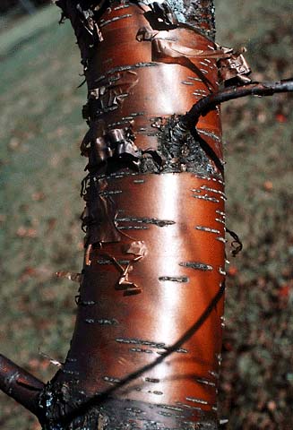

/ Bushhogging vs. mowing #13
Does the bark look like this?
#14
It looks just like that, Bigdogue. There's alot of them and they don't chop up easily. If they stand higher than the stack on the tractor, I go around them. Anything shorter generally gets the full treatment. Thanks for posting the pix.
