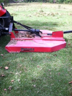

There can easily be misunderstanding in these discussions of course. MMagis said "I don't know where the idea came from that without a flexible link a brush hog will self-destruct at the first little dip in the terrain." There is definitely a 2 part need for a non-rigid connection between your top link and the rigid upper structure parts of your bush hog. Part 1 is that if the top link is solidly connected to the hog and has no "play" to allow it to move forward and backward with terrain, you will bend something or create some form of damage. All hogs that I know of come standard with "hinged link" connection to the top link for that reason. (see attached photo.) Often a "U" as some posters mentioned. Easiest way to picture the problem is crossing a gully with the tractor front wheels and the hog rear wheel high while the tractor rear wheels are down in the gully as you cross it. In that case the top linkage had better be able to shorten several inches or you'll bend something/do damage. Part 2 of the issue is when the tractor front wheels and the bush hog rear wheel are both low while the tractor rear wheels are high. Picture going up over a hump or rise where this will happen. In this part 2 case, unless the top linkage can extend several inches your hog will come up off the ground as you go over the hump. No damage, just undesired failure of the hog the remain down on the ground. I attached a picture of a typical hog where the top linkage shows fairly well. View attachment 444429 I think you can see that the top link attach point can change distance to the rear of the hog by several inches (pivoting at the middle one of the 3 bright bolts shown.) Many "old farmers" prefer to just use a chain for connection to the top link because a chain allows the overall linkage to change length by several inches and yet allows you to pick up the hog if you raise the 3pt lift high enough. Maybe MMagis always operates his hog on fairly even terrain with no ditches, gullys, and rises. The more varied your terrain the more length change you need to allow to avoid damage in Part 1 cases and and keep the hog on the ground in Part 2 cases.

To the original poster, it looks to me you?*e trying to use a brush hog to do the job of a finish mower. If you need to drop the cutter that low, plan on digging in the dirt occasionally. If a brush hog worked well that way, there would be no such thing as a finish mower.
