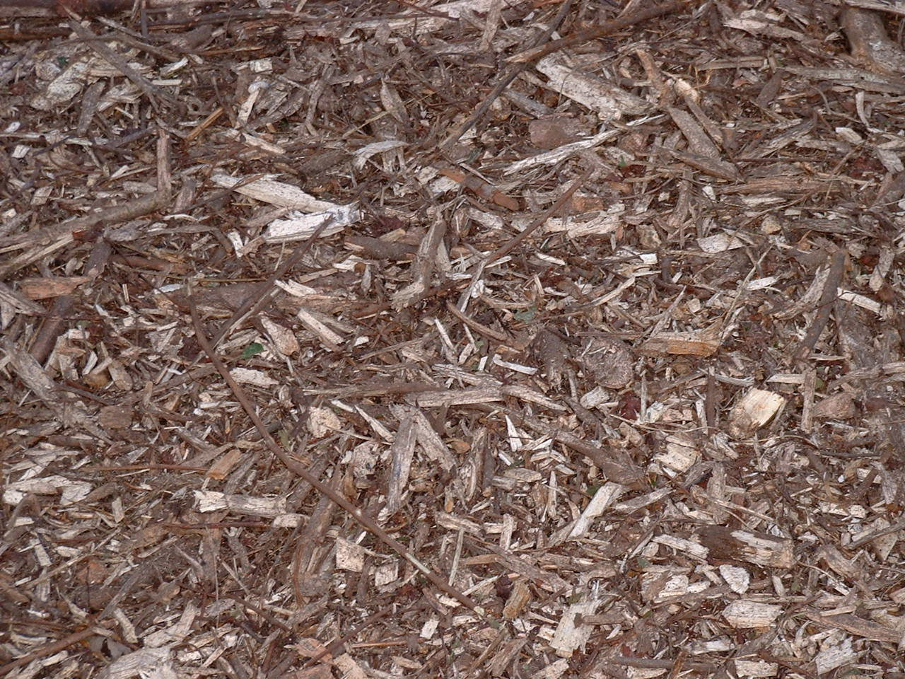

Heres what the timber ax will do...Non carbide cutter..chip size with the shear bar at the smallest setting....So you know...anybody with a carbide image??

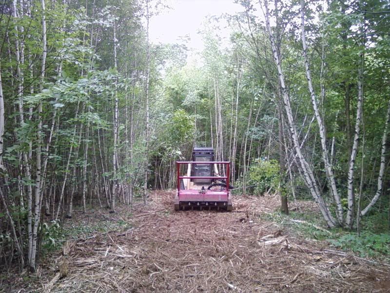

A job I did with an FAE head which uses carbide teeth. This was Poplar or Aspen which mulches up good.
This is a recent job with my Fecon, also carbide type teeth. I could have ground up this material better but I was raking it off the site and I find it easier to leave it a bit more coarse for raking. I finished an acres of this in about 10-12 hours.
I think the cutter type heads will give you more production per hour.
Carbide will hold up better in rocky conditions.
You need less HP with the cutting heads vs carbides for the same production.

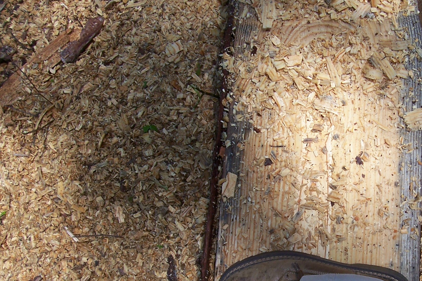

Production and finished product is where a DENIS CIMAF head excells. We recommend sharpening the blades at the end of everyday. Takes about 30 min. with the included gas grinder. Then it cuts the same eveyday, day in day out. A carbide will cut great at first but after 100 hours or so the tips will round off and start leaving sprigs. After that effeciency falls greatly.
Blades verses carbides. If you run a set of carbides for 400 hours and run 4 set of our baldes to get to the same 400 hours, it cost the same. But you will have mulched more material to a better finished product than with a carbide. Time is money and we are just more efficent. I can prove it with a demo.
