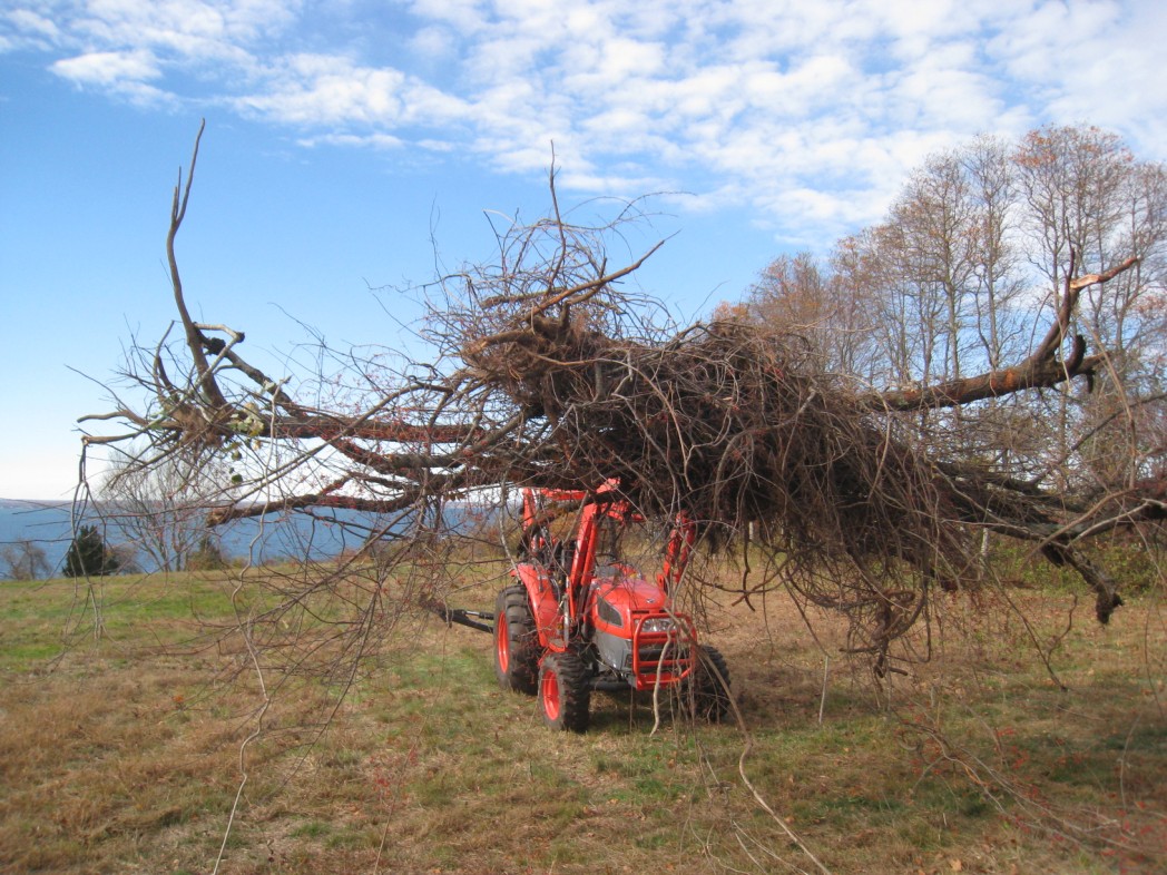

The 60 is the largest I would ever consider. The 72 is only useful, IMO, for something like construction (cleaning up debris with a skidsteer) or hauling cut firewood. To be honest, if I were buying a MX5200 (again, not that different from my Kioti DKse in weight or loader capacity) I would get an even smaller grapple. I currently have a 48" grapple and it does everything I need. It has advantages in digging over a 60 (more concentrated force) and is lighter (greater net lift capacity) and cheaper (more beer money). I think the grapple I would buy if I had to do it again (which I don't as my 48 is going strong at age 13 including 10 years on the DKse) I would get the ETA-SLRG-54 Single Lid Wicked Root Grapple Lightweight Strong Large opening It is 54" which is the narrowest they make otherwise I'd get a 48. Very solid grapple, fair price, excellent quality. You will never "outgrow" that grapple.

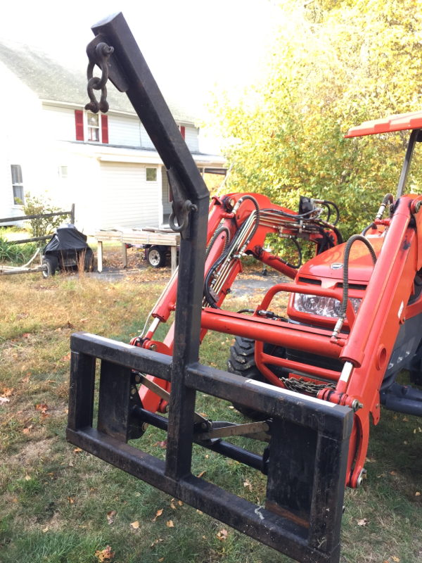

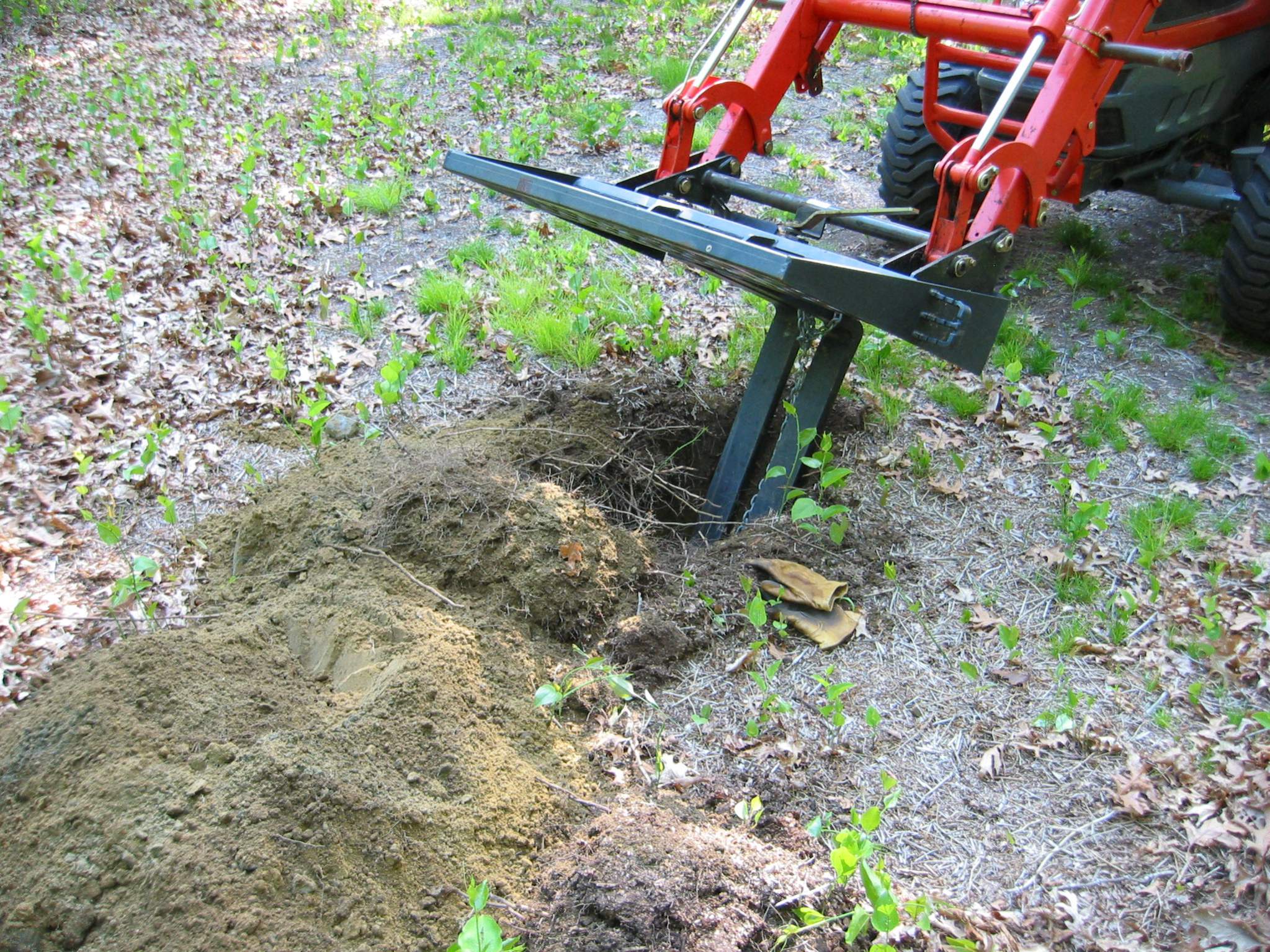

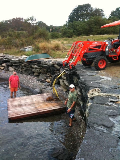

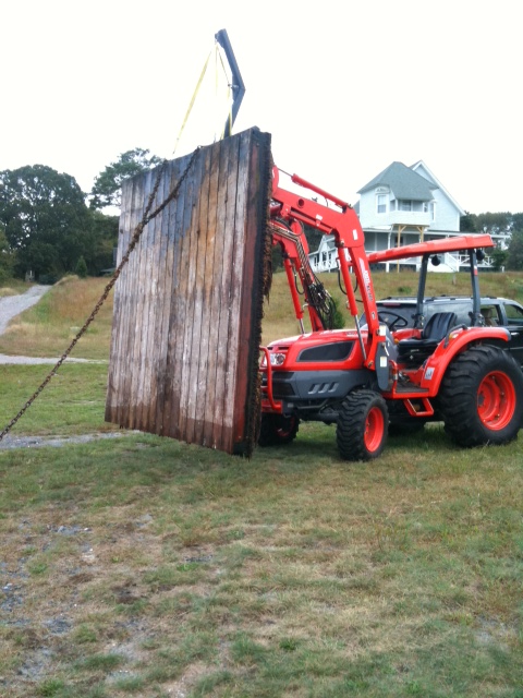

And, using the $$$ you don't spend on a big fat grapple or 4n1, in addition to the single lid grapple, I second the idea of a forks set (not bucket forks). They cost about $500 and while you won't use them nearly as much as the bucket or grapple, they are invaluable for moving big things. You can also stick a spade on them and use the forks to dig trenches or holes if you don't have a backhoe (Google Quickspade). I also find a tree boom (about $350) very useful as a sort of small "crane" attachment. We use it largely to lift a swimming float in and out of the water over a seawall. Couldn't do that with any other implement.
