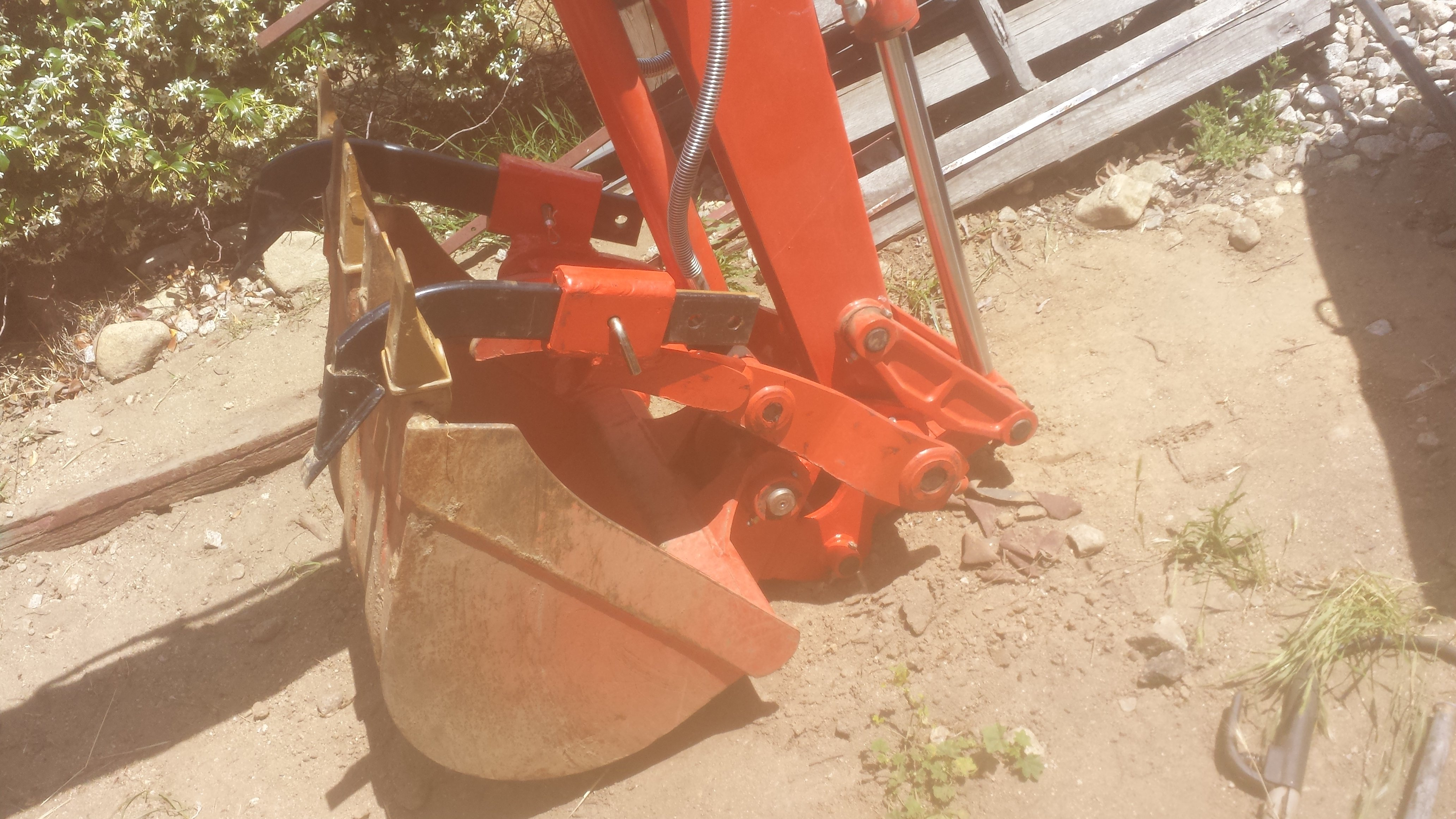

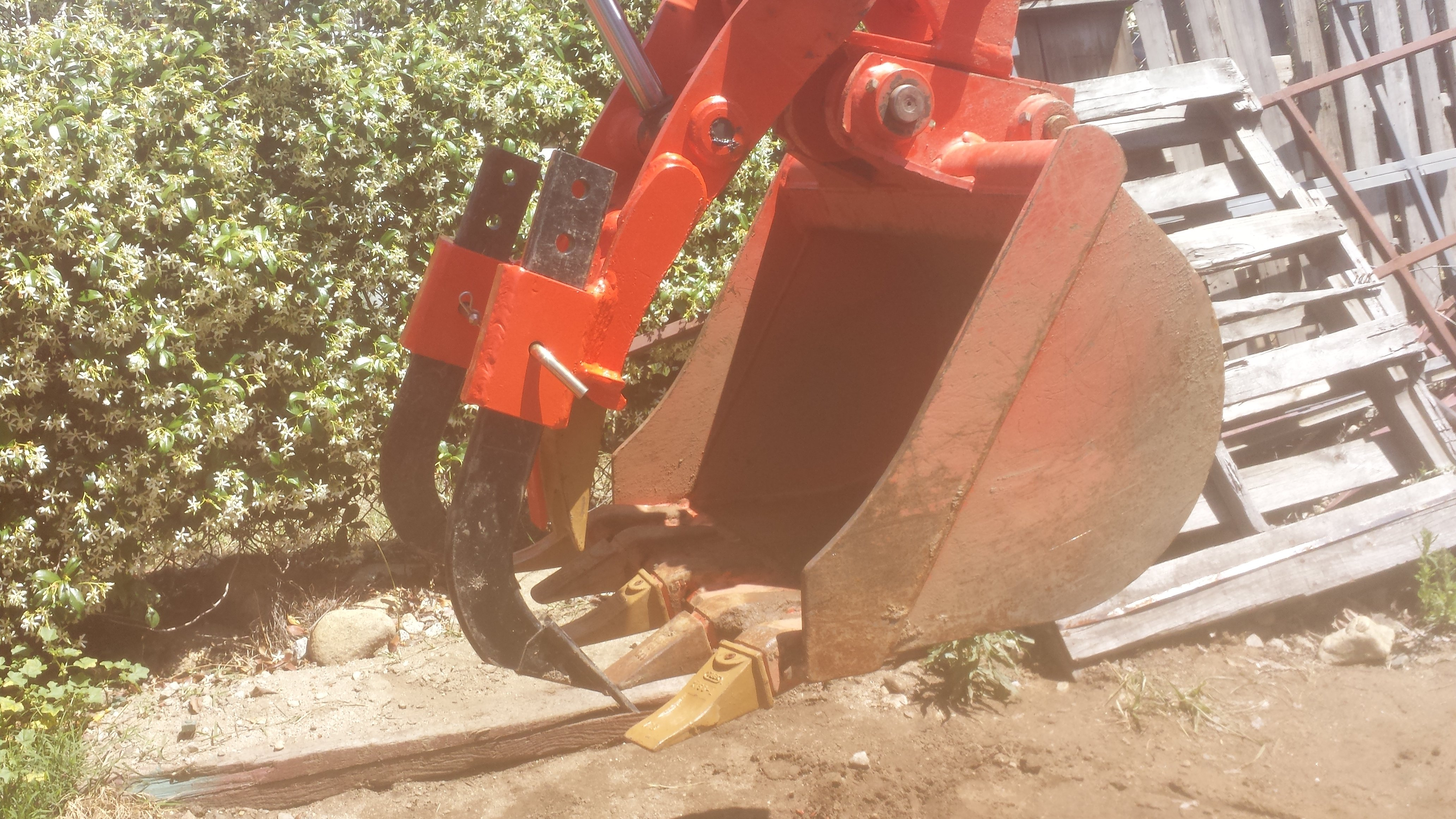

You should be able to take your tractor there and have them assemble and install the backhoe for that price. Also the manual thumb should be around the neighborhood of $750, and it meshes really well with the bucket teeth. In the thread linked above I mention about converting my manual thumb to hydraulic, copying what some others on this site have down. It's basically an electric over hydraulic setup, teeing into the bucket lines and using a normally closed solenoid valve on the cylinder side port of the thumb cylinder. I did have to remove some metal from the thumb to clear the fittings on the rod side port, and it's a longer cylinder than OEM so the thumb doesn't sit as tight against the dipperstick, but you should be able to do the entire conversion for less than $500, and the OEM thumb cylinder costs over $600.

You mentioned the mechanical thumb... Can the mechanical thumb be converted to hydraulic using all of Kubota's parts? In other words.. Could I buy the cylinder and valve kit later and mount everything that way? Or, does the mechanical thumb differ from the hydraulic thumb?

The thumb itself is the exact same thing. I've looked at the part numbers of both and it's the same part number. I would imagine though that it's going to be more expensive to buy the parts separately than to buy them as a kit when you get the backhoe.
