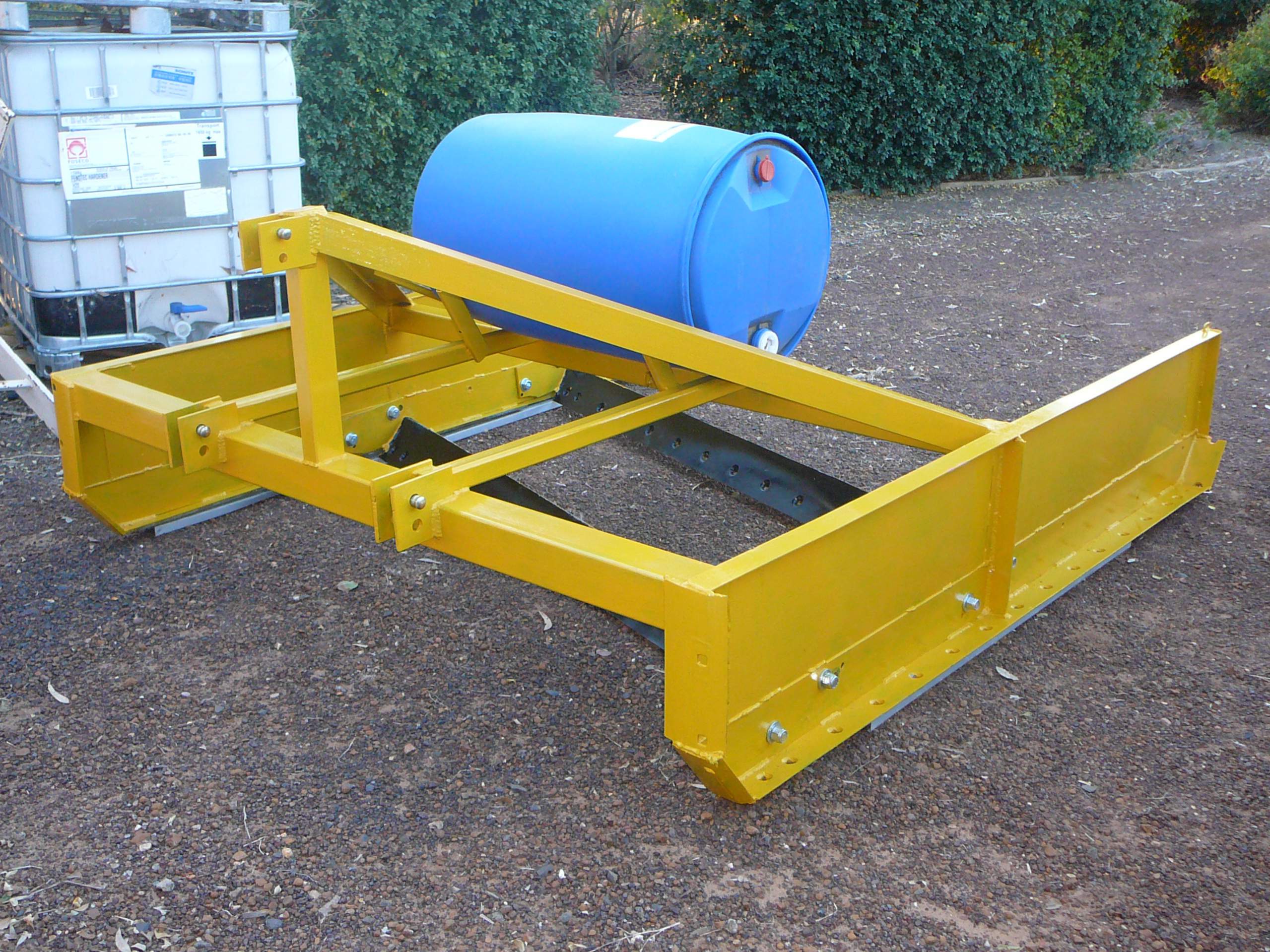

Oosik, I'm in the process of building my LPGS and I don't think I'll make the magic 200 lb/foot mark even though I'd like to.
Can you please post a pic of your 400 lb concrete casting and especially how you attach it to your grader?

I used a 44gal plastic drum full of water on mine to add extra weight
