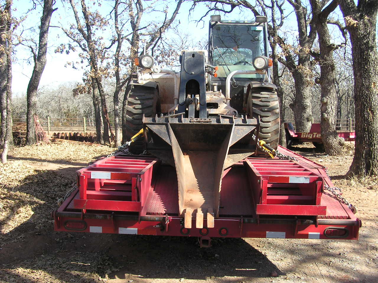

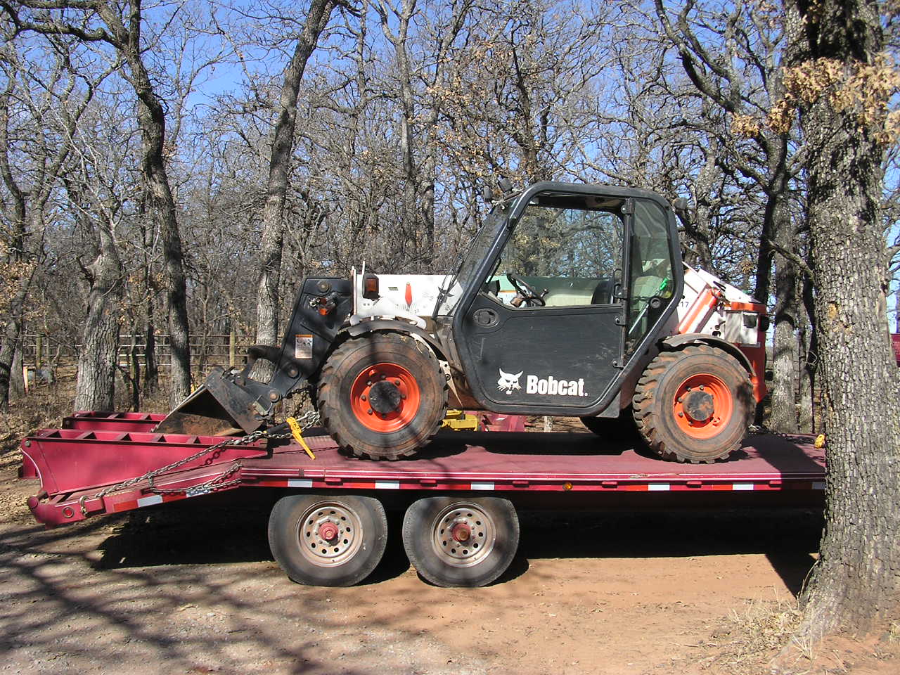

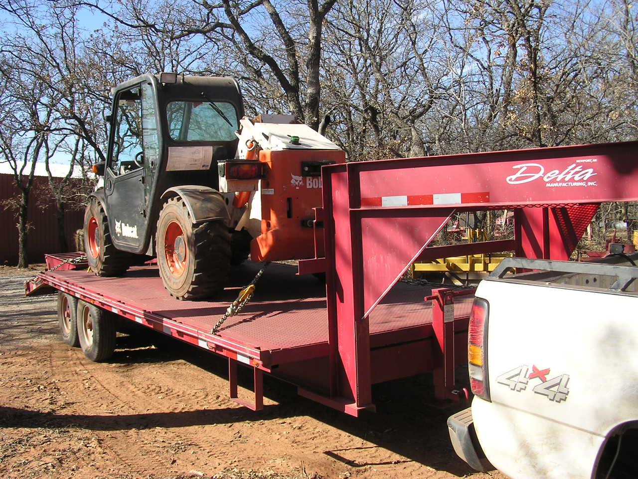

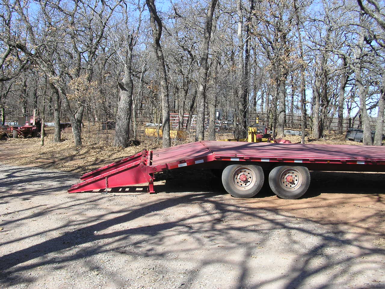

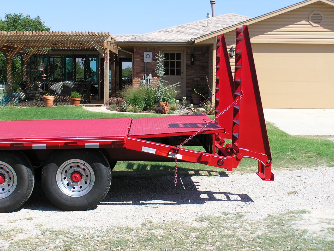

econometrics, My trailer weighs 5,000 pounds, with 4,000 on the axles. I went with a 4' dovetail, because a 5, dovetail will drag the ground offroad, as in farmland.
Pictures from before we moved, showing the pop-up dovetail and ramps chained in the up position.
View attachment 358830 View attachment 358831
Good food for thought on the height of the dovetail! And I like how you can get all four bales on your trailer there with the ramps chained in the up position!
That's one of the things I've been thinking about in wanting a 20+5 vs. a 25+5... giving up that extra 5 feet. I can't see myself needing that 5' right now, but it could be nice to have.
Only problem is that the trailer wouldn't fit in my shop, then. I'd like to keep it inside to keep it in better condition for now, so I'm willing to sacrifice that 5' to do it.
   / Buying a new GN trailer: tilt or deckover? #64

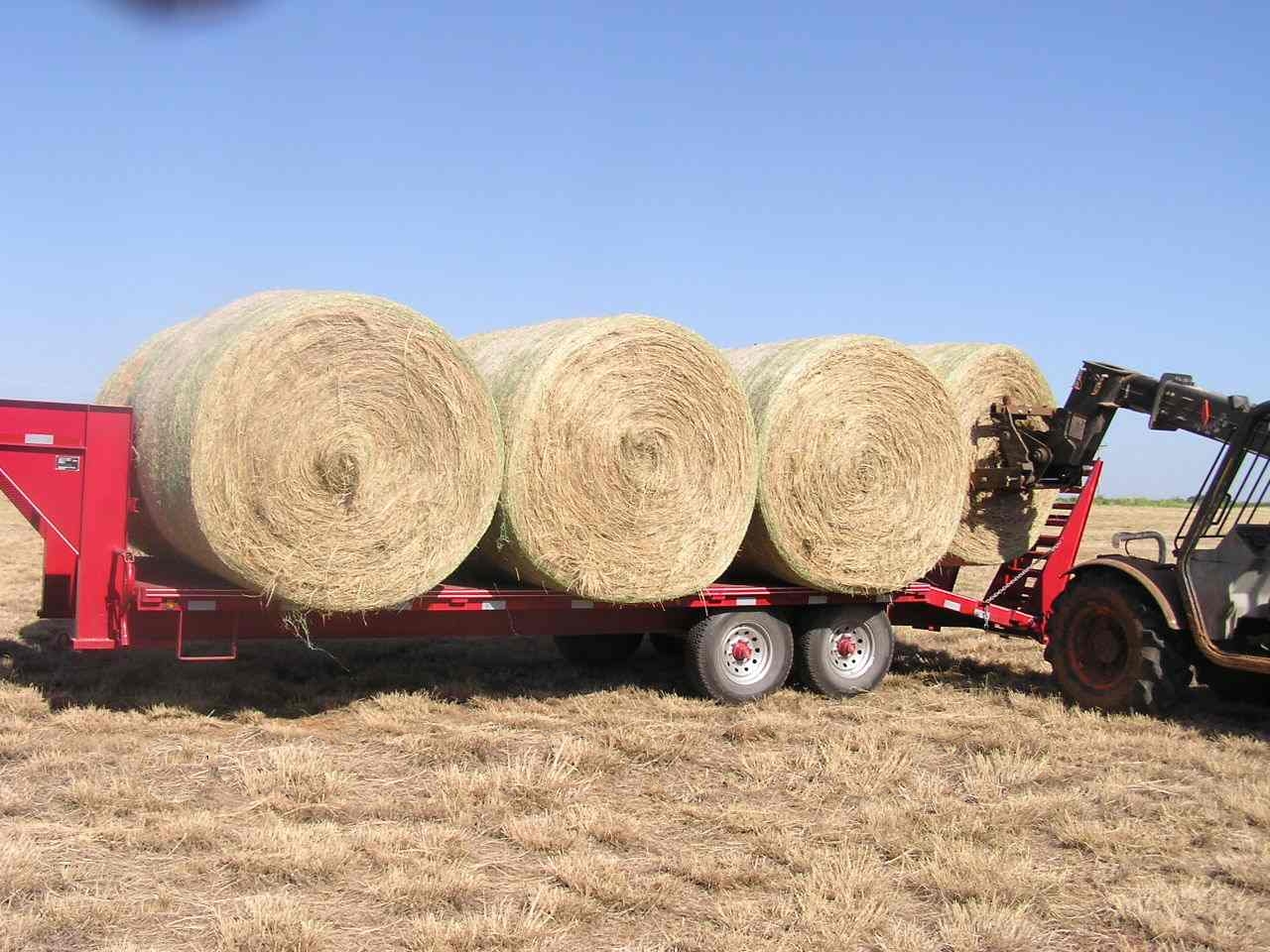

Look closer, it is two rows of four, 5x6 bales, or eight total. Then I put six more on a 16' deckover hooked to the receiver hitch on the back of the gooseneck. Pulled them down the road from the hay field to the barn, about a mile.
That's actually what I meant... that you could get four lined up in a row. 8 total. Just need to stack there more on top! :D

That's actually what I meant... that you could get four lined up in a row. 8 total. Just need to stack three more on top! :D
I have with lighter bales, but these were about 1500 each!

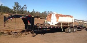

There's a 20,000# GN trailer available on Craigslist here now - $6,500 - not mine, I don't know enough about these to know if it matches anyone's needs here, just thought you might like to see it: Trailer
