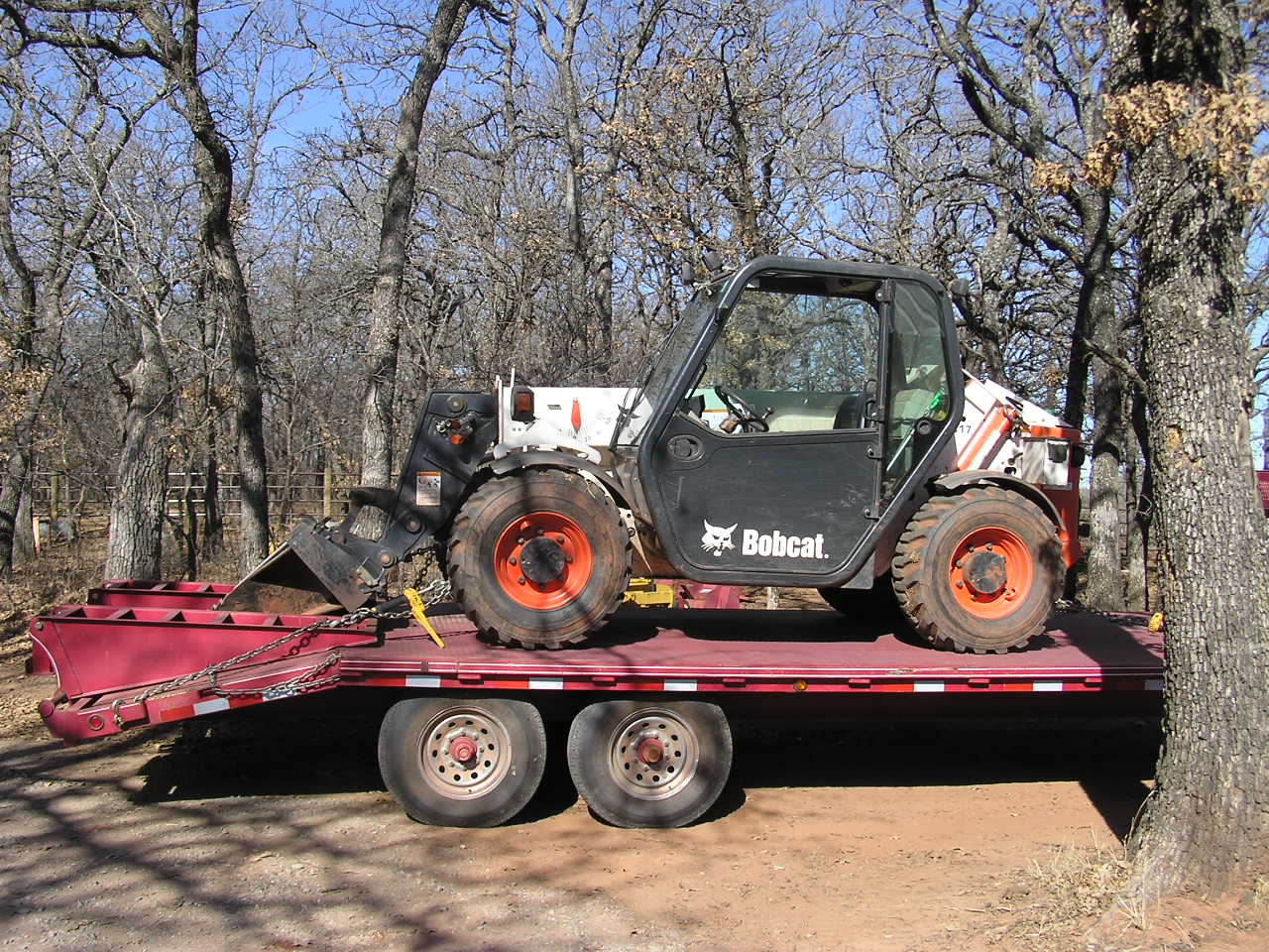

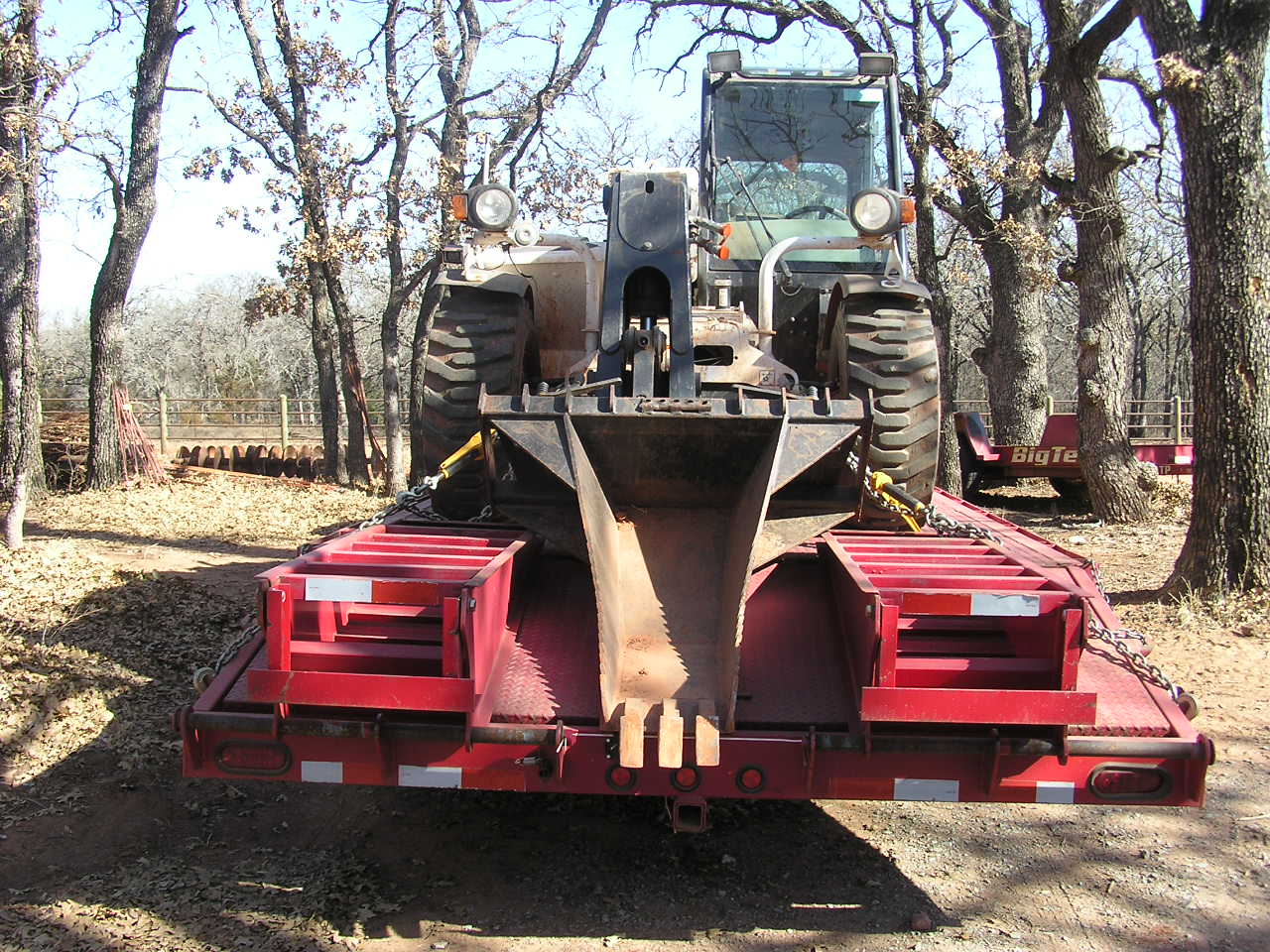

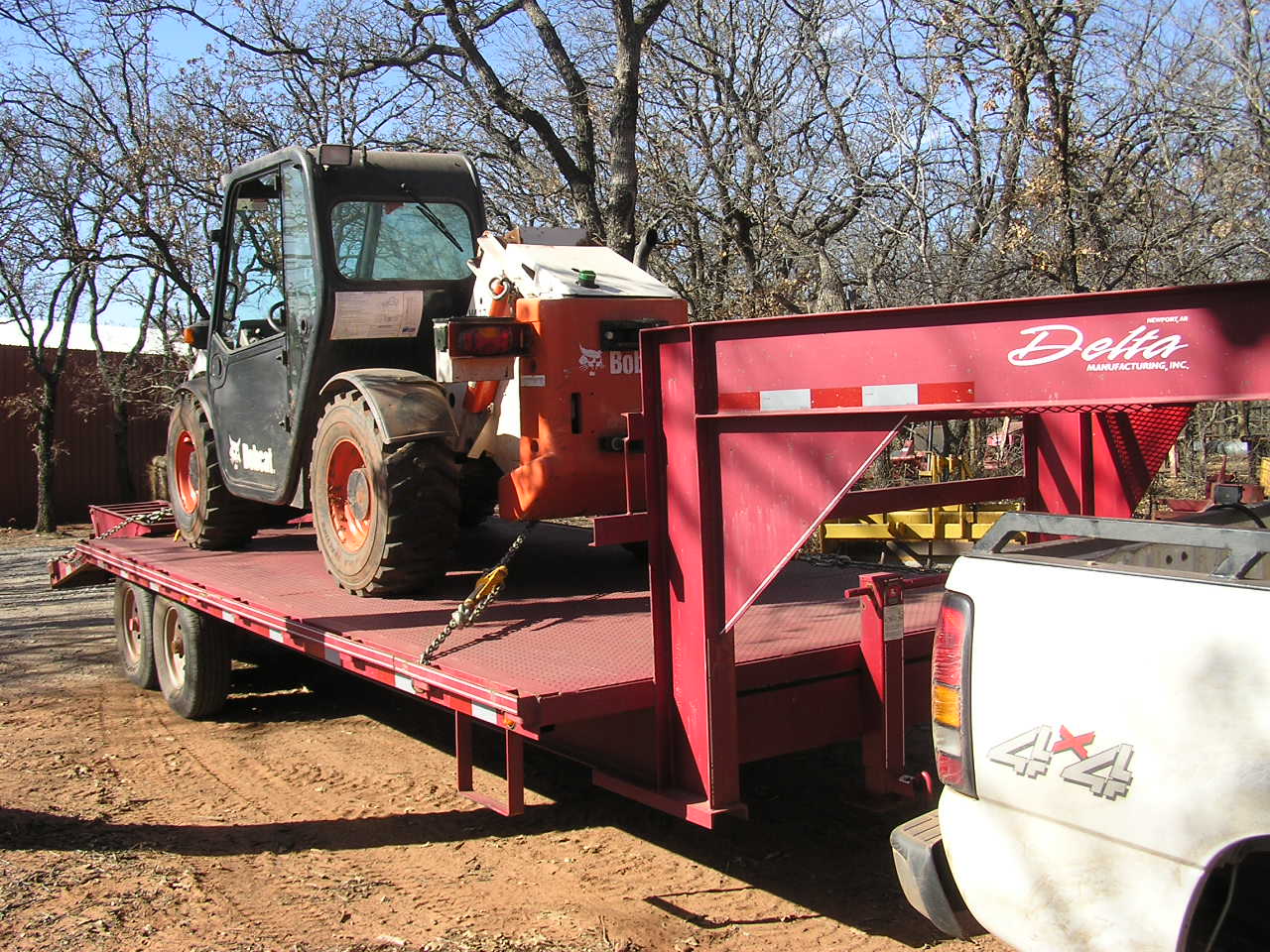

I have had several trailers over the last 30 years. Started with bumper pull. Switched to gooseneck as my equipment got heavier. There is no way that I would go back to bumper pull.
This is my 14K trailer, 18' steel deck, plus a 4' pop-up dovetail and receiver hitch. I picked it up at the factory in September of 2006.
