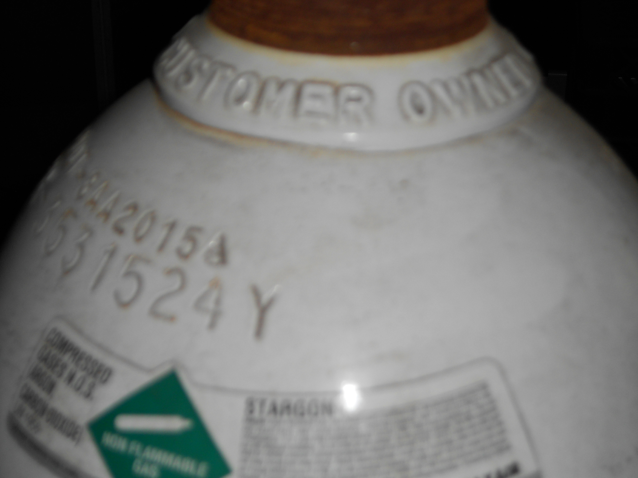

Here is what you want to see. I won't even consider a cylinder without it!

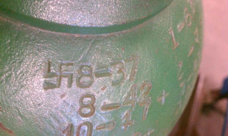

You don't see these very often.
   / Buying an argon cylinder #20
Hey... had two of those in my medical gas room last year.
Just think if those cylinders could talk... could have been anywhere in the world... on a submarine or airship...
The supplier had not even noticed the mark.
My neighbor and good friend as I was growing up was the plant superintendent for Pacific Oxygen...
Every week they were recovering cylinders and a few times folks went to jail... not someone bringing one in... it was a business that had about 20 of them.
He set me up with a couple of 1800 pound oxygen cylinders and I have never had a problem.
I also would bring him smaller cylinders I would buy and he would inspect and hydro and I later resold them...
Made enough to pay for my welding equipment.
I now use a local Fire Extinguisher company that does their own hydro testing... I can drop off a cylinder in the morning and pick it up later that day.
