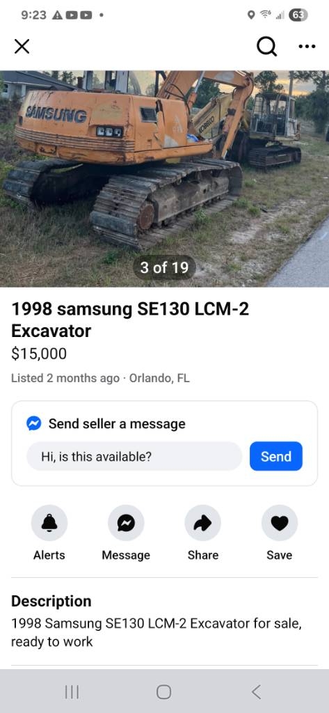

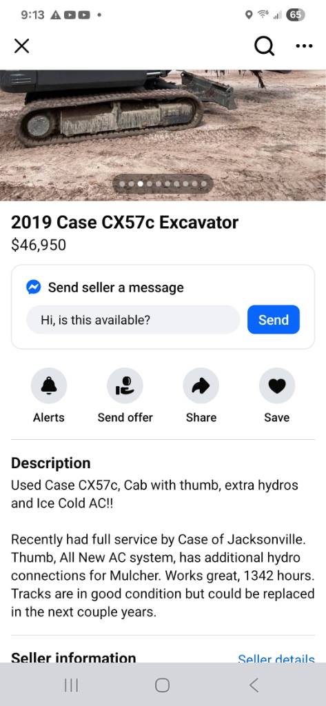

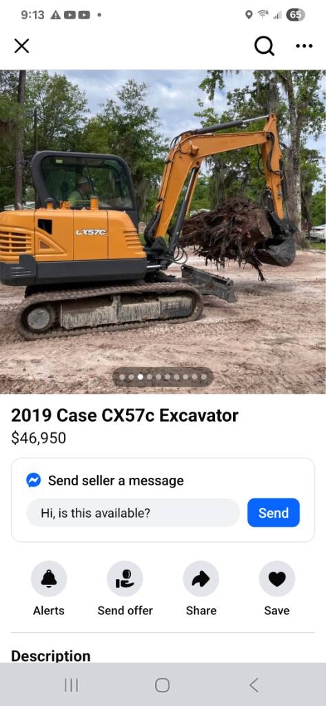

Just saw a Case CX57C, 1300 hours, good condition, 2019, for $47,000. One the flip side; a new Kubota KX080-5, monthly, wac, $2425/month; no idea terms . Another approach is an older Samsung SE130; heavily "loved" but working, tracks missing some rubber pads, ect; $15k. I would expect to put around money into that Samsung to keep it running; and it's probably a work and just park when done kinda machine. Maybe a bit of a mid ground, Takekuchyi TB240 (4.5 ton, ish), open cab, 1020 hours, $38k

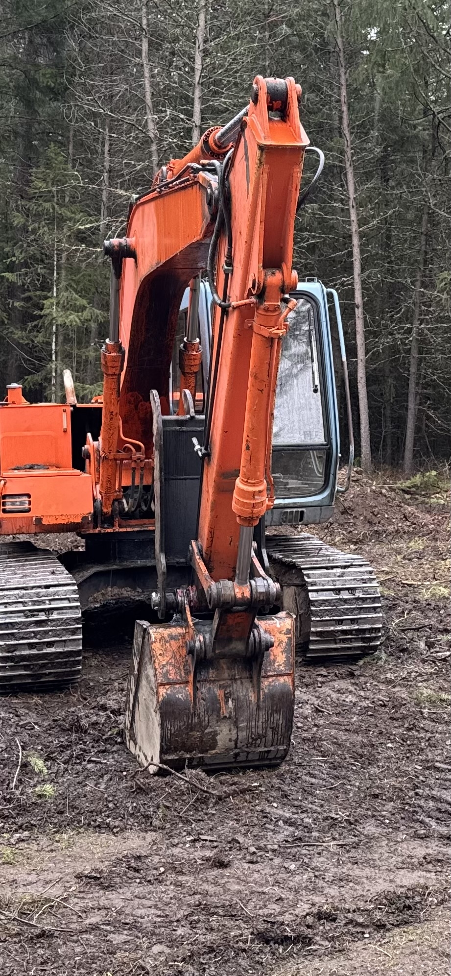

I’m very happy with my grey market hitachi ex100. 3500 hours. Bought for 26.5 K. Had worn bucket pin/bushings that I repaired for under 1K.
Owner was known by a friend and an experienced mechanic had recently gone through the machine.
Using it on 20 acres for land prep to build, removes 30” trunk trees easily. Will lift around 7K pounds. It’s my mistress now, not selling.
